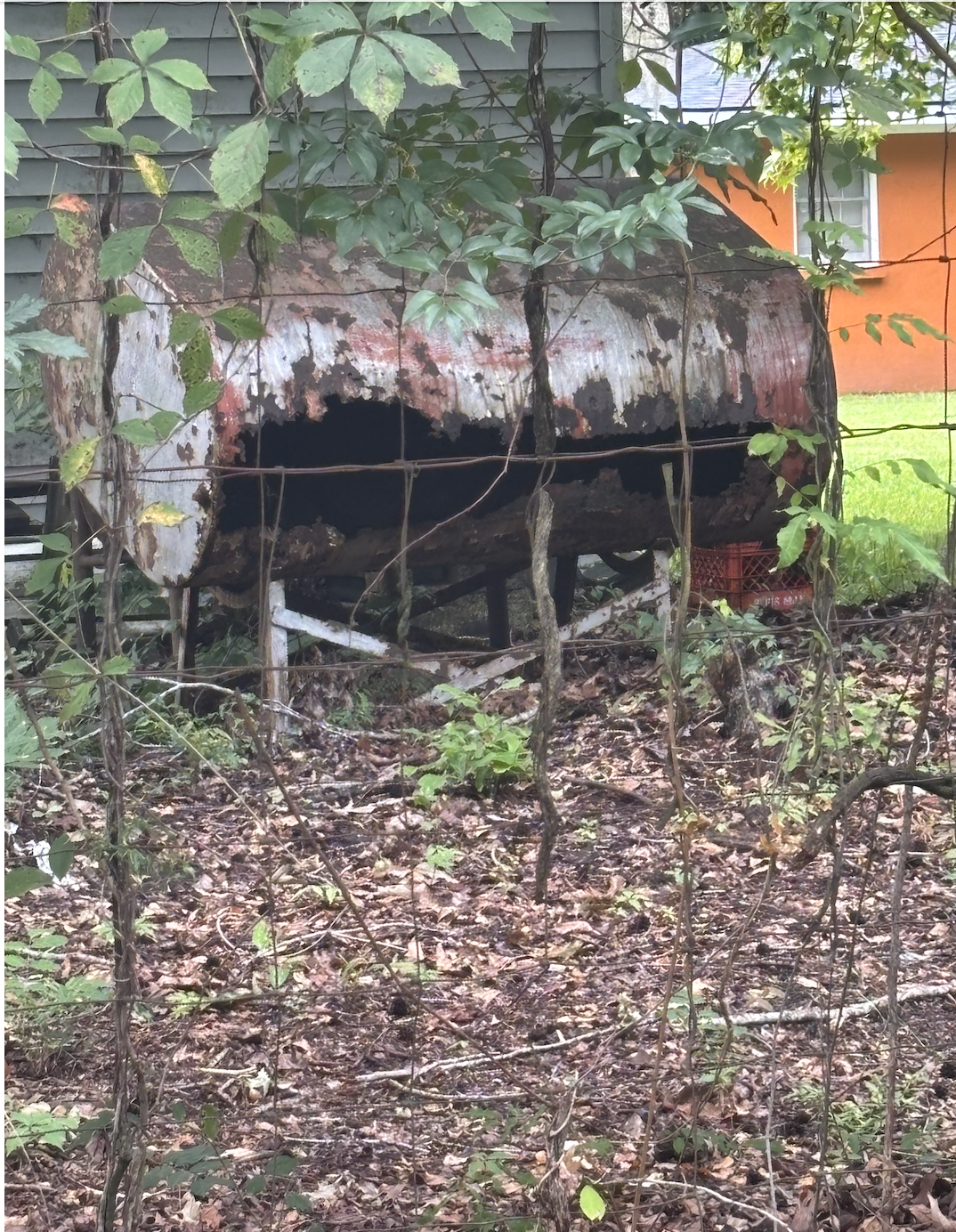

    @AdmiralYoda, This was from his older post:
    "And I can't figure out why the oil company won't deliver to me anymore"
