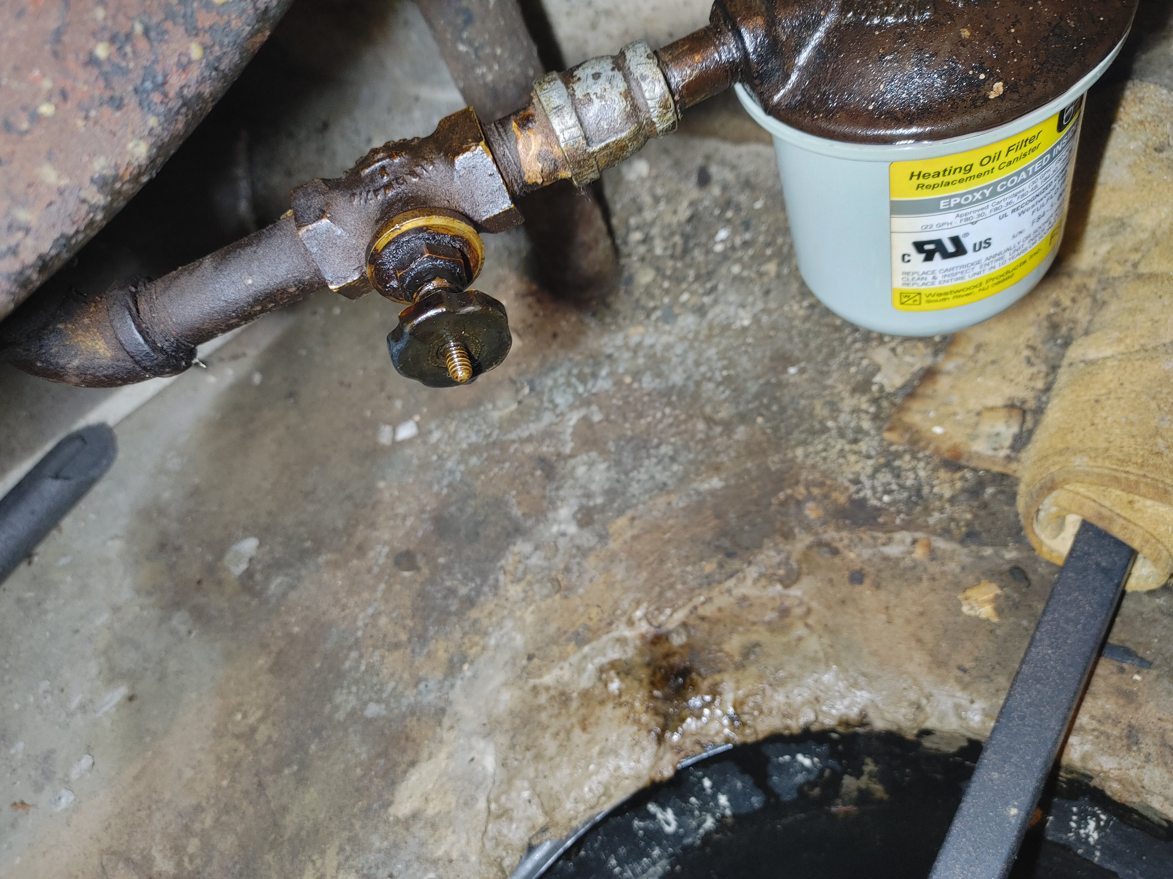

tiny droplet leak from the oil tank firomatic shut off valve.
Ever seen anything like this? What are my options? I put a drip pan for now. Should I run the tank empty and replace it? Or will that create other issues? Is that firomatic valve easily available? Standard size?

    Yes it is a 1/2" firomatic valve . Most residential is 3/8 but 1/2 is common.
    Your going to have to drain the tank. The other way is to use an industrial vacuum cleaner to pull a vacuum on the tank but that has some risks.
    How old is the tank and what is its condition?
    Long Beach Eddxfhczz
  • Tank is old. Rounded shape. Tank is currently at 1/2. Using oil for hot water in summer.
    How does draining work? Is draining the last 1/4 or so a big operation. Siphon into 50 gallon container in the driveway?? Or let it run dry?
    PS: How can you tell 1/2 vs 3/8 just from a photo???
    the 1/2x3/8 reducer is a big clue
    edited July 2025
    Normally you can't but oil filters are always 3/8" pipe in residential and the reducer goes up to 1/2"
    If you measure the 1/2" nipple outside diameter it will be about 7/8"

    First check to make sure that fire-o-matic is fully open , if not the valve will weep. The valve is a double seat valve. Fully open to seal…
    Hope this helps

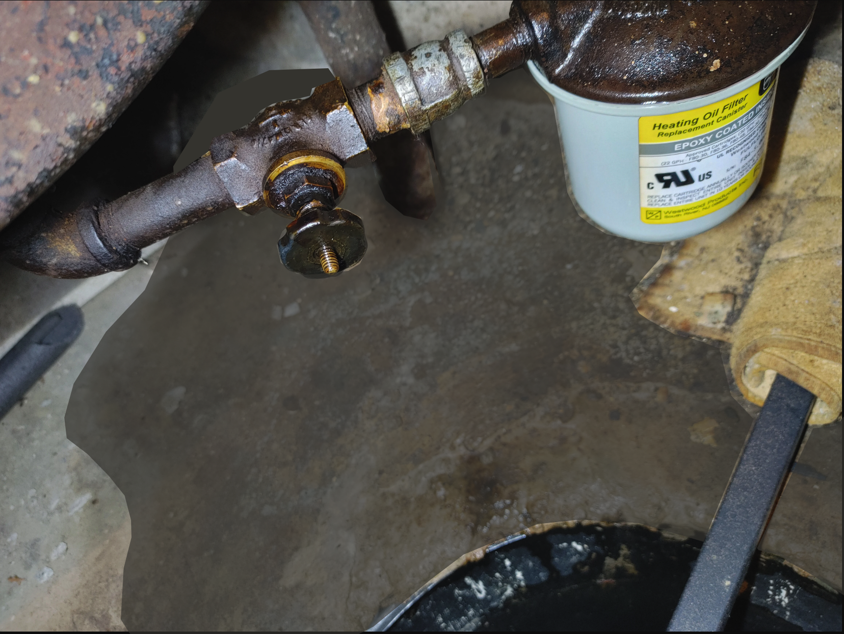

    I don't see any oil stain on the concrete floor just below the valve or the oil filter. This looks pretty normal to me. that coating of shiny fuel glaze on the pipes, fittings, and oil filter seem to be normal from my experience. If there were dripping fuel, that would be a different story. I would expect to see a darker stain on the concrete floor all around that tank leg like this:
    But if you have a constant drip… drip… drip and the only place on the concrete that is showing the oil stain is that small spot, then the black rim must be a sump pump pit that is cemented into the basement floor. If all the dripping oil is ending up in the pit and pumped away to the pump's discharge termination, wherever that is, then you have a real problem.
    If that is the case, you need to solve this sooner than later.

  • I think it's fully open. I turned it CCW and it didn't move.
    But, I did not twist that hard b/c this thing scares me.
  • @EdTheHeaterMan Thanks for your wisdom. There is a small drip that lands on that dark spot. I now have a cookie tin over that spot, held down with a rock for counterbalance.
  • Can this valve be repacked like a steam radiator supply valve? The drip is at the very end of the protruding screw

    Yes. the valve can be replaced with the same size. FIROMATIC 12830
    Or you can purchase a tank valve that will accommodate the 1/2" tank opening and the 3/8" oil filter. FOROMATIC 12640
    @CoachBoilermaker
    A few drips of oil are not dangerous. Its something that should be fixed and not be ignored but I wouldn't panic about it. I would run the tank low and have it fixed. If the tank is old it may be time to change it.
