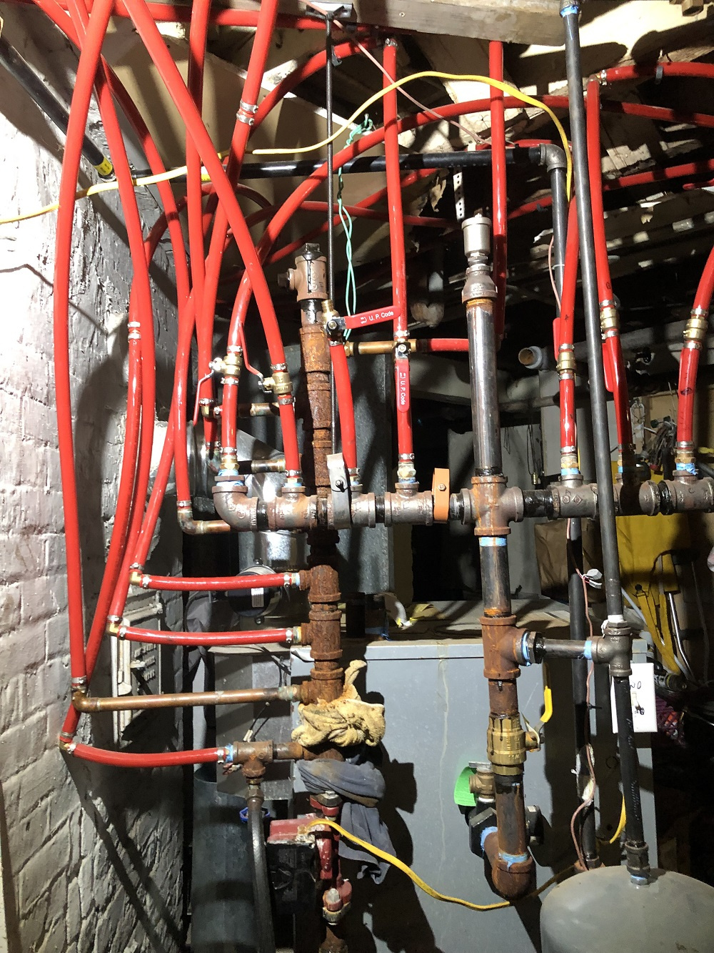

    I will get some more pics tomorrow but here is the feed manifold,as you can see the return main stack leaks , I believe it is 180,000 btu, all apartments have single pane windows so a lot of heat loss…the apartment building is over 100 years old and I have been redoing plumbing and electrical work in the building for a while but did not do any work on the boiler ….

    It is very sloppy but should work if they did their math right…

    hot_rod Member Posts: 27,904
    piped like your drawing you will need some balance valves. Even a ball valve on each group would help balance the various loops

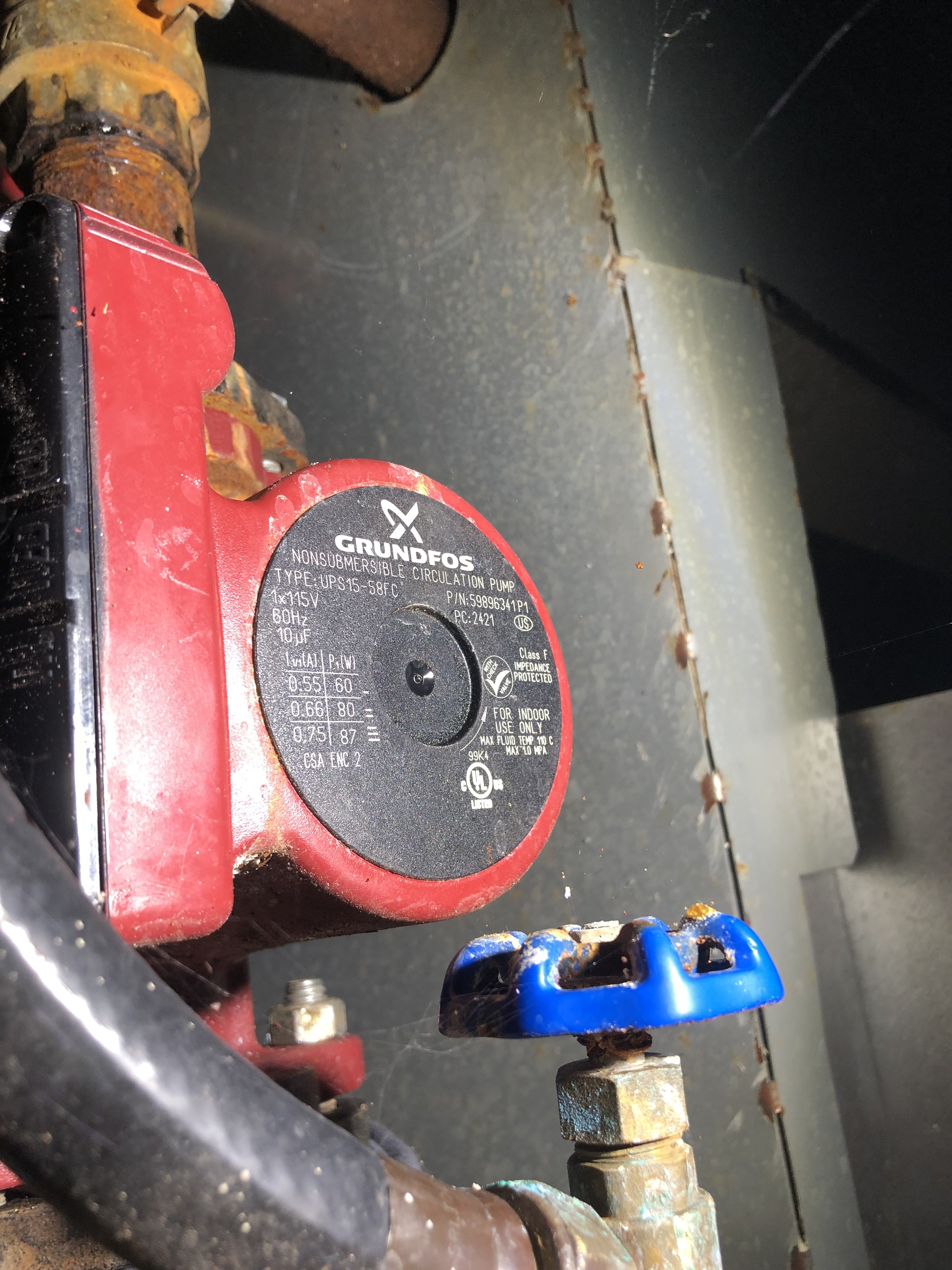

    the circulator pump in the less than 3 years was replaced twice …set on high from what I remember but will check…

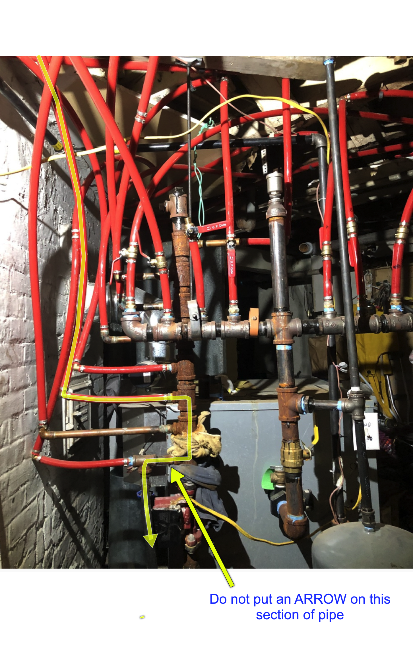

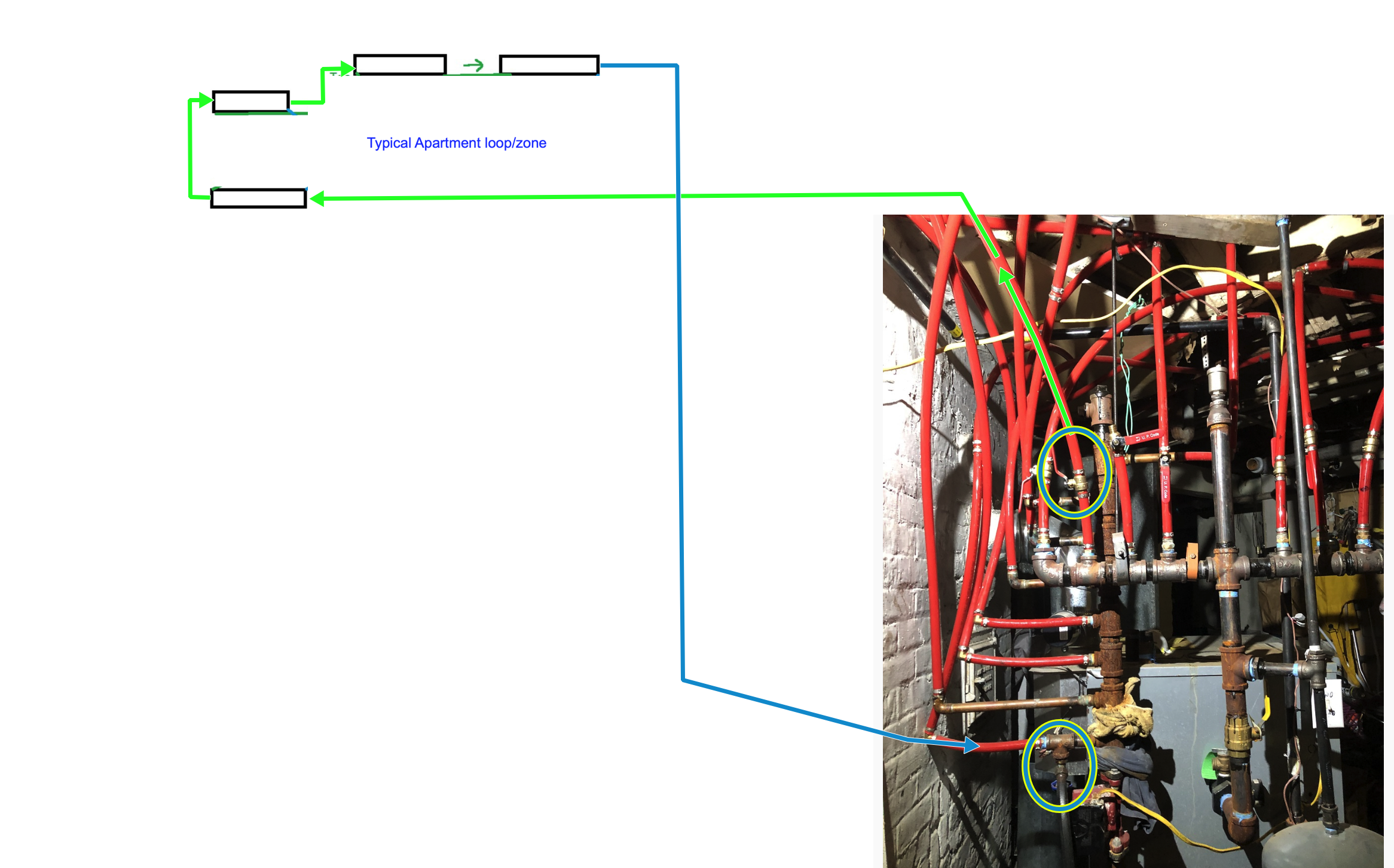

    EdTheHeaterMan Member Posts: 12,544
    So looking at this mess of PEX it appears that there are 9 different zones (I know this is a one zone system but I'm talking each apartments as a zone). and your drawing shows that any zone may have additional tee fittings in the zone.
    This will make for air problems and adding a valve to every return will not resolve the air problems if the above diagram I have shown represents your system.
    There needs to be an air vent on each loop in order to get the air out. Or you must provide a ball valve on each tee inside the apartment zone to purge those individual loops.
    If however each apartment is a series loop with no tee fittings inside the apartments then the existing supply ball valves can be used to isolate each zone in order top purge the loop.
    By closing all the supply valves (Green Oval) and opening only one supply ball valve, the water can only go thru the one path. (with no tee fittings) and end up at the return with all the air purging in that loop. Then it will exit the one boiler drain valve just before the circulator pump (Green Oval)
    And as long as you don't put a water flow direction arrow on this one section of pipe then all the other loops can use the same boiler drain for purging.
