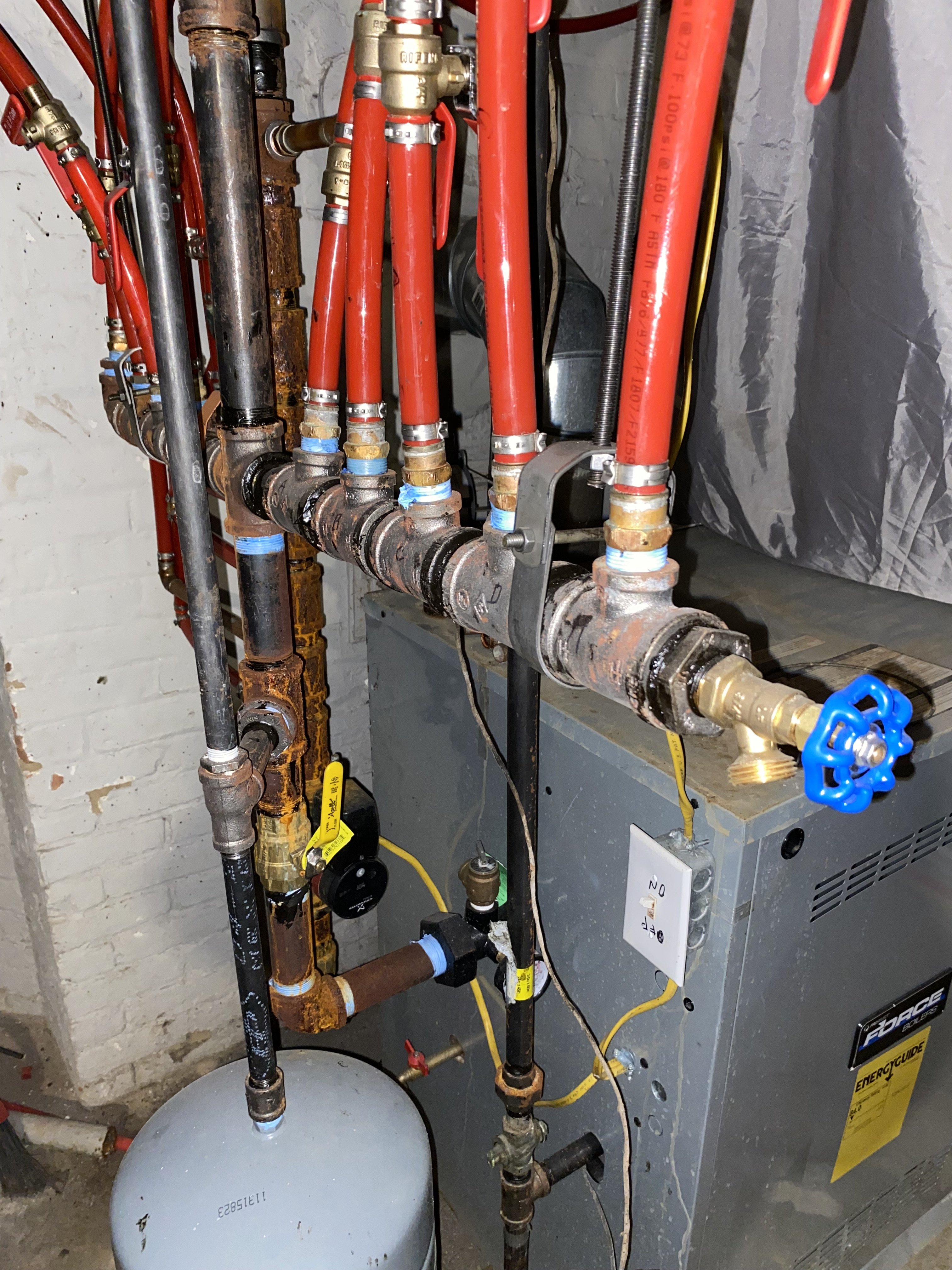

    valentino Member Posts: 33
    I will get some more pics tomorrow but here is the feed manifold,as you can see the return main stack leaks , I believe it is 180,000 btu, all apartments have single pane windows so a lot of heat loss…the apartment building is over 100 years old and I have been redoing plumbing and electrical work in the building for a while but did not do any work on the boiler ….

    mattmia2SuperTech
    mattmia2 Member Posts: 17,906
    It is very sloppy but should work if they did their math right…

    you need about 18 gpm to move 180,000 btu/hr, assuming that is the output, so your header needs to be a minimum of 1.5" to move that much water to move that much heat. If that is the input you need about 14 gpm and could use 1.25" pipe for the headers.
    hot_rod Member Posts: 28,078
    piped like your drawing you will need some balance valves. Even a ball valve on each group would help balance the various loops

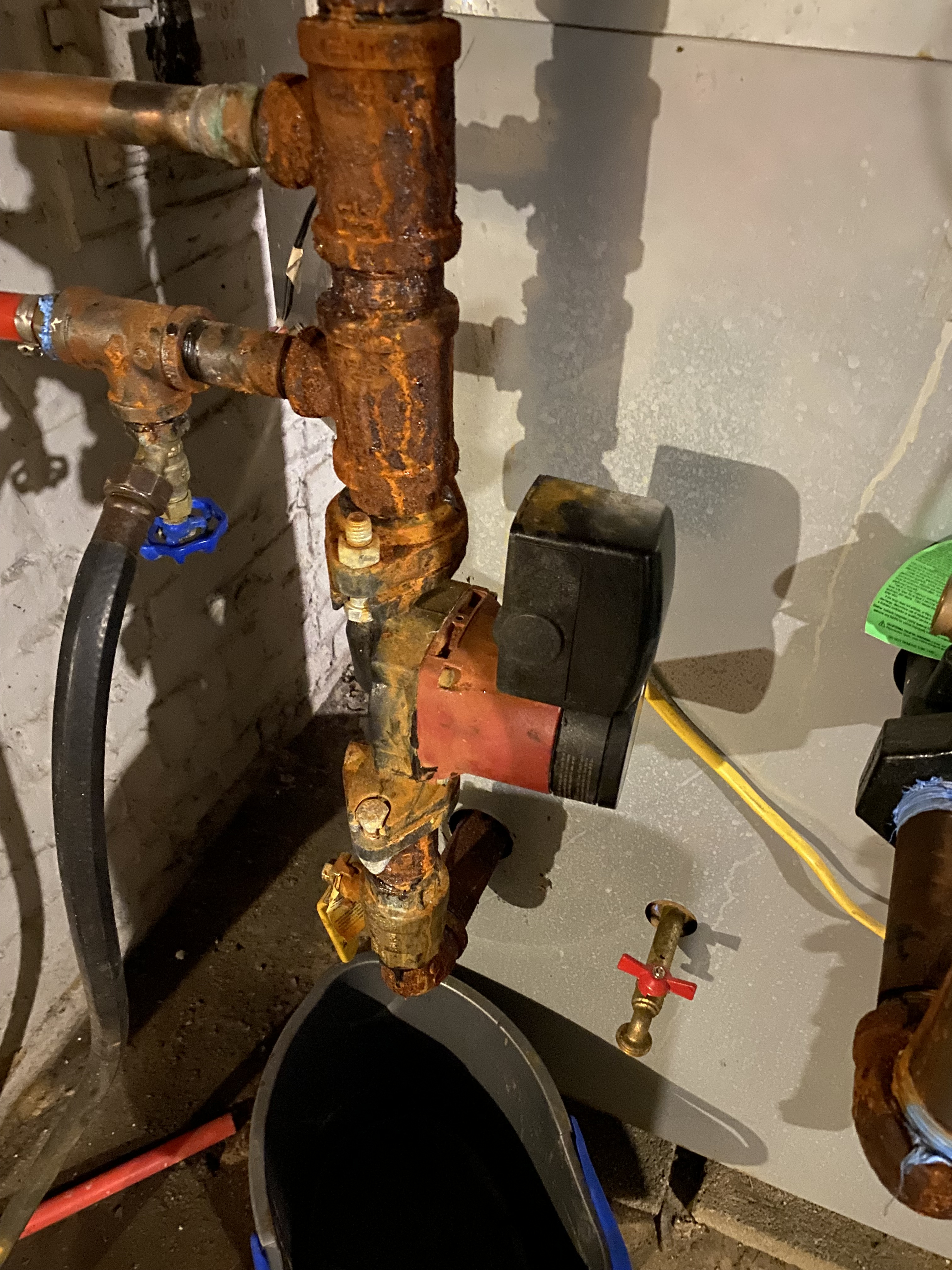

  • valentino
    edited August 2025
    the circulator pump in the less than 3 years was replaced twice …set on high from what I remember but will check…
    Grundfos UPS15-58FC 1/25 HP IMG_2340.JPG

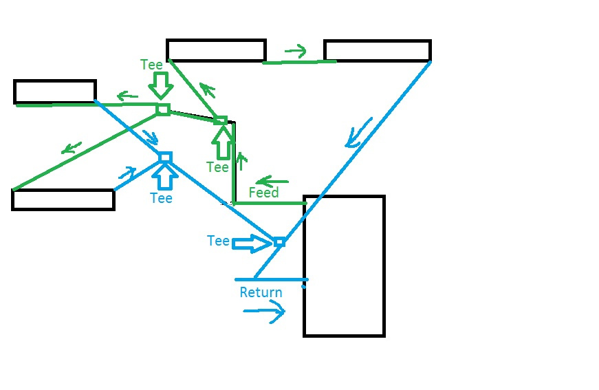

    So looking at this mess of PEX it appears that there are 9 different zones (I know this is a one zone system but I'm talking each apartments as a zone). and your drawing shows that any zone may have additional tee fittings in the zone.
    This will make for air problems and adding a valve to every return will not resolve the air problems if the above diagram I have shown represents your system.
    There needs to be an air vent on each loop in order to get the air out. Or you must provide a ball valve on each tee inside the apartment zone to purge those individual loops.
    If however each apartment is a series loop with no tee fittings inside the apartments then the existing supply ball valves can be used to isolate each zone in order top purge the loop.
    By closing all the supply valves (Green Oval) and opening only one supply ball valve, the water can only go thru the one path. (with no tee fittings) and end up at the return with all the air purging in that loop. Then it will exit the one boiler drain valve just before the circulator pump (Green Oval)
    And as long as you don't put a water flow direction arrow on this one section of pipe then all the other loops can use the same boiler drain for purging.
  • valentino
    Thank you for the responses and Ed for the detailed drawing and explanation.So you are correct that this system is not a complete series loop type system but instead uses multiple tees as my drawing kinda reflects. It of course is much more spread out through out the basement and apartment building.
    I thought of the idea of putting a shutoff valve at each tee to help isolate but that would be extremely time consuming in this maze of pex. Some of the feeds/returns are boxed in or in drop in ceilings of each apartment.
    To resolve the return stack manifold leaks my idea was to use a manifold like in the picture instead of multiple 1 1/4 black pipe fittings. They all pretty much leak so since I would be redoing the return was why putting the shutoff/purge on each return line was an idea. My thought was as in your yellow arrow drawings return path, it may not completely allow all the air to escape properly traveling that path. Of course why complicate things if the one purge valve will work then I will keep it that way when redoing it.
    So it seems putting an air vent on each loop will be the easier method….
