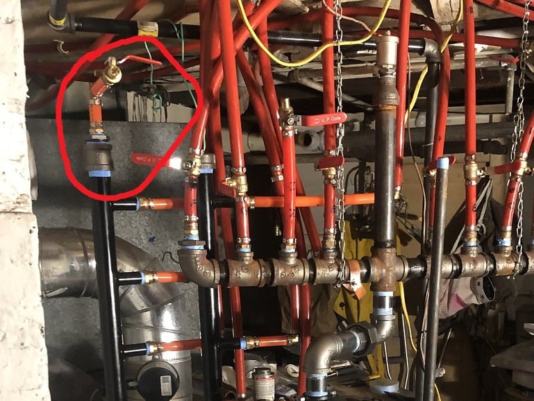

using pex tees in hydronic hot water heat system
Hello, I was in a 9 unit apartment building basement that had some hot water feed and returns using multiple tees in the system. Most apartments complain that some baseboards don't get hot at all. The returns are all individually piped into one manifold but no individual shutoffs or purge valves on each line. The one main shutoff is after the manifold before entering into the furnace. The one circulator is on the return line.
The 9 feed lines come out of one main feed manifold and each line has a shutoff.
The question I have is the use of so many tees in the feed and returns in the loop system. Is this a good practice? I have enclosed a quick drawing of how one apartment is set up…keep in mind that the feed, baseboards and return lines are much more spread out than the picture shows. It is just for a rough idea how this whole system is set up.

    You may benefit from piping the emmitters using reverse return. Also, we usually connect tees in a 2 pipe system with the branch connections horizontal.
  • I will get some more pics tomorrow but here is the feed manifold,as you can see the return main stack leaks , I believe it is 180,000 btu, all apartments have single pane windows so a lot of heat loss…the apartment building is over 100 years old and I have been redoing plumbing and electrical work in the building for a while but did not do any work on the boiler ….

    It is very sloppy but should work if they did their math right…
  • yes the math is most important, without using a complicated heat loss calculation the 9 unit is about 8,600 sq feet and the boiler is 180,000 btu …the large windows are old and single pane so that alone is a huge factor …the 3rd floor has one apartment with no heat in it yet and they want to see if it can be added to the same boiler. I told them that is way too much already on the boiler…
    you don't know that if you haven't done a heat loss calculation. the loss is only on the outside. is the 180,000 btu/hr input or output? Even the best windows are a bit worse than the worst solid wall so windows are more about how much area they are and how good the weatherstripping is. a modern house with a wall of glass of the best windows is going to be far more lossy than an old house with 100 year old windows without storms if they are in decent shape.

    piped like your drawing you will need some balance valves. Even a ball valve on each group would help balance the various loops
    Did it ever work adequately?
  • @hot_rod- yeah I was thinking of that idea…no it has always had problems and is only 3 years old. I have more pictures coming later today but here is the return stack…it leaks a lot so I plan to redo it. As you may be able to see they put a purge valve on the last return line.

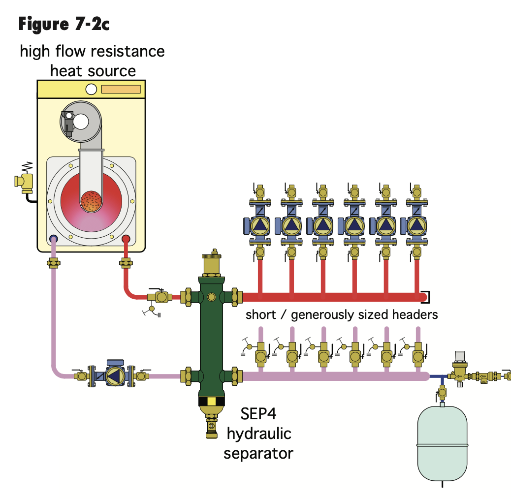

    I had just taken a one day seminar hosted by @DanHolohan , the creator of HeatingHelp.com, and told my installer to put the new micro bubble air separator on the supply pipe and the new diaphragm expansion tank and water feed piping connected to the bottom of the air separator. Then install the circulator pump after the air separator just as I have it in the diagram I provided you.
    My installer thought I was crazy for suggesting that design but he followed my instructions.
    8 hours later the job was ready to be filled with water and to the surprise of that installer, the system was much easier to purge the air from the system, and after the boiler fired up and circulated the hot water thru the system, all the other problem sections of the system that caused years of air problems were air free within 15 minutes. To this day, almost 30 years later, that system has never had an issue with air. Let the science work for you (Boyles Law) not against you.
    Not every system is easy to adapt the "Pumping Away" design to. When the zone manifolds and pipes are too close to the boiler, and you don't want to repipe a complete new manifold from scratch, then you need to work within the confines of what is there.

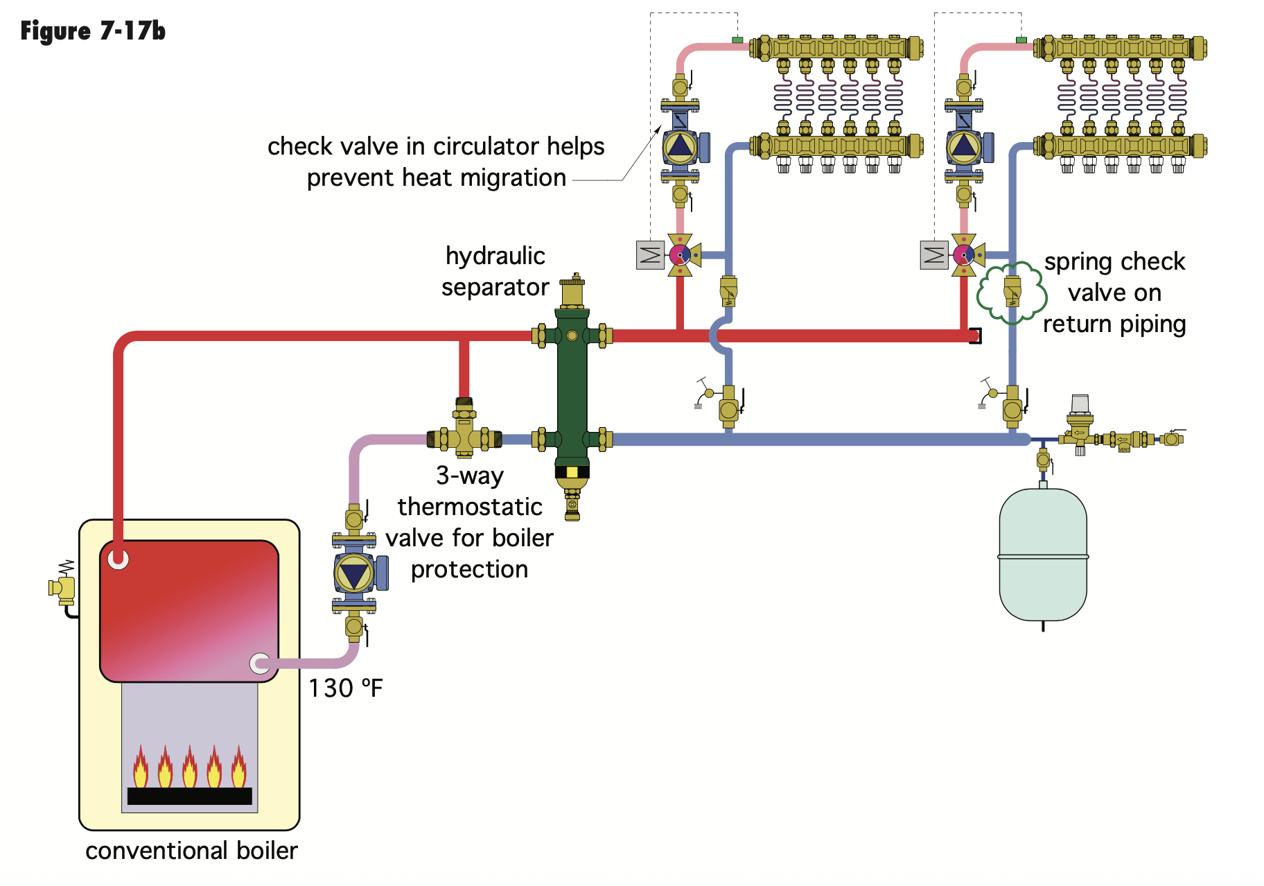

    https://heatinghelp.com/systems-help-center/pumping-away-piping/
    My question is do I need a flow control valve since the circulator has a check valve already in it?
    If someone thinks the circulator goes on the return they haven't learned anything in decades.
    A flow check and flow control valve are the same thing. You don't need 2 in the same pipe.

    hot_rod Posts: 28,706
    There are some exceptions. Some high pressure drop mod con boilers prefer the pump on the return to add the delta P to the hx to overcome pressure drop, eliminate potential flashing.
    Also with a cast boiler the pump can be on the return IF the expansion tank is placed upstream. So you really need to see a drawing or installation to gather all the data.
    It is not so much about where the pump is located on a hydronic system, BIUT where the expansion tank connection is in relationship to the pump(s). Pumping Away
    Plenty examples of pumped returns in various Idronic issues.

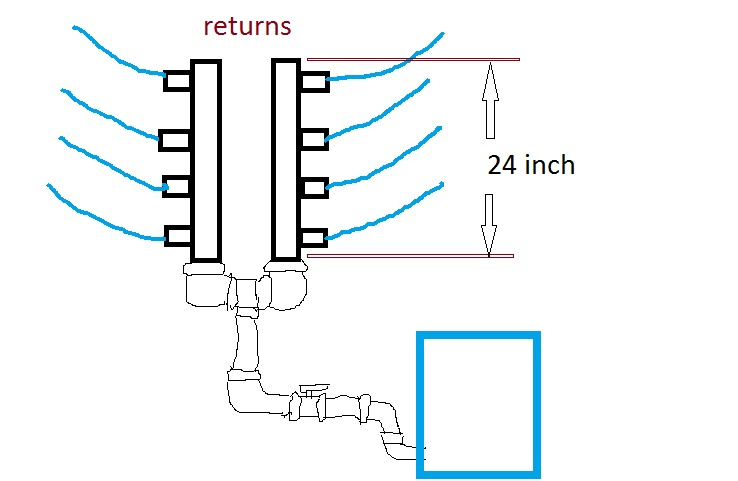

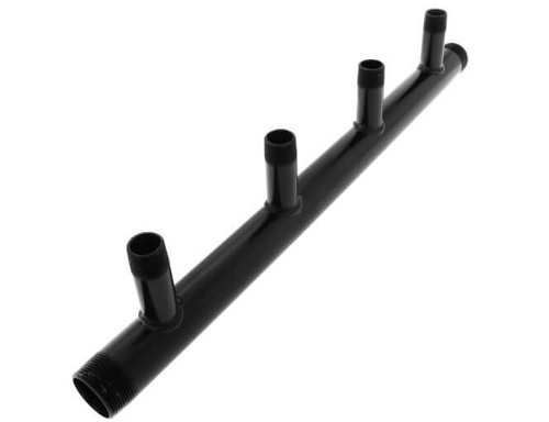

  • just update the manifolds arrived today , they are 24in long each and have 4 branches each 6in apart. The 9th apartment will have new copper fin baseboard next week once I finish the re-pipe of the boiler. So I posted a picture of my proposed layout of the return. It is all 1 1/4 black pipe , was planning all copper since I found a manifold with 10 branches that each branch was only about 4in apart but then would have to do the whole return in copper so went with the black pipe.
    The 9th apartment I will have to add a Tee to the top of one manifold, would this setup be ok with one side having 5 return lines?
    If I put both manifolds on top of each other it of course ends up over 4 ft vertical…

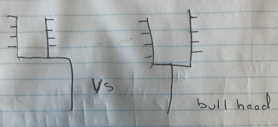

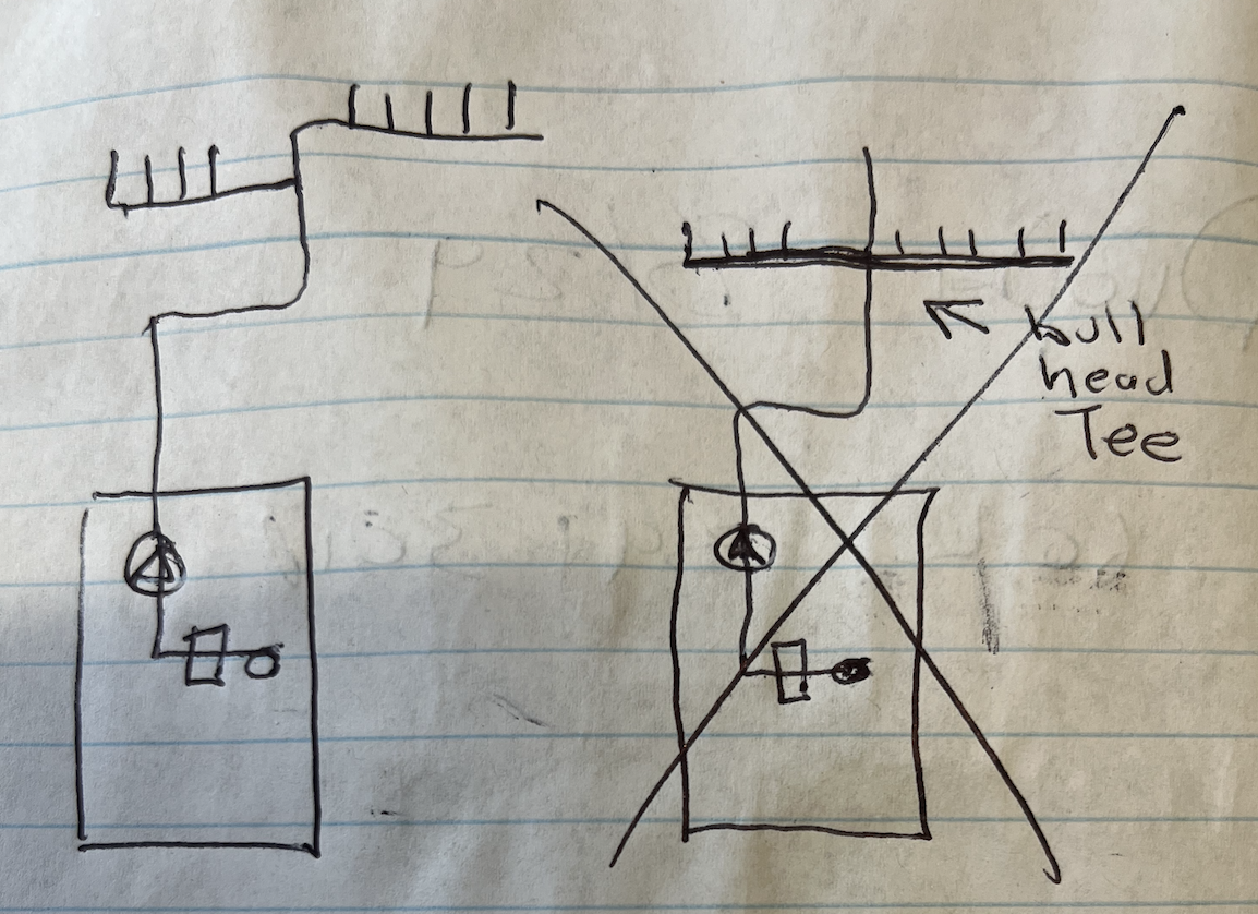

    A sutle piping change suggestion to avoid a "bull head" tee connection. Flow through a bull head tee doesn't always split evenly. The use of a bull head tee arrangement was banned in code books for years, it may have been deleted.
    It is not an issue in plumbing where you have plenty of pressure, but in hydronics they can cause flow misbalance. Easy enough to avoid.

    yes that makes sense to me and I can see why it could possible cause an issue…it is frowned upon in plumbing too …thanks!
  • hot_rod, I was thinking and just so I am more clear…I thought a bull head tee was a larger branch than the two runs? Either way the flow is better in the drawing you sent and how I plan to pipe it.
    I cut everything out yesterday except the feed manifold is still intact with all the feed lines. Since just the feed manifold is the only thing left is there any benefit to redoing the feed/supply manifold too?
  • answered my question after seeing an oldert post on bull head tee on heatinghelp :)

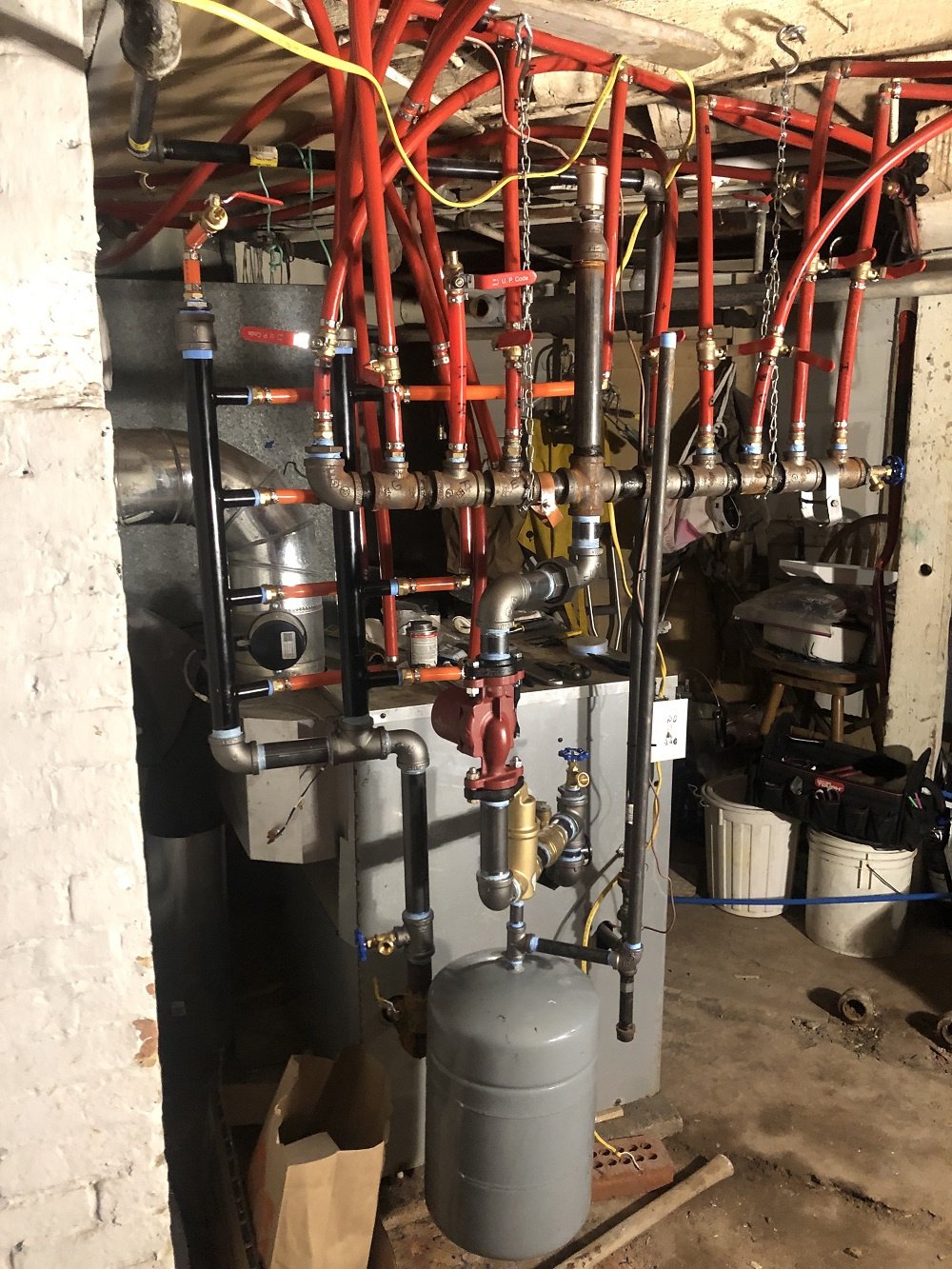

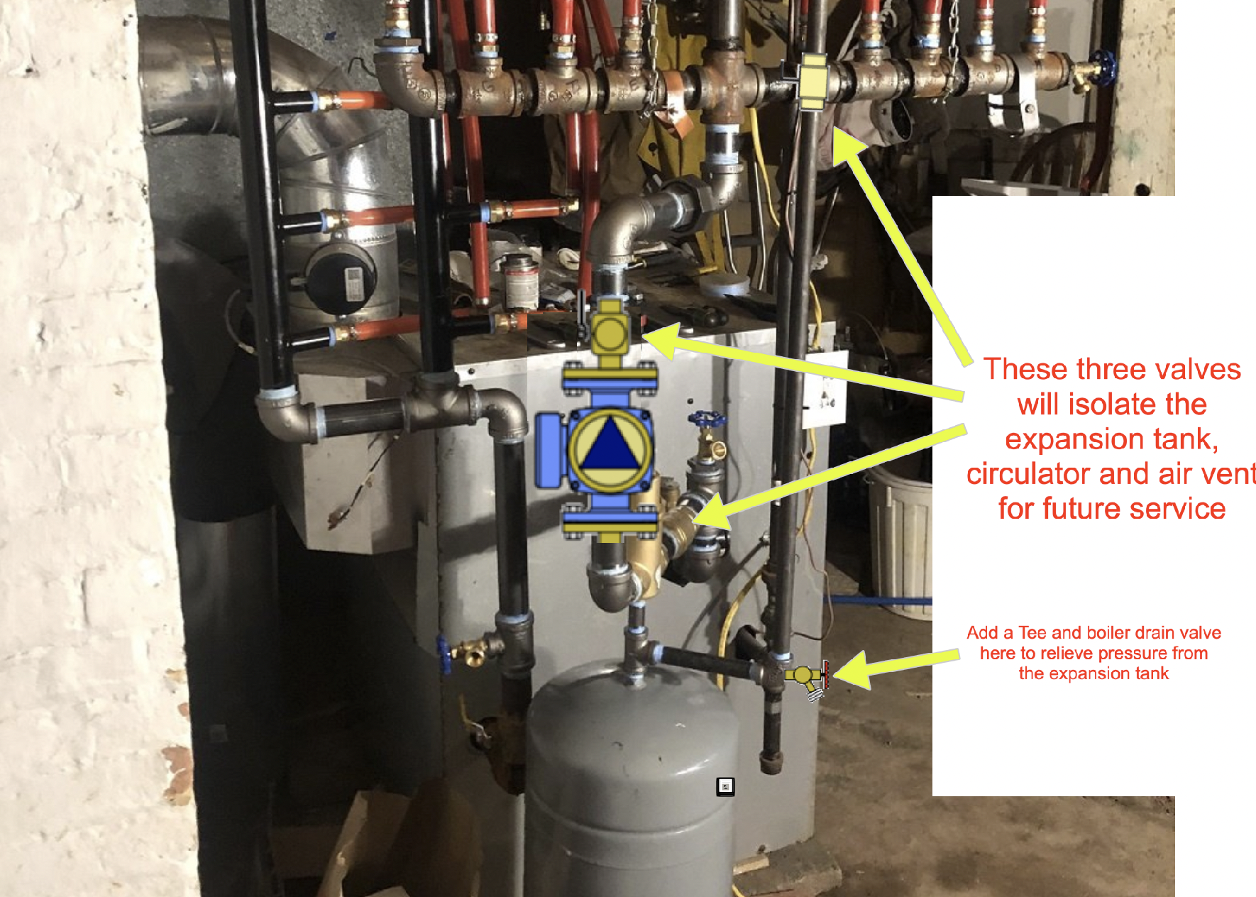

    update picture, any critiques are welcomed …I had a circulator flange with shut off valve but just no room for it…I had to cut all the supply lines and raise the manifold already so adding the flange with shut off added even more height.
    the circulator I originally had the motor facing out but the electrical box was on opposite side of the wire, may still need to add a long wire to make it neat but will decide on that …perhaps just switch it back to motor facing out
    I would have piped it so the supply manifold was further left to the wall but then it would block the return lines even more…should have just redid the supply manifold too it would of taken up less room and look much better..
    was going to use 45's instead 90's but that also added a little more height..hopefully don't loose too much pressure with the 90's
    I think permatex RTV silicone it was used on the pipe threads, pipes didn't want to come apart
    Piping work looks nice!
    If anything I would have repiped the supply to get rid of the bull head tee.
    Pipe the supply like you did the return, two tees splitting the flow.
    With that good air purger, that high vent on the riser could have been eliminated.
    A vertical air sep would have saved a few ells, no big deal on pressure drop with those ells.
    Isolation valve on the expansion tank is helpful for service and checks. You do have the main ball valve and all the branch ball valves to isolate the tank, with minimal water loss.
    Are the loop hangers replacing the dog leash chain? Or vice verse?
    On to the wiring clean up ? :) The Romex isn't safe or legal used like that.

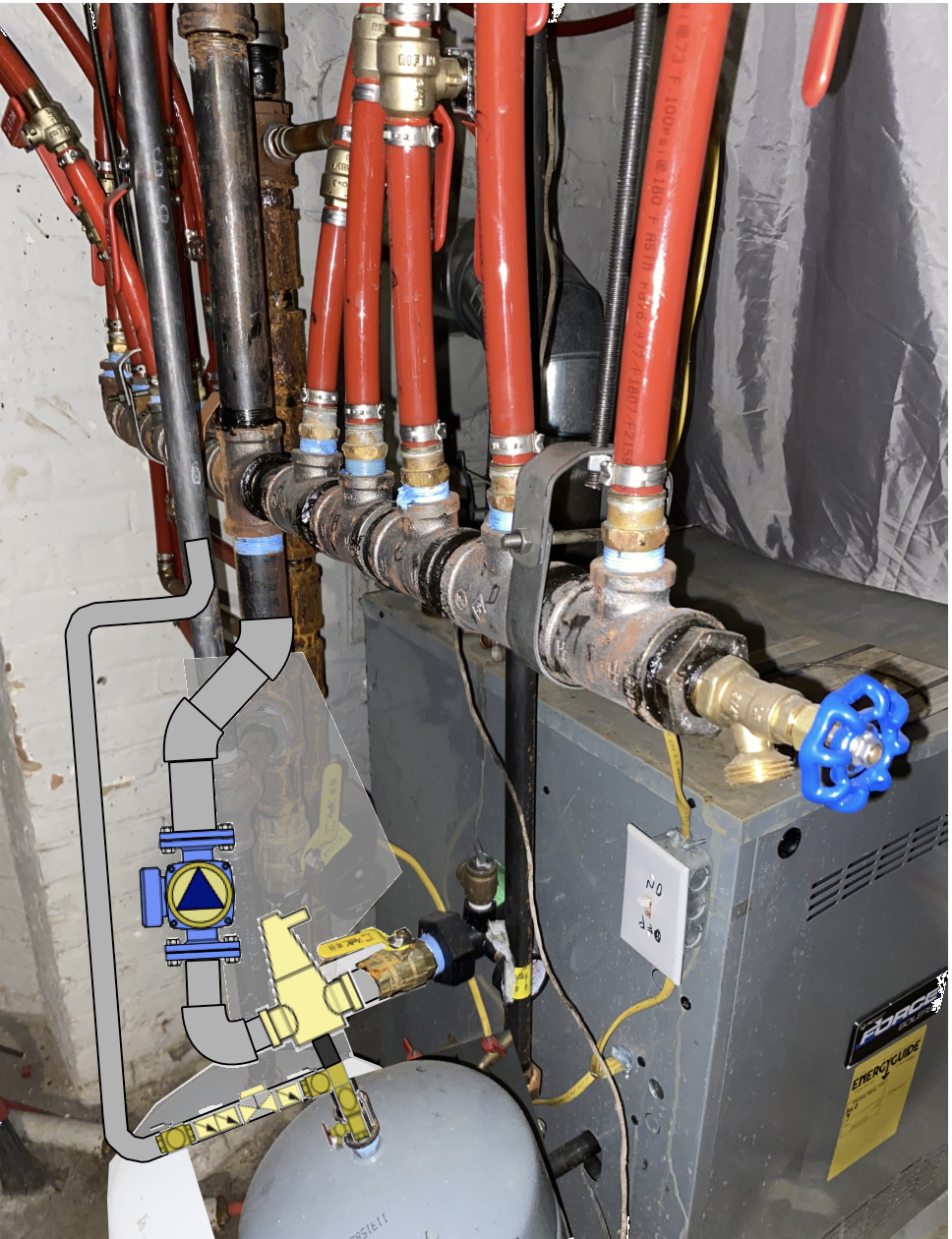

    Looks line you are not finished piping the water feed. if you have one valved flange, it looks like you can fit one in there by using a shorter nipple on the inlet side of the pump.
    By shutting off three valves, you can isolate the major parts when service is required, without draining the entire system.

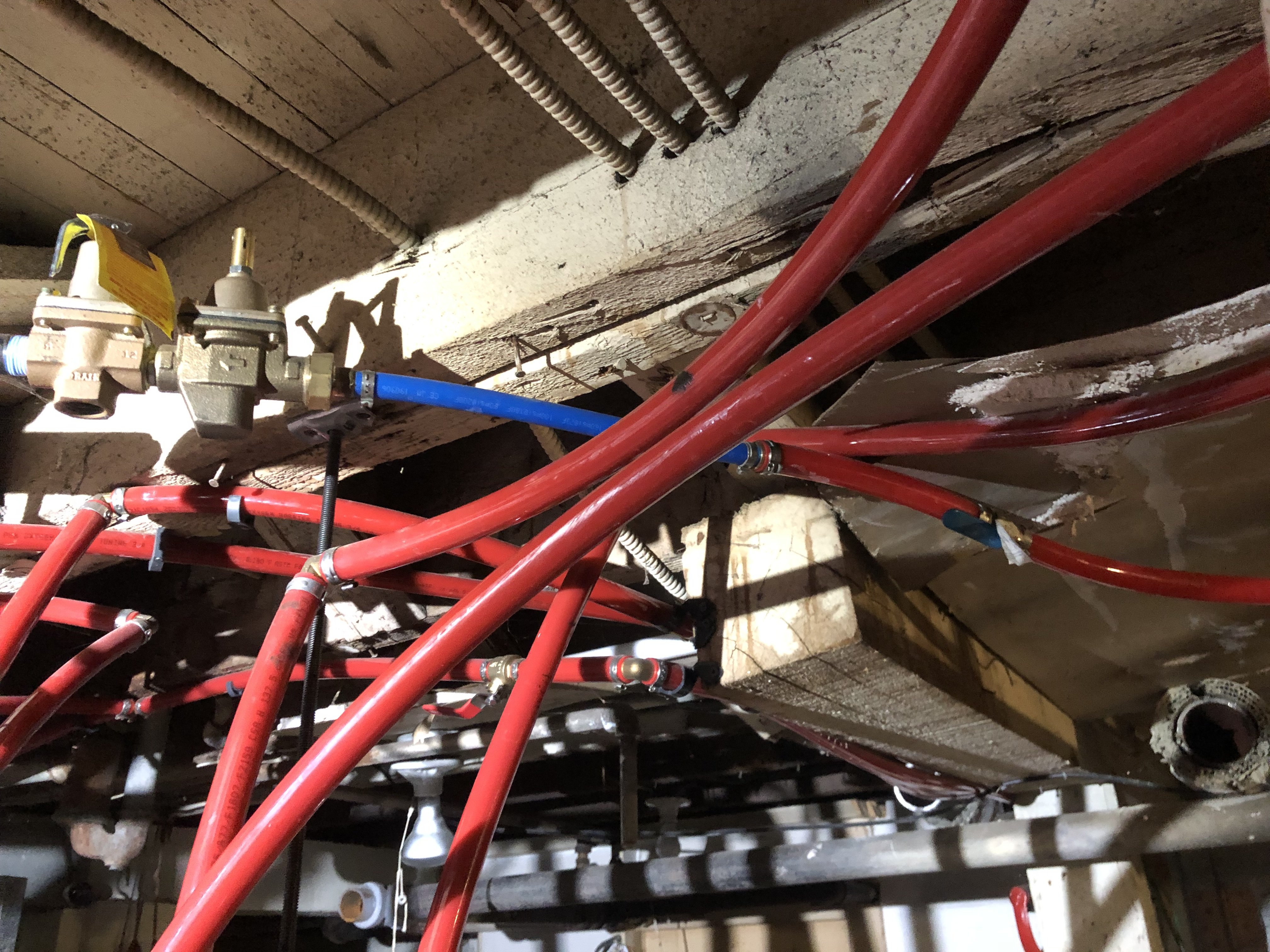

  • so I wanted to update the progress on the boiler, after purging and firing up the boiler I noticed the top returns on both side not getting too hot so opened the ball valve on the left top return and let the air out. It worked right away and when I was piping it was thinking air vents on the top of each vertical return manifold may be beneficial. My concern was perhaps with air vents some new air could also be introduced in the system. The left top ball valve is for a new apartment that has no baseboard yet …So would it be advantages to add in the vents?
    The system worked fine after removing the air.
    I also put ball valves on each side of the return and supply tees that I had to put in the one apartment when adding three rooms of baseboard to what was already there. (the three rooms had none)
    The rooms I did are a complete loop.
    The owners don't want the boiler on until Oct. This gives me time to go back since I also found several apartments had some copperfin baseboard orientated the wrong way so will have to re sweat them too…
