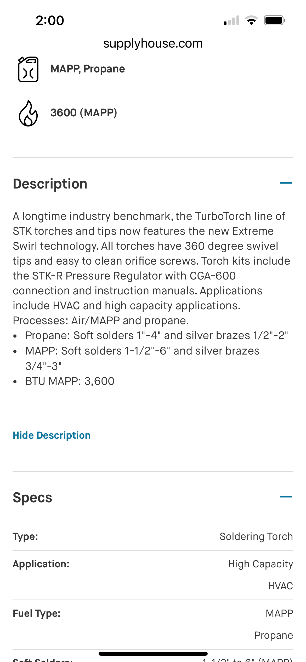

  • seized123
    seized123 Member Posts: 485
    Thinking of getting this for soldering/unsoldering the 1-1/2”. (Possible it could be too hot?)
    mattmia2 Member Posts: 17,571
    That male adapter doesn't have a lot of mass, it shouldn't be hard to get it hot enough with like a ts8000 if you take the black fitting off. It is if you ovalize and seize it that might be more of a problem.(I am not an expert on desoldering, i have seized stuff up trying to desolder it and didn't quite know why.)
    If it isn't coming off, I'd file the 2 sides until you file through the copper to the solder and heat it up and peel it off. Be careful not to heat it so much that you start bending the pipe.
    If it is free just the weight of the iron pipe pieces will pull it off or pull it off if you wiggle it a little.
    I'd wrap the bottom branch of the tee in a wet rag, doesn't have to be super wet, to keep the solder in the tee from melting.
    cherry red is way too hot, if you heat it that much it is likely to start seizing together and you will have to cut and peel. cherry is around 1000f, solder melts at about 350f to 500f depending on the alloy.
