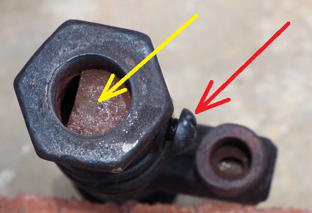

    Update: I put the Breck in 5% acetic acid (vinegar) for 3 days. It de-rusted very nicely. Lots of debris "boiled" out. I re-attempted heating it to see if it would close, but it did not. I also was unable do any further disassembly, nor see how it could be done. (I wonder if the insides were slipped in while the tube was still hot? Heat fit.)
    mattmia2 Member Posts: 16,010
    when iron rusts the scale is bigger than the original metal, even if you get rid of the rust it likely will be bigger than it started out. it also may have additional parts that screw in through the side ports, possibly with some sort of spanner that are holding the internal parts in. they may not have known enough about what would happen after a few years of use or they did know but didn't know how to fix it. This was one of the first steam air vents.

    Was the screw removed (Red arrow) ? It would not surprise me if the screw pushed the "D" shaped inner assembly (Yellow arrow) against the other side of the housing.

    @109A_5, I removed the screw before de-rusting. I imagined, as you, that the screw held the guts in place. However, de-rusting hasn't loosened things up… yet. Haven't knocked it around much, yet. Also, should check it is fully de-rusted—-another vinegar bath.
    I have not found patent numbers or markings of any kind…. Maybe I need to get my eyes checked…

    I gave the Breck another vinegar bath. It was quite clean. I then heated it up to see if it would close. But, no such luck; air came out the bottom. I also still don't see a way to disassemble it further. I'll poke around some more.
    I'd probably try something like evaporust. Or heating it to near cherry. Might be worth asking someone that does historic preservation.
    I think that screw with the square head needs to be screwed in for it to close, it probably closes at room temp if it is in far enough.
    109A_5 Member Posts: 3,690
    That screw inside may need proper adjustment for the valve to close properly with heat. Which is why they made it so it could be fine tuned. Also it may not work correctly if the pressure is on the wrong side, since it may be made to let the air in easily. The pressure differential may need to be correct too, higher pressure on the steam side.

    I originally used a torch, but only to achieve the equivalent of boiling temperature. Yesterday I tried boiling in water to be more precise. I set the adjustment screw to just a little open. It still did not close on heat.
    If I turn the adjustment screw all the way in (i.e., at room temperature), it does close. So, the unit still has the ability to close, but not automatically upon heat.
    As to original assembly, I wonder if the guts were set into the tube by shrink-fit?
    The heat and allow to shrink is very unlikely, the type of precision needed for that wasn't common until around wwi or so. it is much more likely that either something unscrews from one of the ports on the side or the corrosion has pitted and raised the surfaces such that they no longer clear each other.
    It is very possible whatever held the bimetal element in place has rusted away or the element itself cracked.
