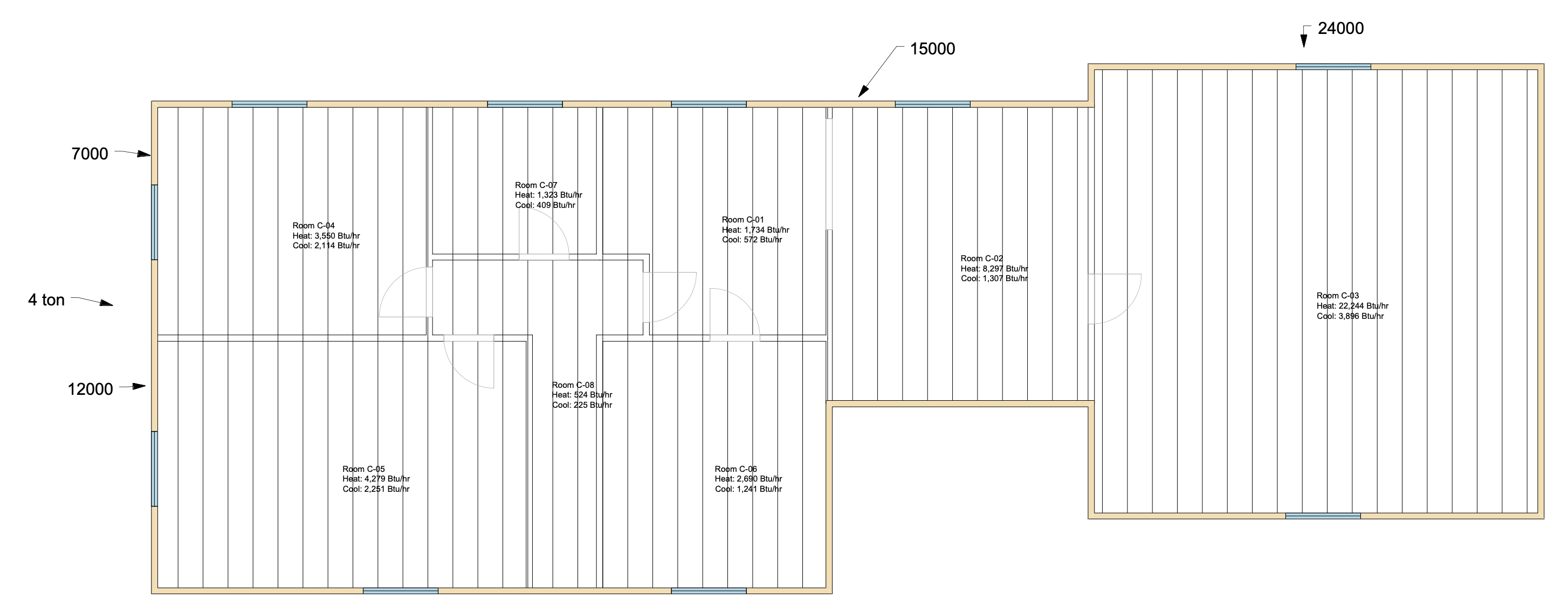

    So here's a question - here's a sketch of the house upstairs
    There are two thermostats that control the hot water baseboard are located in room C-05 just inside its door (controlling C-05, C-04, C-07 and C-06) and in room C-02 on the wall btw C-03 (controlling C-01, C-02 and C-03).
    Rooms C-02 and C-03 represent an addition to the main house (C-01, C-04 → C-07). What's confusing is why C-01 is on the same baseboard zone as the addition. Must have been changed at some time and for whatever reason, C-06 wasn't changed as well.
    In any case, this is just a background - the following is one option that we have been proposed
    • Indoor units are installed in C-04 and C-05, I am told that they will be controlled by the single thermostat in C-05 (integrated controls)
    • Indoor units are installed in C-01/C-02 and C-03, controlled by the single thermostat btw C-02/03
    I'm trying to determine if C-06 being heated by baseboard via the C-05 thermostat, yet when using heat pumps, it'll be indirectly heated from C-01 via the C-02/03 thermostat.
    Basically, it exists in two different heating zones, depending on baseboard vs heat pump.
    It is what it is but what's the significance of it, if any?

    pecmsg Member Posts: 6,346
    I see less then 1-Ton cooling total. Not going to work.

    C03 can have it's own two ton head.
    I'd be looking at something like this: https://ashp.neep.org/#!/product/34583/7/25000/95/7500/0///0
    Your total heating load for all the rooms except for C03 is 22,397 BTU/hr, that unit produces 25,600 BTU/hr at -13F. It also modulates as low as 14,600 Btu/hr on cooling which is still more than your load but not terrible.
    It's a compact ducted unit. The air handler is only 9-7/8" high. I think your best bet is to drop the ceiling in room C08 by a foot, put the air handler in the drop ceiling and run duct work to all of the adjoining rooms. For C02 you're going to have to put a soffit in either C01 or C06. I think that's going to give you the best comfort and probably cost about the same as three heads.
    If you tell me your county, what you pay for electricity, what fuel you'd use for the baseboards and what you pay for it I can run some numbers on the economics of all-electric vs using a backup boiler.

    I should have mentioned that "room" C-08 is actually the stairway from the ground floor (the base of the 'T') and the hallway for the upstairs (the top of the 'T'). So I don't think that you can do anything with the ceiling there. Having said that, the attic above the main house (C-01,04-08). Room C-02 has minimal access above the room as it's in the "attic" space above that 1st floor joining room to the garage (C-03 is loft area above garage).
    We're in Bristol country, kWh rate with EverSource seems to be ~$0.33/34 and the backup heat is oil which average out to $3.8/gallon over the last year (approx 900 gallons - not clear as to boiler efficiency, installed 1999)

    do you have your room settings input properly so loopcad knows the space below is conditioned space? it will change your load dramatically if it thinks the space below a suspended room is unconditioned.

    OK, the analysis is here:
    https://docs.google.com/spreadsheets/d/1M7yvleq_E1K41YsZjo4WsqFPln2iYSuwQvgcGhbIZ6Q/edit?usp=sharing
    I'm in Rhode Island but I can literally see Bristol County out my window right now. I used the weather station at New Bedford, other options for Bristol are Plymouth, Block Island, Martha's Vineyard or TF Green in Providence. For some reason Taunton isn't listed. Your design temperature is 12F and your average annual low is -1F.
    For your energy prices, the break-even COP for a heat pump is 2.92. For the Mitsubishi unit I linked to above this occurs at 29F, so that's your break-even temperature. With a heating load of 22,397 BTU/hr you'd expect an annual heating bill of $1,730.88 if you heated just with oil, $1,735.98 if you heated only with the heat pump. If you switched from the heat pump to oil at 29F or below, you'd save $187.65 annually. The heat pump is capable of meeting 100% of your heating load. The details are in the "Analysis" tab of the spreadsheet.
    This is about what I'd expect, both oil and electricity are expensive in New England compared to national averages and they're typically pretty competitive with each other.
    Some notes:
    First, this analysis is highly sensitive to the input conditions. I guessed at 80% for the boiler efficiency, changing it to 85% makes oil more advantageous and thus reduces the benefit from switching. On the other hand, I paid $4.11 at my last tank fill, at which price the break-even point drops to 26F and electricity has a slight edge. Choosing a different weather station would also have an impact.
    Second, in the scheme of things there's not a big effect from going dual fuel. Yeah, two hundred bucks is two hundred bucks, but I paid more than that to have my boiler cleaned this year. If you can leave the boiler off and avoid cleaning then all-electric is cheaper. I point this out because a lot of guys in the business will say things like, "you need a backup with a heat pump." No, you don't.

    "the backup heat is oil which average out to $3.8/gallon over the last year (approx 900 gallons - not clear as to boiler efficiency, installed 1999)"
    My analysis predicted 455 gallons of oil, but only for half of the upstairs. I assume that 900 gallons is for the whole house? That would lead me to suspect that the heat load calculations are too high. I get a whole house heating load of about 44K BTU/hr for 900 gallons of oil in your climate. Do you also use oil for hot water? That would further impact the estimate.
  • DCContrarian
    DCContrarian Member Posts: 1,181
    "I should have mentioned that "room" C-08 is actually the stairway from the ground floor (the base of the 'T') and the hallway for the upstairs (the top of the 'T'). So I don't think that you can do anything with the ceiling there."
    I expected that was the case. Is there an architectural reason the ceiling can't be lower there? I don't know about where you are but usually code allows for 6'8" clearance over stairs. I assume there's a landing at the top, I'd put the air handler over the landing so that you can stand there for filter changes and maintenance.

    So you're saying that the heat load I mentioned above is too high since you feel that 44K BTU/hr is right for the entire house? The HVAC guy also has another 35K for the downstairs which basically mirrors the upstairs except for the loft area.
    The ceiling above the stairs is actually really quite low already. I'm about 6'3 and I am quite close to the ceiling as I go up/down the stairs so they're probably the requisite 6'8" you mentioned.
    Not quite sure why because there's just the attic above and as I recall, it's just flat up there.

    If the boiler is also producing hot water you have to net that out. Obviously it depends on how much hot water you use, but let's say you use 40 gallons a day. That's about 5 million BTU/year or about 10% of the fuel bill. So knock 10% of the heating load estimate, 40K instead of 44K.
    If the house was only being kept at 63F you'd have to adjust for that too. In the model I use 60F as the break-even temperature, the outside temperature where occupant activity balances the heating load and no heating is required. Lowering that to 53F I get a heating load of 59K for 900 gallons of fuel (or 54K for 810 gallons of fuel not used for heating domestic hot water). This is a little tricky though, the breakeven temperature is just a simplification and a guess. The more efficient a house is, the lower it's going to be. So you get into this tail-chasing where you say, "well, with a load of 54K the break-even is probably more like 5F below room temperature than 10F below room temperature," and around you go.
    All that said, I think 85K for the whole house sounds about 50% too high. Have you added on to the house as part of this project?

    OK, then based on your fuel usage I'd say the actual heating load is somewhere in the 45-55K range for the whole house. Maybe 16K for the loft, 16K for the rest of the upstairs, 20K for the downstairs, total of 52K?
