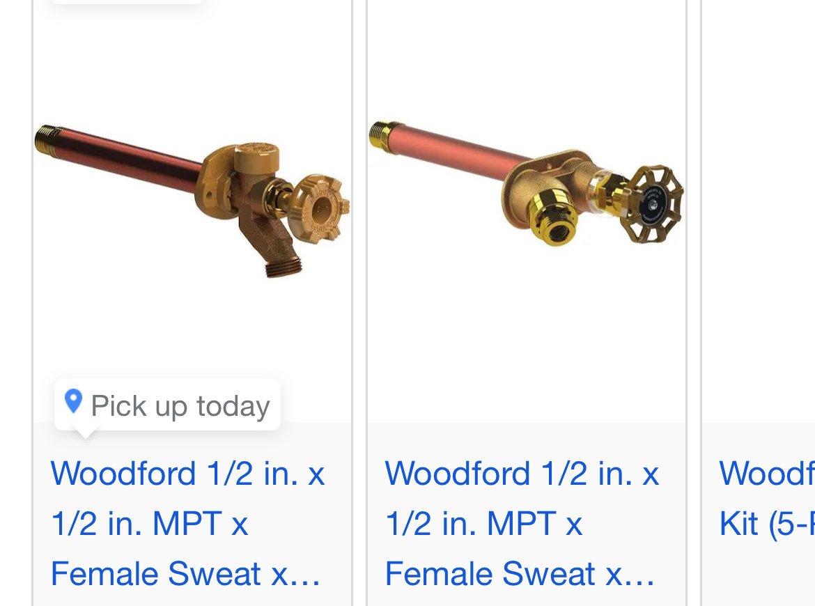

Another day, another thing I learn. About to pull the trigger on a 12" Woodford frost-free (based on reccos on this forum) I see in the specifications list: "Not rated for continuous use."
After a brief internet rabbit hole I understand that this has to do with the anti-siphon system: these are not rated for continuous pressure.
Any suggestions for a good quality sillcock rated for continuous use?
(As you may have guessed I'm adding a timer based irrigation system for our plants and so will keep the bib/sillcock always on in the summer.)

    I'm guessing https://www.supplyhouse.com/Woodford-14CP-12-MH-Model-14-12-1-2-MPT-x-Sweat-Inlet-Wall-Faucet-w-Metal-Handle
    (14CP-12-MH) - the 14 series - will work for my application. Would appreciate someone takign another look. There is no vacuum circuit breaker, so there is no 12 h limit.
    Yeah, I attach those between the spigot and the hose.

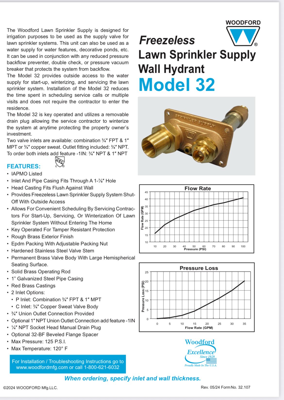

    Look into the Woodford Model #32. While it does not state "continuous operation", it is designed for lawn sprinkler supply.

    it looks like this 32 comes without the BFD function
    I think all the model 14 have the vacuum breaker built in?
    mattmia2In_New_England
    mattmia2 Member Posts: 17,906
    The 32 is really just a very expensive valve, escutcheon, and union.
