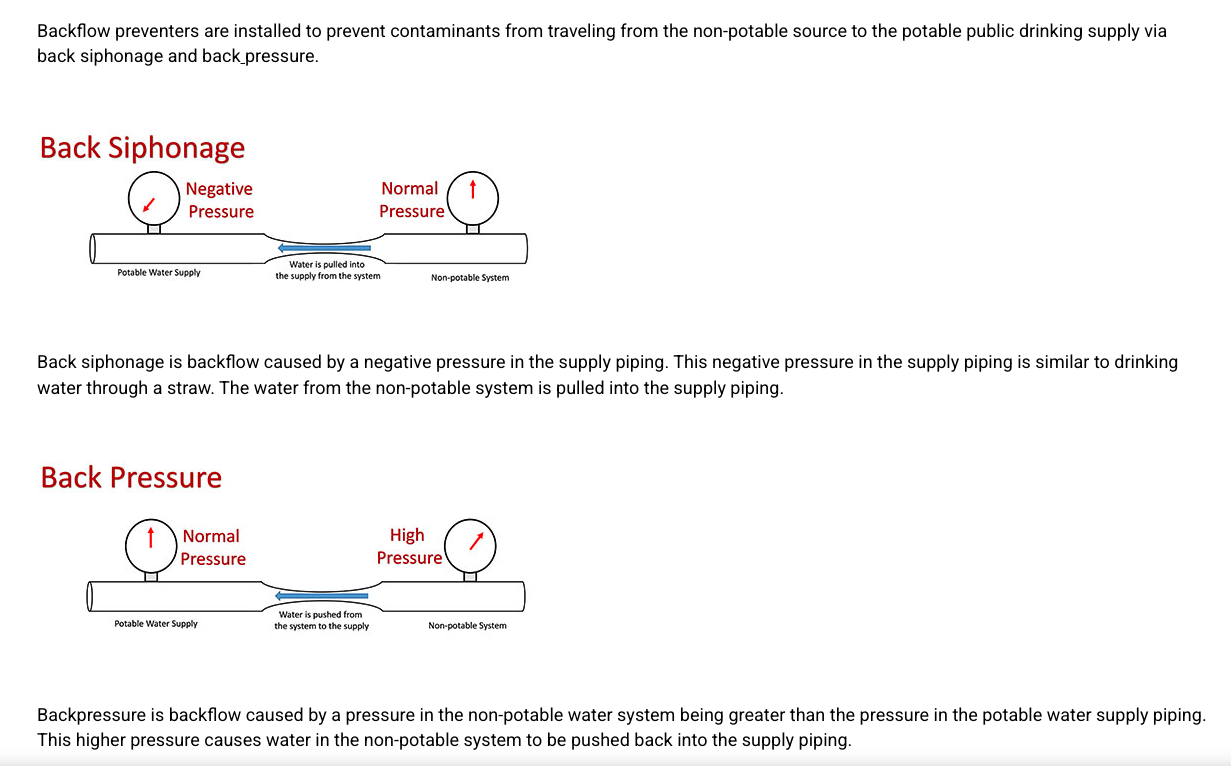

    hot_rod Member Posts: 27,489
    You may need multiple BFDs also. The BFD on the lawn sprinkler prevents that water from getting into your homes system.
    The BFD on the main line prevents the water from going back to the city or provider.
    Same with the BFDs on outside hose bibs, kitchen spray hose faucets, spray hose protect your homes waters.
    Here is the difference between back flow and back pressure.
    Back siphonage is typically when a water main breaks and pressure drops in the system pulling water from the buildings.
    Back pressure is more like a system without a thermal expansion tank and pressure increases forcing water into the main.
    Different valves are rated for back siphonage and back flow, that is what the ASSE number tells you.
    An ASSE 1013 RPZ is listed for, and protects against both and the open vent tells when a check fails. It is also required to have test cocks.
