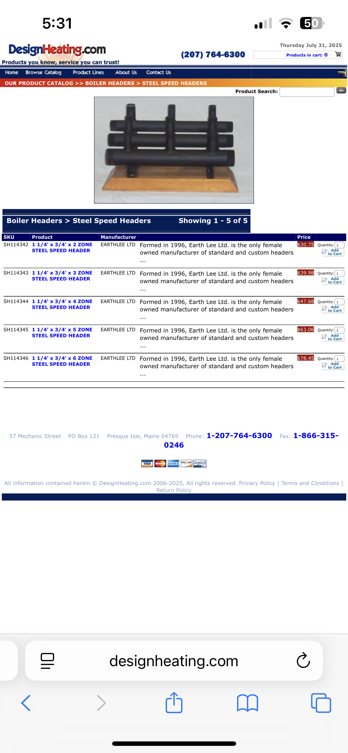

    hot_rod Member Posts: 25,717
    Is Earthlee Header Co still around? She welded some custom steel headers for me years ago
    Maybe a name change ?
    I have seem them at wholesalers as Speedy Headers
  • Cyclist77
    Cyclist77 Member Posts: 177
    THis sounds like something I will order! Made in the USA!!
