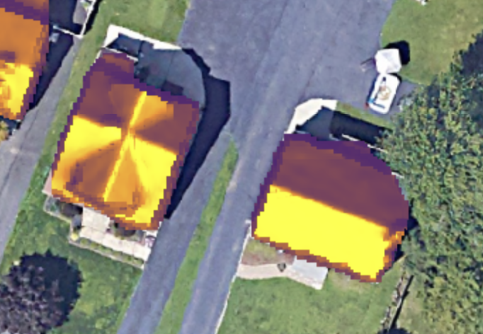

Here is the solar profile for my house on the left, it's not bad due to my 10:12 south-facing roof. But the large dormer interrupts it. My neighbor to the right has an ideal situation. High roof, good angle and direction. You can see your own solar profile at https://sunroof.withgoogle.com

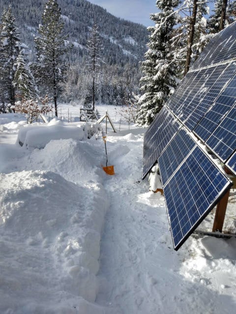

    Good luck to it! We installed a 10KW ground mount system (nothing like being a farm — you have acreage to play with!) about a year ago, and it's working fine. Much the same deal with the power company that you will have.
    For the year we have generated very slightly more energy that we have used.
    We figure the payback on investment will be around 10 years, although with recent rate increases it may be shorter.
    It does use microinverters, and we've had a couple fail — infant mortality — but they were easy to replace.
    Next step is going to be seeing about a big battery bank — but at the moment at least it doesn't pay.

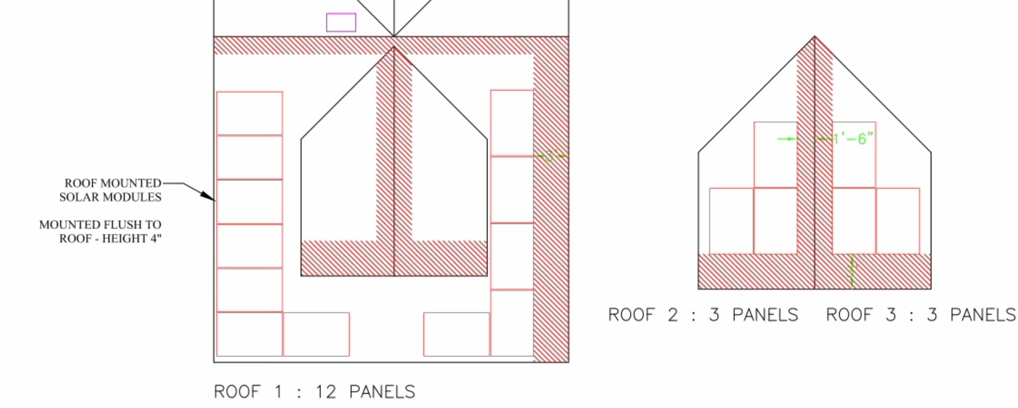

    18 panels, if the town will approve it. 7.83 kW

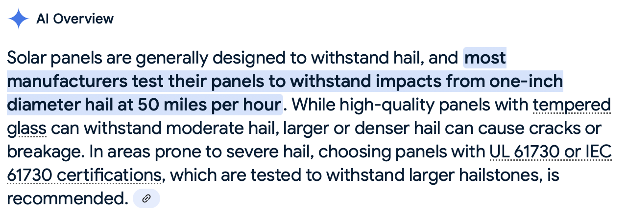

    It wouldn't be hard or particularly expensive to make the glass on the panels tempered glass bedded in such a way that they are nearly hail proof. There are roofing systems that are also if that is a recurring problem in your area.
    ethicalpaul Member Posts: 8,167
    AI says:

    tempered glass doesn't crack…

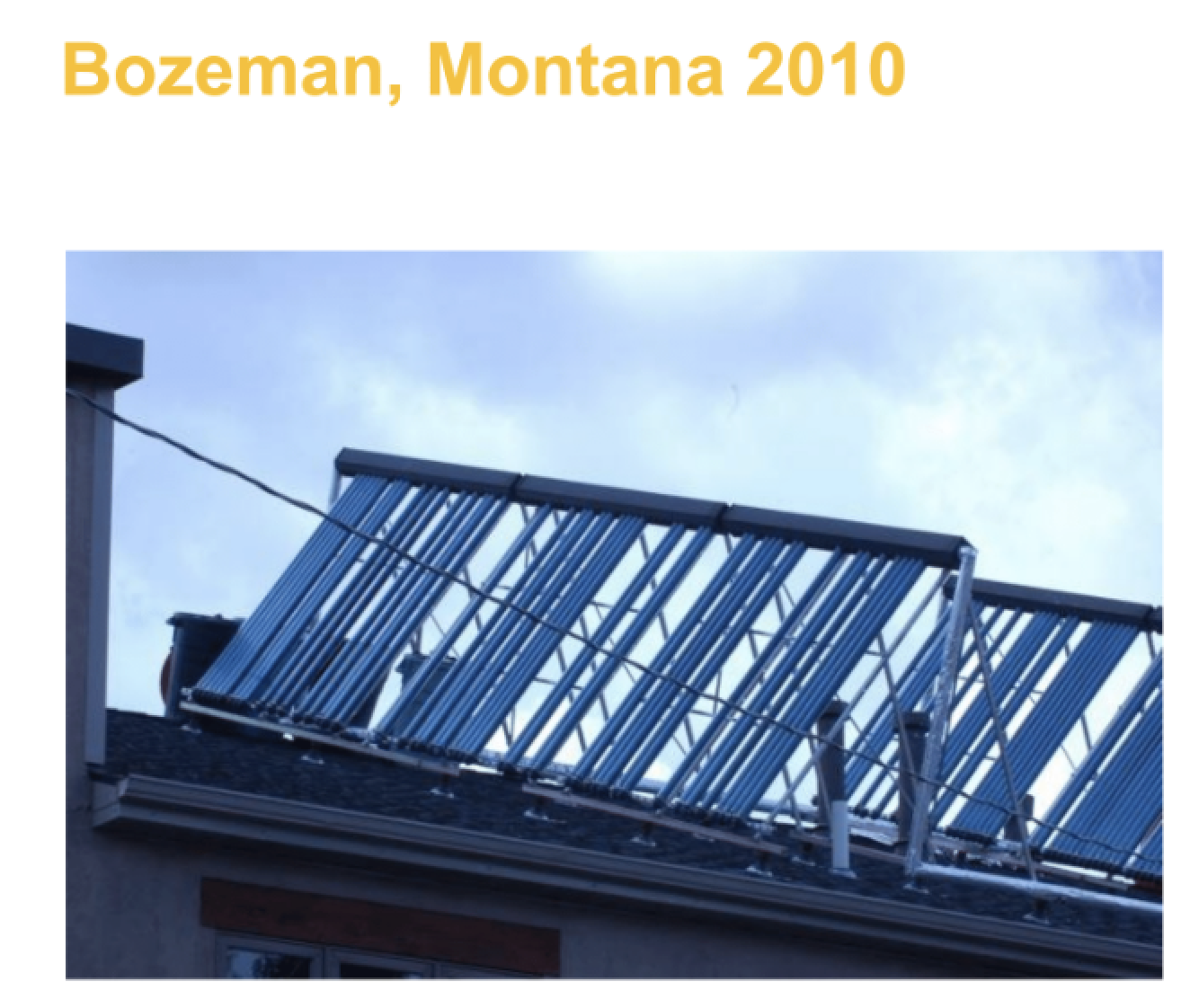

    The pitch, angle of the modules, has a lot to do with damage from hail, or seagulls dropping shells on the modules.
    At least that is what we found with thermal collectors. And yes tempered glass will shatter if hit with a sharp object.
    Evac tubes, being annealed glass are more prone to breaking from hail. This steep array after a hail storm.

    The ship has probably sailed, single inverter would work for your right neighbor but your install would work much better with micro inverters. Partial shading is the bane of PV arrays.
    You can still make the current setup work well if they can get an inverter that has multiple MPPT inputs (ie SMA Sunny Boy Inverter SB6.0 ) and try to break up the arrays so partial shading will only effect some of the strings instead of all of them.

    @Kaos these panels (all panels) have 2 or 3 sections, each with a diode, that allows shaded panels to allow the current from the other panels to pass through.
    Also, these panels each will have an optimizer that will maximize the power regardless of shading.

    As long as you have multiple MPPT channels (or optimizers) and they don't do anything silly like wire east facing panels in series with west facing ones, it will work well.

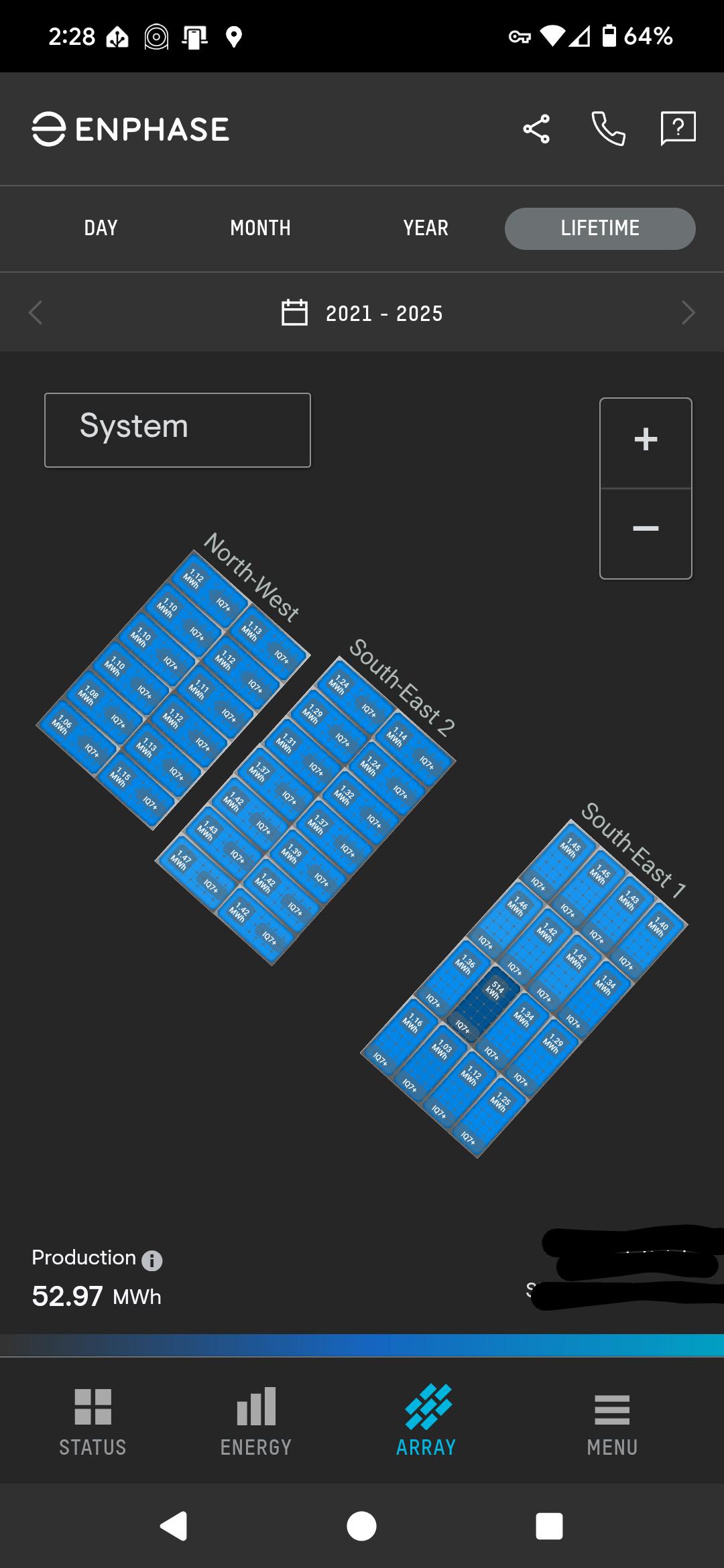

    Welcome to the club.

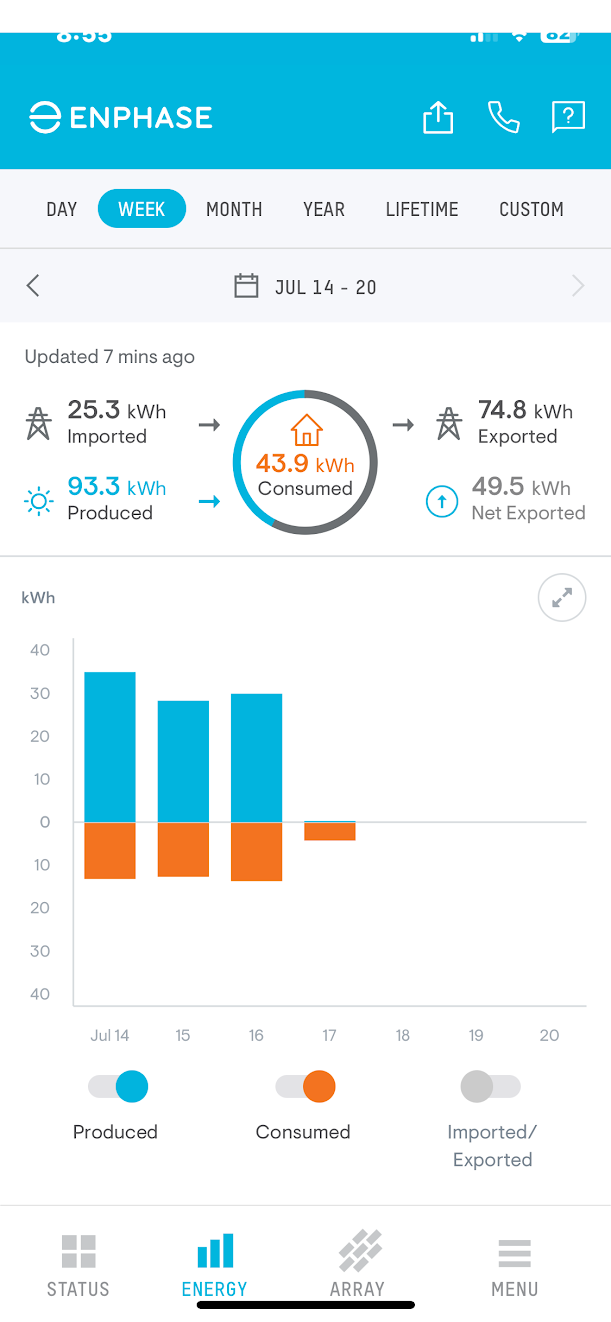

    I have a 42 panel 12kw system with enphase micro's installed end of 2021.
    I've slowly moved all my appliances except for the boiler over to electric. Still not a dime spent on electric since the spring of 2022... I did suffer one panel failure and one micro failure that was handled under warranty. Did pay for squirrel 🐿️ defenses. Little buggers.

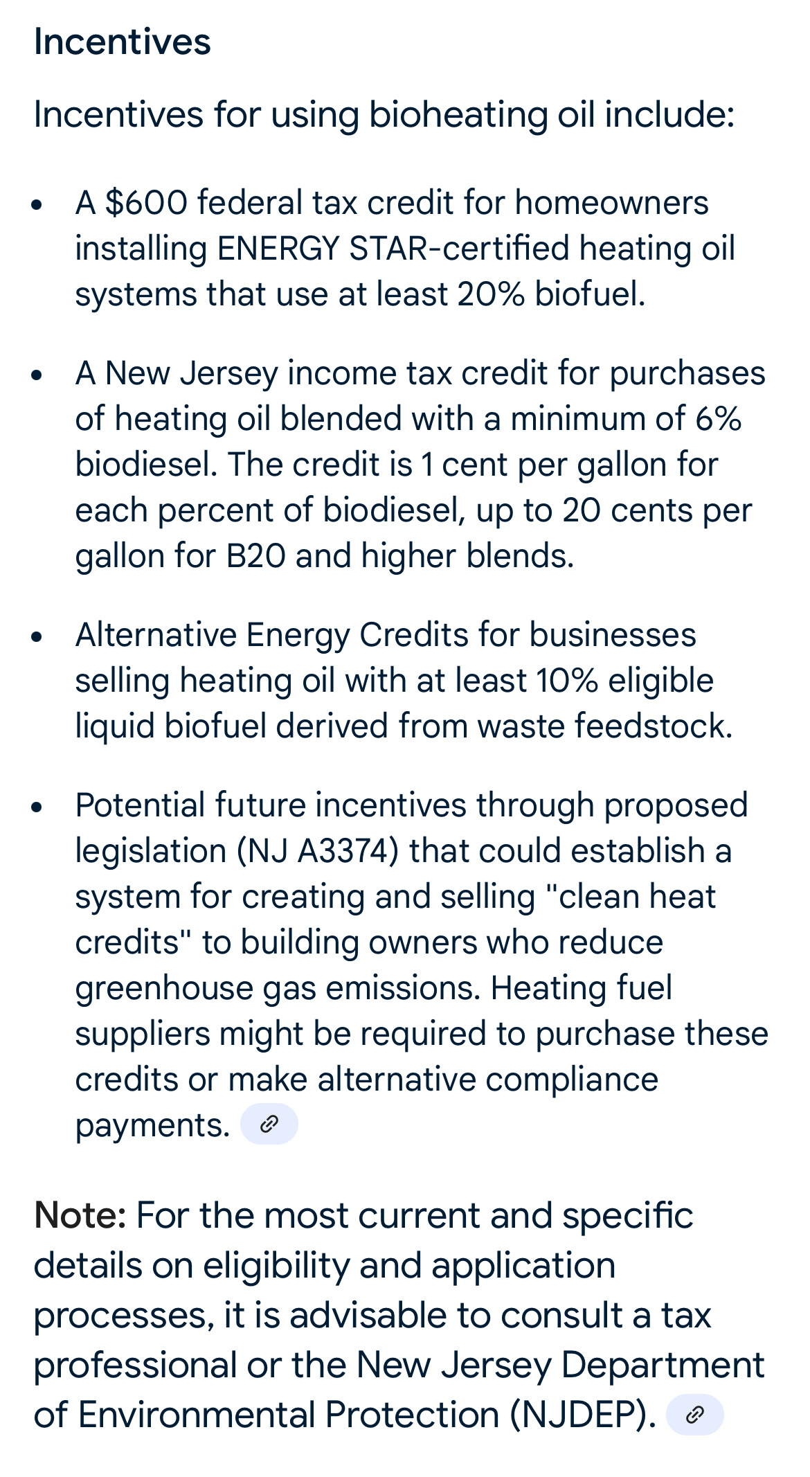

    hot_rod Member Posts: 26,595
    look like bio heating oil receives a lot if federal and state tax dollars for incentives. What about those that do not heat with oil? Are they paying?
