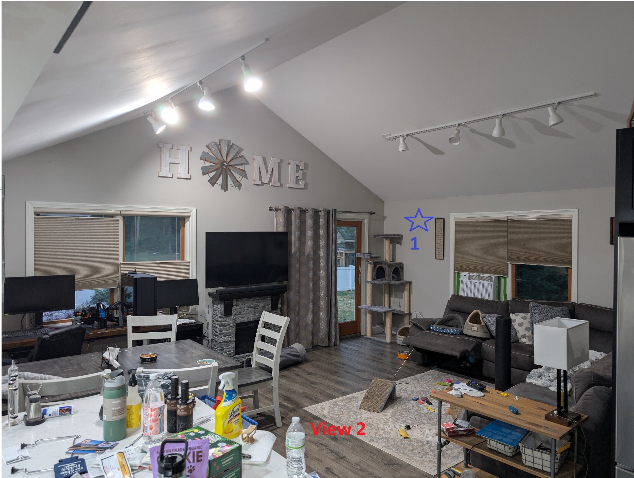

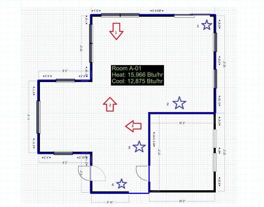

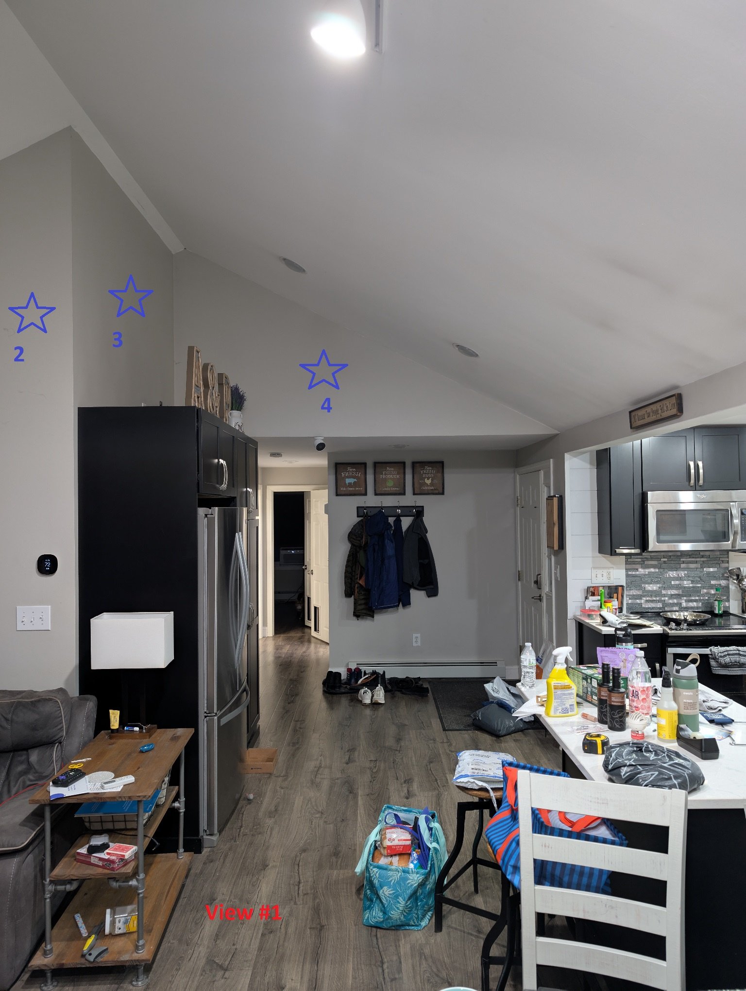

Looking for some advice on location for a single zone non ducted mini split for the open portion of the house. The other end is bedrooms and for now I'll keep them with the window units. I have marked the layout and then the camera views for each spot, red arrows refer to the pictures and the blue stars refer to the possible mini split locations. My wife will kill me if she knows I put pictures of the messy house online..shhhh it will be our secret. I can't put the mini split on the big wall with the "Home" decorations because I have an addition in the works and that wall will be gone. Area to be cooled is 600sq ft, but 400 sq ft has that 12' cathedral ceiling. In doing basic calculations depending on various assumption I'm getting either a 18k BTU or 24k BTU capacity. All I know is that 14k window AC near mini split location #1 normally keeps everything cool, but as the outdoor temps approach 90 the room temp drifts up.
Aesthetically I would prefer mini split location #3 or #4, but not sure it would cool the whole area. Thoughts?

    I think the ideal spot is right where you show the decoration 'Home'.
    ethicalpaul Member Posts: 7,748
    It's not ugly when it is quietly spewing cool air onto you that's for sure. The "Home" wall is not available he said.

    We have it set for 70 degrees. Insulation is R19 batts in the walls and two crisscrossing layers of r30 batts in the ceiling. Where would you recommend puting two heads, at locations #1 and #3?

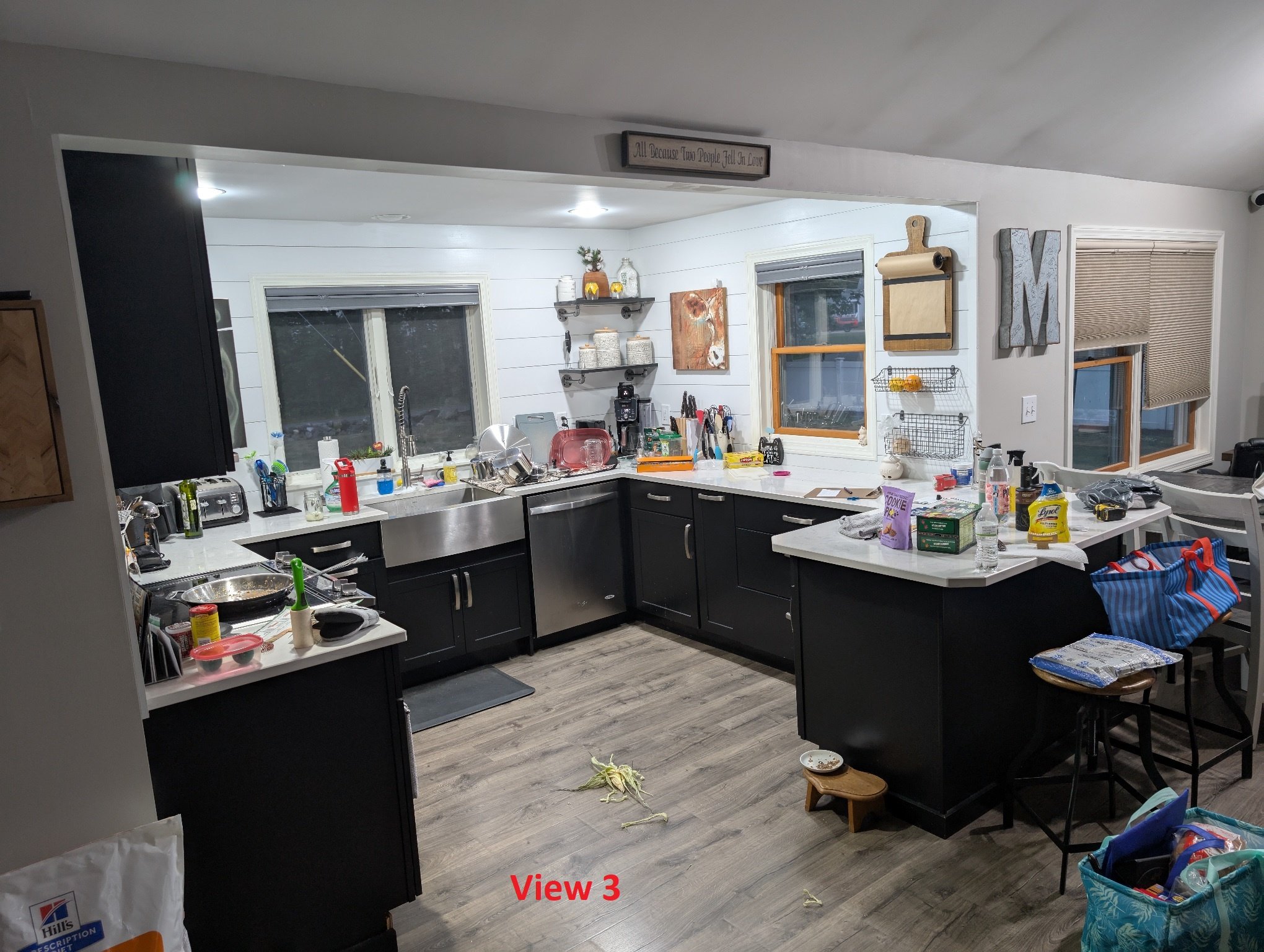

    Cooking can plug the evaporator quickly, that leads to more expensive maintenance. Keep the head as far away from the stove as possible.

    If these were my choices for location I would put it at #1 and adjust the airflow to only blow into the living space so its not blowing at that wall, and I imagine your cats will want you to move the cat tree

    I like locations 2 and 3.
    It'll get the cool air mostly where you want it and make running the linesets and electrical easy.

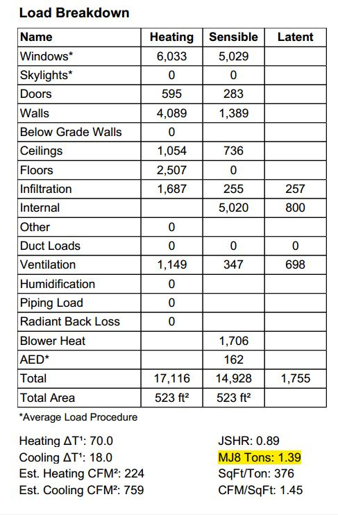

    Using Manchester NH as a design location (looked like the hottest temp choice for NH on my software) and putting all your windows in as 4' tall, excluding the room at the bottom right, and using the generic add on values for a normal kitchen and living room, with 4 people in the space, my software is telling me 1.39 tons to maintain 70 degrees inside (and design day is 89f there so not taking into account your over 90 days..). Honestly I was on board with everyone else saying a 1 ton unit would work great in that space. I think if it were for me I would still be on board for 1 ton, but its not for me its for you. So with that I would say a 1 to 1 18k mini split, but definitely get a good one with a wide modulation range because this will be sizing for a colder than normal indoor temp, and for a hotter than design day outdoor temp.

    A couple of windows are probably smaller than what I have on the document, and the kitchen/living assumptions are probably too high. But then again the weather the OP is experiencing is also above any design day I have for NH I tend to believe these numbers, I was expecting it to be lower. This isn't including the little room at the bottom of the plan either
    like I said I would put a 1 ton if it were my house, there is some fudge factor in there for sure.

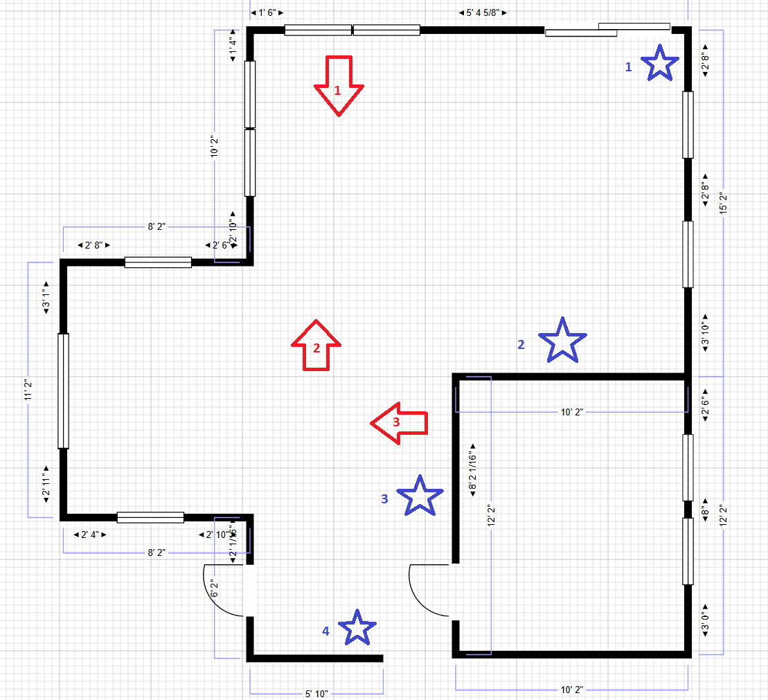

    On that addition I plan to take that wall with the "home sign" and set it back 4' to 6'. It will now be an inside wall and lose the windows so will would that be enough to offset the increase in cooling area or would that tip me over into say a 15k but unit?

    1/3 of your loss is in the glass if @GGross's calculations are close and even good windows are worse than a terrible wall so if you get rid of some of the windows with an addition your heat gain (and loss) go down significantly. You have a mostly outside walls and a lot of glass, I believe the calculations that show your btu/ft^2 is unusually large.

    Yeah it is unusually high, it's a small space with a full kitchen, set up for about 4 people or so, and 3 screens. I do want to emphasize that this load calc would be worst case scenario, someone on the computer, couple people watching TV and someone cooking up a storm in the kitchen. If you add to that people going in and out of the house more than normal on a humid day I could see the load being slightly higher than whats on the page. I'm kind of assuming that the worst case scenario happens on occasion since the existing window unit won't keep up, I would expect it to personally

    I also think it's going to go into position #4. I was told the cat tree wasn't moving so position #1 was no go.
