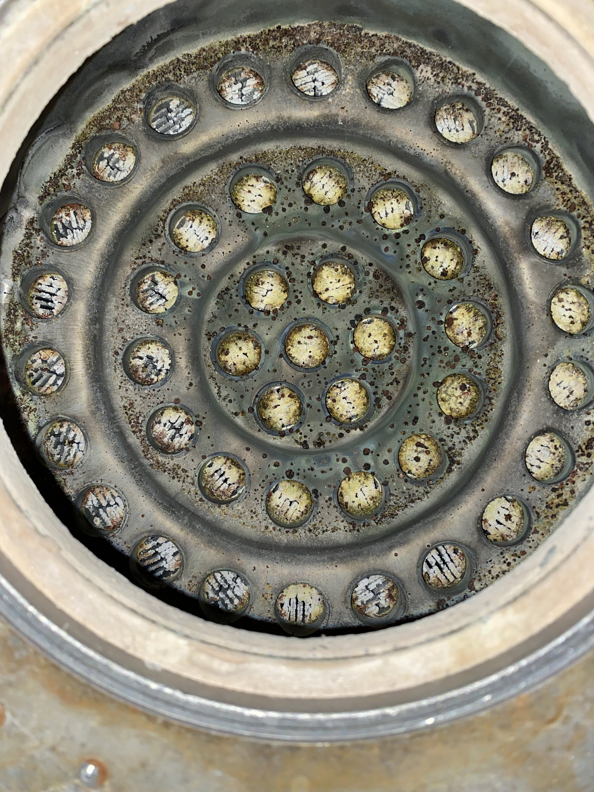

Hi everyone
New member here. I have had an HTP boiler (Model UFT-140W), I reside in Massachusetts and whenever the weather gets humid outside the unit throws a Error 11 code. I have to pull the bottom off of the condensation collector that sits at the bottom of where the condensation drips down into, a gray gross watery mess comes out and then it fires right up. The unit vents outside with the help of a flush mount vent cover (DiversiTech HVENT-2). I called HTP to see if they could recommend a servicer of their products to clean out the drip chamber (ive put my pinky up in it, and i can feel that grey build-up, sludge and even some that is cooked and hard).
Does anyone have any experience with this? Cold showers before a day at work is NOT a way to start the day.
Thanks in advance.

    If you stuck your finger into where the condensate trap connects and found goo then you need a cleaning on the fire side of the heat exchanger, not the water side. Clean the fire side of the heat exchanger first, nothing here indicates an issue in the water side

    update. Had a new plumber come in, add a ball valve w a clean-out hookup, he descaled the whole system and all my home’s hot water pupes to boot. Still get the Error 11 on my HTP boiler.
    it is VERY hot and humid here, so when i shut off the boiler off, open the condensation collection tube and the little (and clear) water falls out, i wait about 10 min and the unit fires up.
    i checked my 2 propane tanks (125 gal each), and they are at 20 and 40. I contacted my provider and they said theyll come fill them.
    Wondering if this is just a “trait” of the boiler (or any boiler), is it the way it is vented, just looking for possible answers.
    109A_5 Member Posts: 4,346
    Maybe excessive contamination on the fire side of the heat exchanger is messing with the ignition when the condensation can not drain properly or sufficiently.

    Yeah I still don't see how we went from clogged condensate and an ignition error to descaling the pipes. Sounds like a fire side problem. All of the advice prior to calling a plumber was to service the fire side, you should never aim to descale the closed system boiler piping unless there is a massive problem with that water. The condensate that is coming out of the boiler is NOT from the closed system (unless there is a hole in the heat exchanger) again what you have is a fire side problem, you need burner service, and to clean the FIRE SIDE, not to descale the inside of the boiler piping, that will not fix your problem and very likely will cause new ones.
    mattmia2Ironman
  • Ironman
    Ironman Member Posts: 7,942
    ^^ ^^ This!
    Apparently, the plumber that you hired has lead you to believe that the WATER side of the heat exchanger needed cleaning. This was a mistake as that is rarely the case and it would not cause an ignition issue.
    As stated, the FIRE side of the heat exchanger needs to be chemically cleaned as that heat exchanger is very prone to fouling due to the aluminum fins in it.
