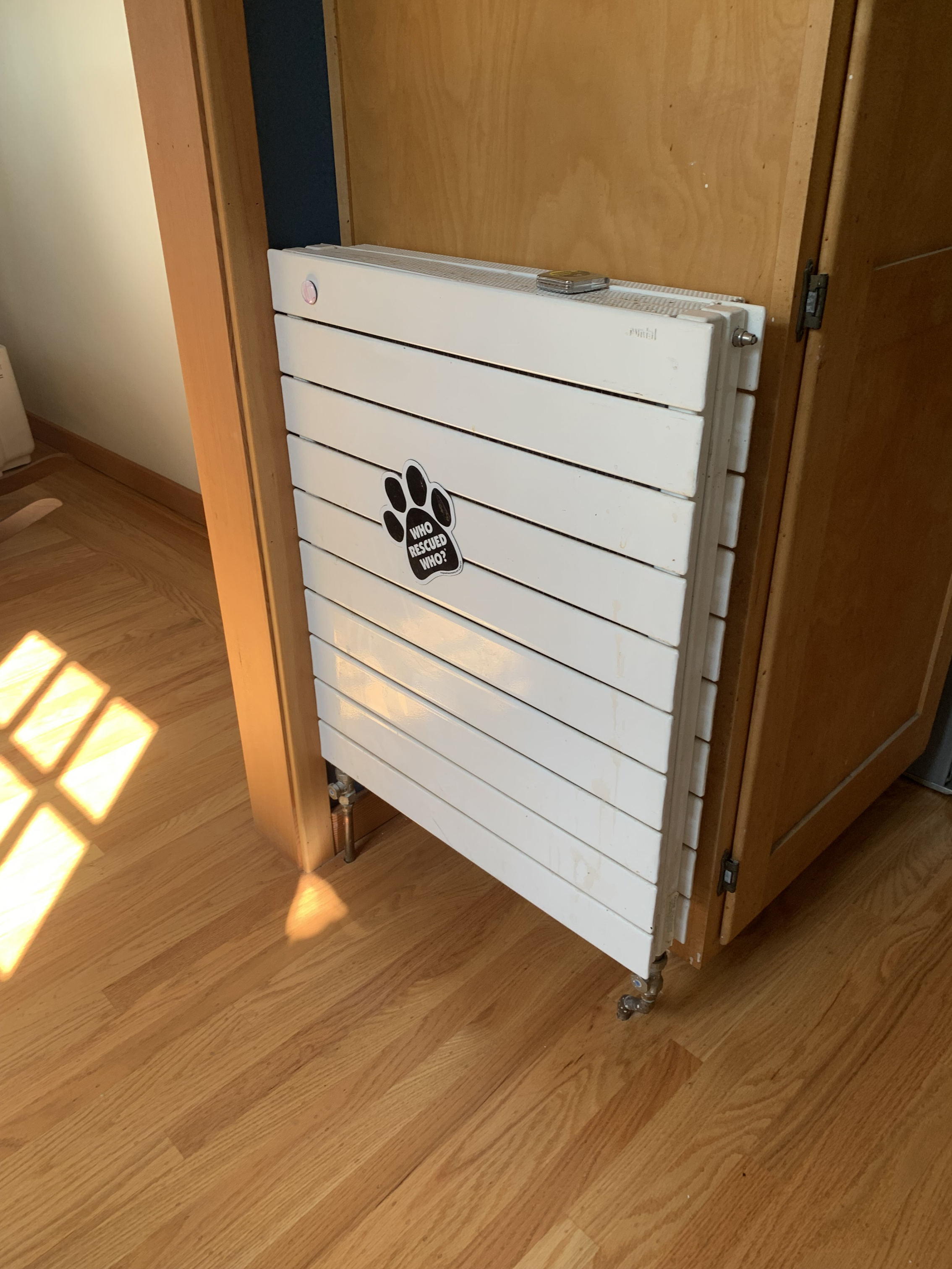

We installed this boiler and radiator system in 2017 when the owners purchased this house. Nothing had been done to the building since it was built; single glazed windows, no insulation.
I sized the radiators for 130F water temperature as I wanted the boiler to condense and they turned out very large. My supplier says I order larger radiators than anyone else. I suppose that’s a compliment.
Recently remodeled, the radiators are now way oversized and I can drop the heating curve even lower. It’s now set to 1.1 with zero offset and the radiators will only get warm, not hot. Safe for their new children and more savings on their utility bills.

    Nice. Is the reason for the reduced heat lost because of their new insulation, windows, and air tightening? I suppose you do not have a new design water temp yet? But now much lower than 130F?

    what sort if delta do you design for? With a 30 delta you have some cool return temperature

    Good problem to have. I noted that it appears you selected the 2 sided (runtals?) You may be able to replace with the single sided as a replacement using tge same valves and be just fine. Then just resale these doubles. Singles have a considerably lower output

    So what is the answer? Lower water temperature or slower water circulation? Theoretically either method can go too far.
  • @tocker That’s not going to happen. The owners spent a lot of money to get the mass to drive efficiency. Changing radiators to smaller ones would mean increasing the heating curve; reduced efficiency.
    The existing heating curve is approaching a radiant floor.

    @Alan (California Radiant) Forbes I misunderstood; thought there was a comfort issue. BTW, I did the same…oversized runtal rads; boiler ended up way oversized, not because of planning, but because I installed during COVID and a smaller boiler just wasn't available. Max water temp is set at 150 degrees however, on 30 degree day, modulates to well under @120 ish.
