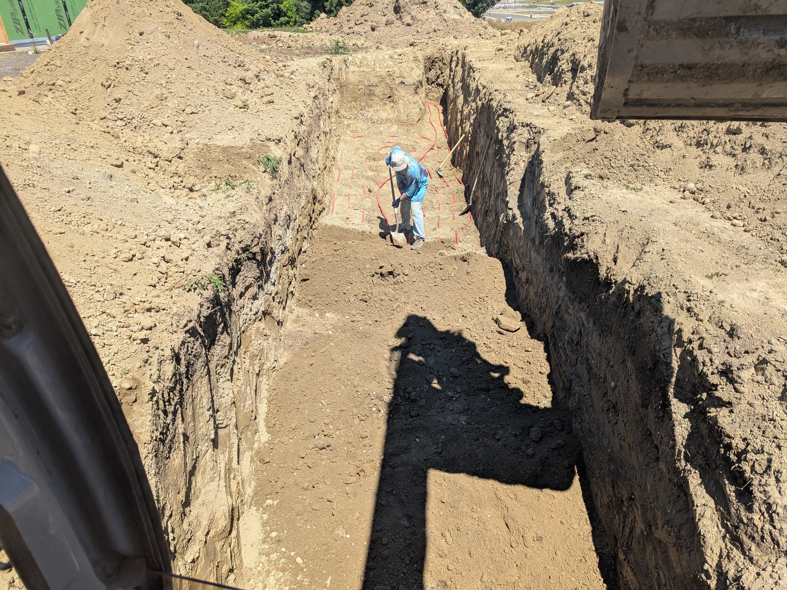

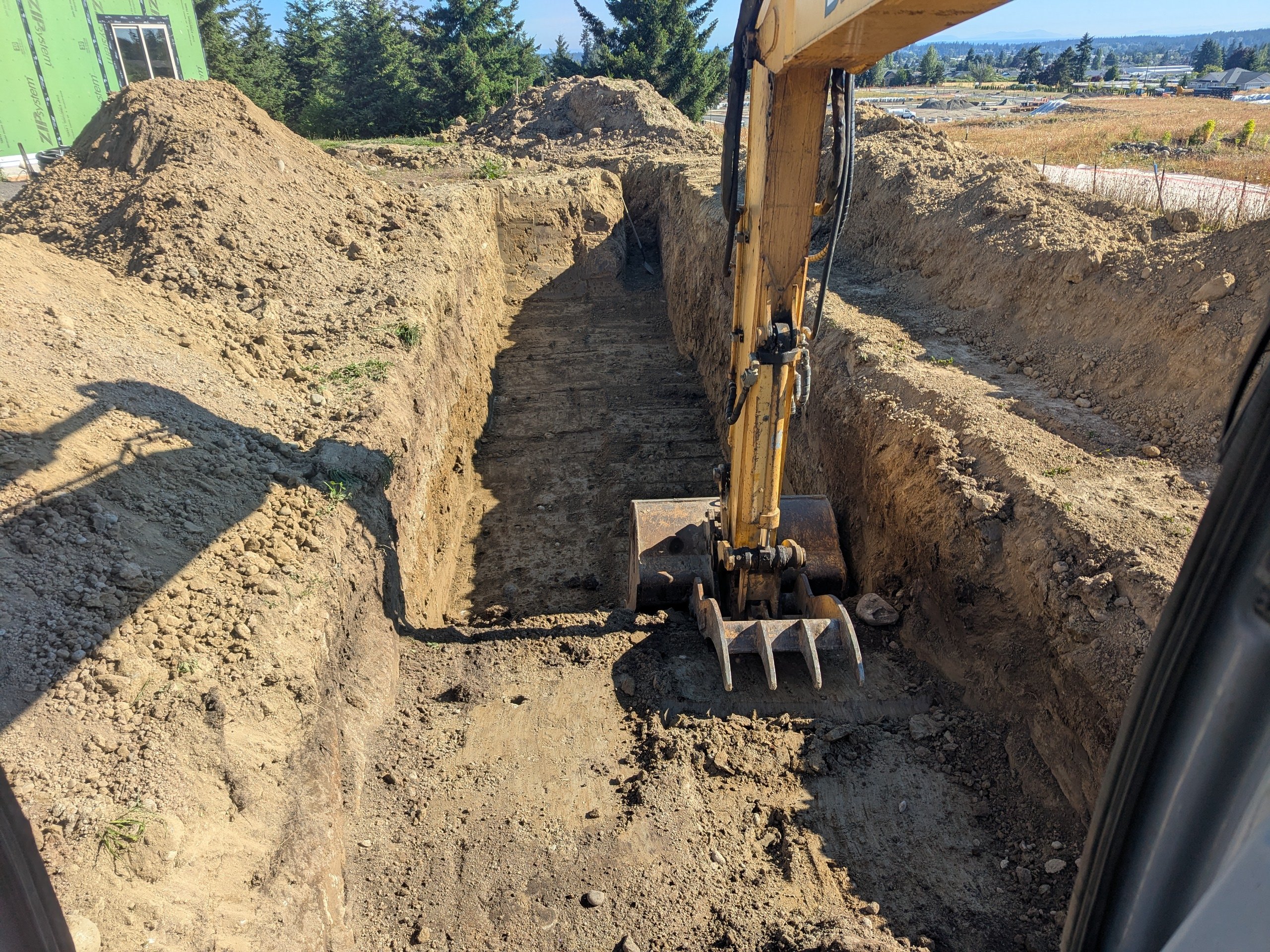

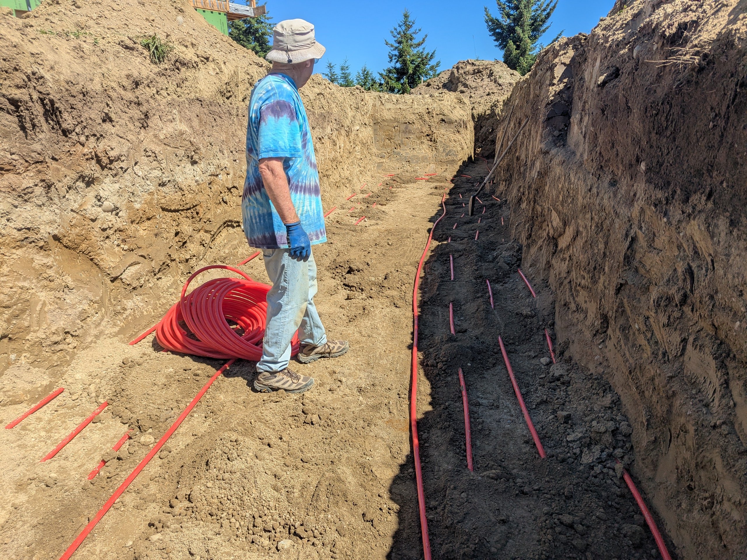

    We got the last loop in today. This one is not like the others, more of the classical 6' deep 9' wide gaw with a 10 pass loop.
    We are trying to water it in, but it does not want to take the water, LOL.
    We dug out along the first loop piping to get out there,and the wet clay was just as wet as it was in February. This is great. Wet clay has high heat capacity.

    Is cost the reason you did not use gravel bank concrete sand for the entire excavation instead of the local clay?

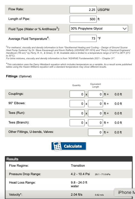

    Dirt work looks good. What size tube for those 500' loops?
  • GW
    GW Member Posts: 5,055
    is that 1" ?
    Curious how big the pump will be to keep the laminar flow

    hot_rod Member Posts: 25,324
    The PPI website has a useful calculator for plastic piping.
    https://plasticpipecalculator.com/PressureDropHeadLoss.aspx
    This shows a 500' loop of 3/4" pex. 2.25 gpm of 30% glycol gets you over 2 fps velocity.
    It will take a circulator sized for that 24' head, at the gpm total of all the loops.
    If all the tube is protected from freezing plain water really helps decrease the circ requirement, 9.8' with water

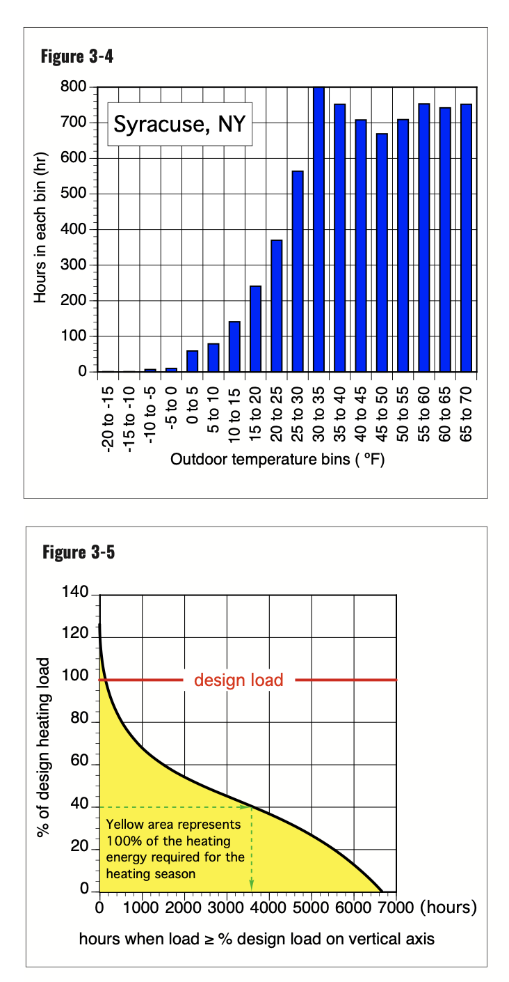

    I doubt you will be at design load 31K? for more than a week or two per year. So the load on the field lessens. You can find temperature data for your location online, as an example for upstate NY. Design day there is 0-5°
    I think moisture content of the soil has a lot to do with transfer, even in clay.
    Really a GEO field is basically a giant solar collector/ storage. Suns energy will drive into the ground to recover the field also.

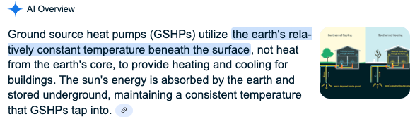

    ethicalpaul Member Posts: 7,760
    Deeper than that it gets warmer. The earth's core is at about 11,000 F but it's 4,000 miles away, so it's a pretty gradual increase.
    This is why "geothermal" is the wrong term. The heat this close to the surface does not come from the core, it comes from the sun.
    And the trench, whatever size it is, does not define the heat he will have at his disposal all winter. Heat will warm the "trench zone" from surrounding soil (below and from the sides) all winter.

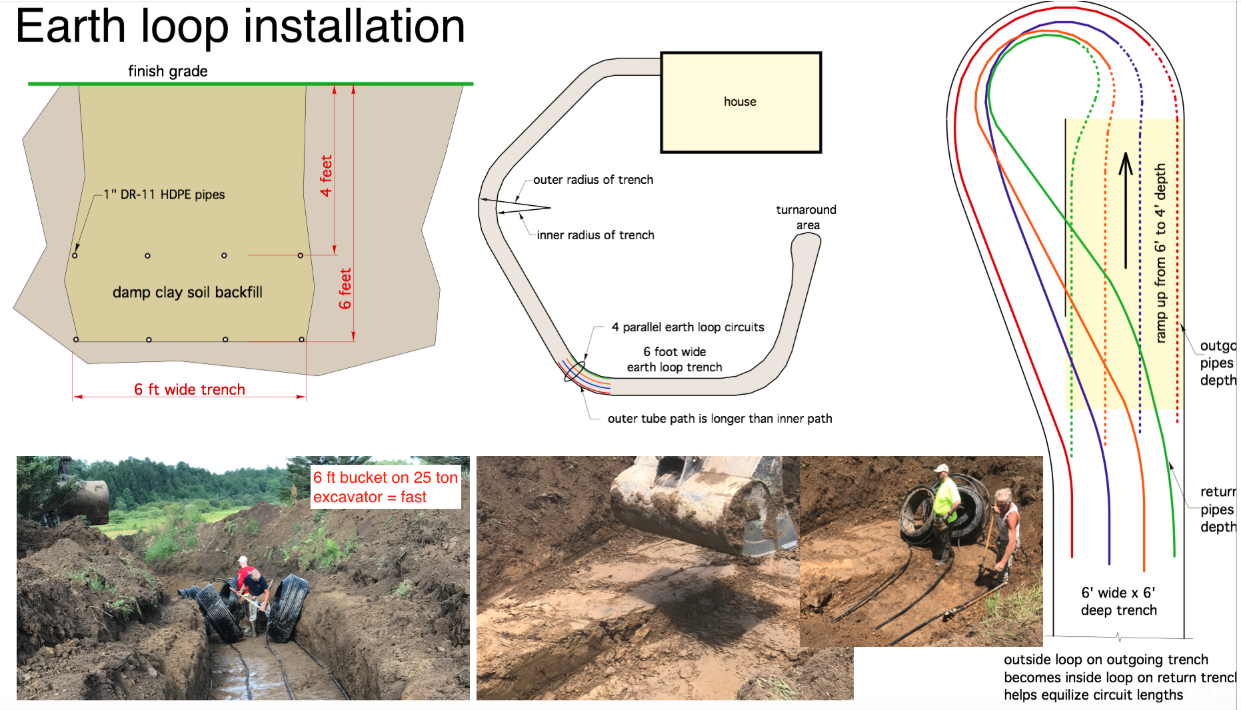

    Here is an out and back system in upstate NY, 35K load. 4 loops of 1" HDPE, 1000' loops. It's been covering the load for a few winters now.
    skyking1
  • DCContrarian
    DCContrarian Member Posts: 1,139
    "This is important, because our observations with my brother's field, a big 30x60 with 1800 feet of tubing in the 1800SF would cold soak pretty badly deep into the season. His soils were drier and less dense and not good conductors as @DCContrarian was talking about. We did not get much edge effect and that large contiguous field got below freezing by the end of the season."
    Frozen soil is a much better insulator than unfrozen soil. If the soil freezes then the capacity of the field drops precipitously and it's pretty much game over.

    "This is why "geothermal" is the wrong term. The heat this close to the surface does not come from the core, it comes from the sun."
    Agree that this is not a geothermal system, it's a ground source heat pump.
    It's actually an interesting question of where the heat comes from in a ground source system. I don't know, but it seems likely to me that the heat is coming from below, simply because when the heat is on the surface of the ground above is going to be colder than the loop and heat's not going to flow from colder to warmer. If the heat is coming from below, where is it coming from?
    I don't know, and the answer may not be knowable. My understanding is there isn't any commonly accepted explanation for why the core of the earth is hot to begin with.
    Knowing the load, using a GSHP design software, all the data is built in. Once you add location it knows typical weather data and ground temperature at various levels. So adding the soil type the program can size the loop tube and field size.
    NORA has soil temperature by depth data for the US.
    edited July 3
    It comes from the sun (the warmth at the top layers of the earth). The heat into these ground source loops comes from below and the side (from earth that was previously heated by the sun)

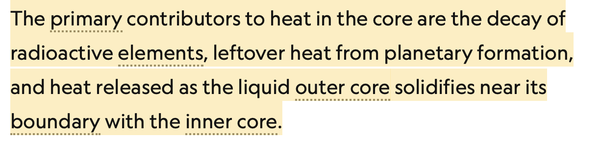

    It's quite understood:
  • DCContrarian
    Those are the three leading theories. Nobody really knows.
    The loops at 4-6' from the surface are probably more influenced by the sun than the core of the earth? I'd would suggest the same for well loops, deep, 100' or more or shallow.
    AI knows :)

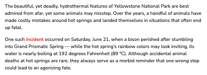

    Hot pools at Yellowstone run 190° +
