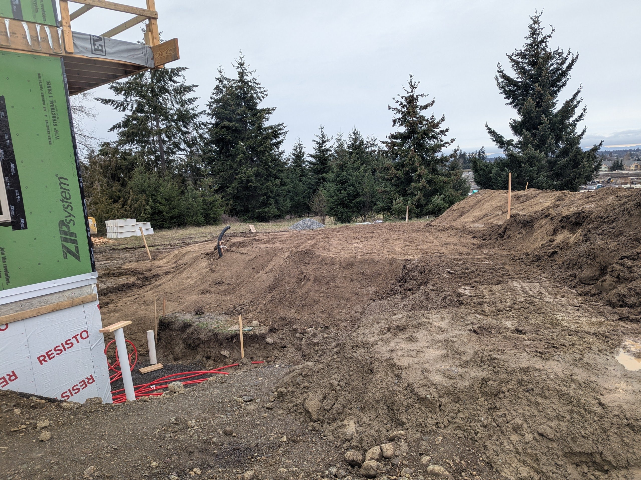

    I have 6 of 7 500' loops in for the new construction. Primary heat is hydronic staple up that we are starting next week. The basement slab is done with 1/2" pex in heat sheet R10.
  • leonz
    leonz Member Posts: 1,549
    What type of soil are the pipe runs buried in?
    Do the 7 loops of pipe consist of individual 500 foot long rolls/reels of High Density Polyethylene pipe with no butt fused pipe connections except at the header pipes?
    What is the depth that the tubing loops are buried in?
    Were the loops buried below the frost line if that applies here?
    What is the separation distance between in feet between each pipe run?
    What machinery is/was used to excavate the trenches?
    Was the pipe pushed to one side edge of the trench and dirt piled on it every 10 or 20 feet to hold the HDPE in place prior to thier burial?
    Was the rock in the trench dirt separated from the soil before the burial of the pipe?

    All home run no fused pipe in the dirt.
    It is clay with few rocks to speak of. We put it in pretty wet due to the time of the year.
    I also added perforated pipe about 3' above the loops and will run downspout water and also irrigation water to keep the mass at closer to optimum moisture content. Wet clay has better numbers than dry clay by a large margin.
    The bulk of it was pretty wet several feet down, but I will leave nothing to chance there.
    Frost design depth for construction here is only 12".
    Loops have 6' plus of cover. They are mostly in 8 or 10 pass wide trenches with 1' spacing. Each trench has a 2' buffer to the next, and one 10' gap for utilities.
    We located and pinned the tubing down at the 1' spacing with "babies" of wet clay. We giggled a lot during the clay lump process. : "I need another baby here!" " Oh that's a BIG baby!"
    here my brothers and nephew are raking the clay over and watching for any rocks as I push the clay over.
    The equipment is a 12 ton excavator and a large compactor to get great compaction and contact with the clay. It was easily 95% compaction in lifts. This is the work I do for a living and that is the company excavator.
    The edges of the field area will get a 4' retaining wall, the maximum I can do without engineering.
    The excavator sank in about 6" in the clay and I schmoozed it out as I backed off that fill in February. Now it has skinned over rock hard and the machine won't leave a mark in it.
    Because they are home runs I plan on using only half the loops at a time and alternating between the sets to see if I can get some recovery. It will be fun playing with return temperatures and seeing what we can do to maximize the loop temps and minimize the differential. The heating COP is directly related to that differential.

    I’m missing something- aren’t those loops too close to the surface?

    It is all down 6' +. I moved 300 tons of clay several times back and forth in different motions, the goal being to not disturb all the grass up there.
    Here you can see the loops as they arrive at the house, 6' + down. If they are located down the hill, they are dug down an appropriate amount. It is just hard to visualize it so I marked the corners of the loops with 8' boards. That big ridge on the right is just stored there to backfill the house when I can. The flattish surface is the first time I could visualize grade.
    I need to add some retaining walls and more dirt on the loop to the right. That was the hardest digging on the site there.
    The back yard will never be flat. It will get stepped retaining walls to make a flat-ish spot with what I have.
    It's come a long way since the rough Ex in September.
  • GW
    GW Member Posts: 5,060
    ahh I see you typed that above. Sorry! 6 feet should do the job! Looks good. What are you hoping for with ewt?

    looking to stay 40+ deep into the season by alternating loops.
