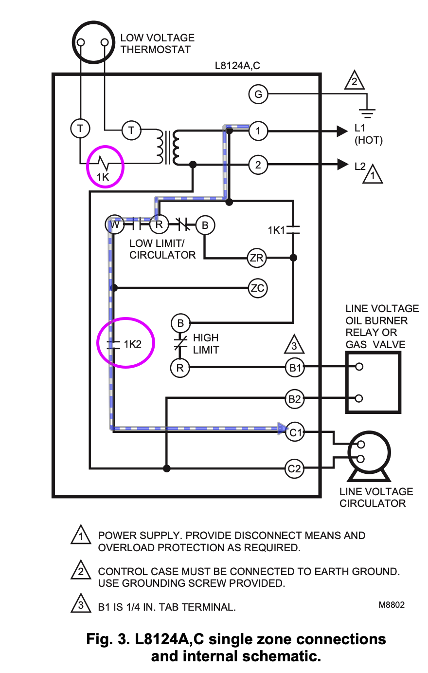

    EdTheHeaterMan Posts: 12,749
    edited May 2025
    This information is incorrect
    🔧 What Likely Happened:
    When you turned the LO limit down to 140°F or below, even momentarily, the circulator control logic in the Resideo L8124C1003 may have activated.
    This aquastat has a feature where:
    If the LO setting is set too low or the LO limit is momentarily crossed, the system can engage the circulator independently of the room thermostat, especially when the tankless coil is in use or believed to be.
    It may interpret this as needing to maintain domestic hot water temperature and begin cycling heat.
    Meanwhile:
    If the thermostat is off or has dead batteries, it won't be able to call for heat, but the aquastat can still independently drive the burner and circulator under its low limit maintenance logic.
    🧠 The Soft Click:
    That soft click you heard was likely the internal relay or bimetallic switch reacting to the low temperature setting you dialed, triggering the burner or circulator.
    🔁 What Happens After:
    Even though you returned the settings to 160°F/180°F, that brief dip below 140°F may have:
    Triggered a heating cycle under the aquastat’s low-limit logic.
    Caused the system to begin heating (especially if the boiler temperature had dropped slightly below the set LO during your adjustment).
    And because the aquastat doesn’t rely on the thermostat for this part of its logic, the heat turned on anyway, even with the thermostat turned off or failing.
    This answer may be from an AI bot and has no basis in fact. The L8124 control can not do what that answer says it can do. The only way the
    circulator can operate is if the 1K2 contacts on the K1 relay inside the L8124 is connected (operating properly) or welded together (defective). Adjusting the low limit will have no way to power the circulator. The low limit only has the ability to stop the circulator from operating. That happens when the water temperature is below the low limit setting and R to W is open and R to B is closed to operate the burner to raise the water temperature.
    The 1K relay in the L8124 relay can only be activated by the thermostat circuit (T to Tv) or (T to T) circuit being completed. 1K2 contact can only be closed when the 1K relay coil is powered. See the Blue dashed line from L1 power to C1. the circulator can not operate with 1K2 contacts open
    Nowhere in your comments here, do you mention that you have a L8124 aquastat relay. You must have mentioned it to the ChatGPT. So to be clear, what is the actual part number of your aquastat relay? If the thermostat circuit circuit is not getting a call for heat from a thermostat or zone valve end switch, and you have power to C1 on the aquastat relay, then the relay is defective and should be replaced.
    @HVACNUT has the proper test procedure above. Remove one of the wires from T T and connect C1. The circulator should not operate. If the control does not power the C1 when you disconnect T T wires then you will know that your problem is in the zone valve wiring. Somewhere in the zone valve wiring there is a completed connection between T and T. That would be my guess!

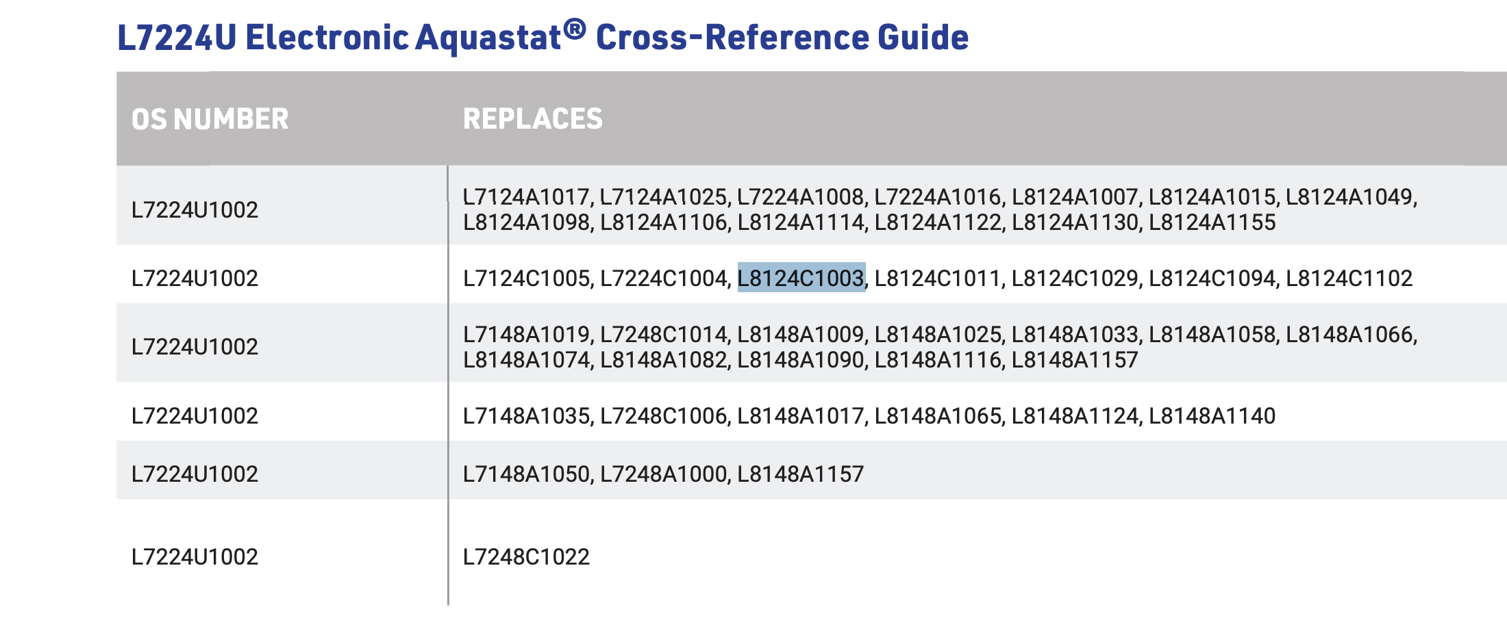

    edited May 2025
    That Resideo L8124C1003 is defective. C1 can not have power unless T T is connected with a jumper wire, thermostat or the end switch of a zone valve or otherwise connected. although Electronic parts are often not returnable, you should try to take it back to the place you purchased it and say it was defective out of the box.
    This is the lower cost better replacement for that control: L7224U. You will want to measure the voltage that is coming from the wires that you connect to T T before you connect them to the aquastat. There should be no voltage on those wires from the zone valves or thermostats. If those wires are sending 24 volts to the T T, that is a problem. Those wires should only be open or closed, never powered. That is because the power for this circuit comes from the L7224U (or from the L8124C) itself.

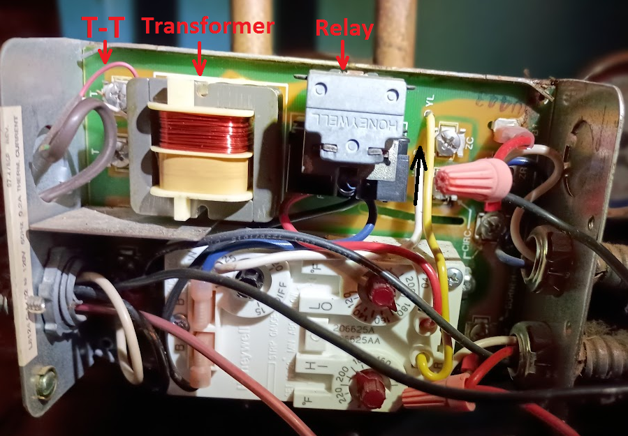

    @109A_5 Pics inside the aquastat before I replaced it. This worked perfectly for fifteen years. This is how I restored it after undoing the changes the tech made after audible malfunction signal. So this is how it was and this is how it is now. https://photos.app.goo.gl/VWX6HRU2hrRRN1xy6
    A wire resting on the relay? The tests have been conducted with the cover off, so I say, No. Could you help me identify which relay you are referring to? I am only aware of one metal mechanism that visibly moves, or snaps open when the boiler is energized.
    109A_5 Posts: 4,497
    There is only one relay, the aluminum colored part of it has "Honeywell" recessed in it. The Relay has three parts to it, the control section, the coil (1K) and two independent contacts or switches, 1K1 and 1K2. The 1K2 section acts as the switch for the circulator.
    With 120 Volts AC applied to L1 and L2 the transformer converts it to 24 Volts AC. The 24 Volts AC is used to energize the coil of the relay (1K). The coil of the relay is normally not energized. The Relay coil should only be energized when the T - T terminals are electrically connected. The T - T electrical connection is often applied by a thermostat or an 'End Switch' in a zone valve.
    As a test, if no wires are connected to the the T - T terminals the coil of the relay should not be energized and the circulator should not run and the armature (black plastic and aluminum) of the relay should not move and the relay's armature should be in the same position as when the whole system is powered off.
    The only time the relay's armature should move (the black plastic closest to the circuit board moves up) is when the T - T terminals are electrically connected (and the Aquastat is powered) or when the T - T connection is released.
    Why is the Lo limit set so high ?
    109A_5 Posts: 4,497
    This does not look very healthy.
    109A_5 Posts: 4,497
    I can't really tell which pictures are the newer unit, most seem to have corrosion visible.

    All pictures (above) are of the old unit. Notice at C1, lower left of screw head, a black dot on the circuit board? This is a burn mark. Water had gotten inside the box. This is why I bought a new aquastat to replace the one shown in the pictures above.

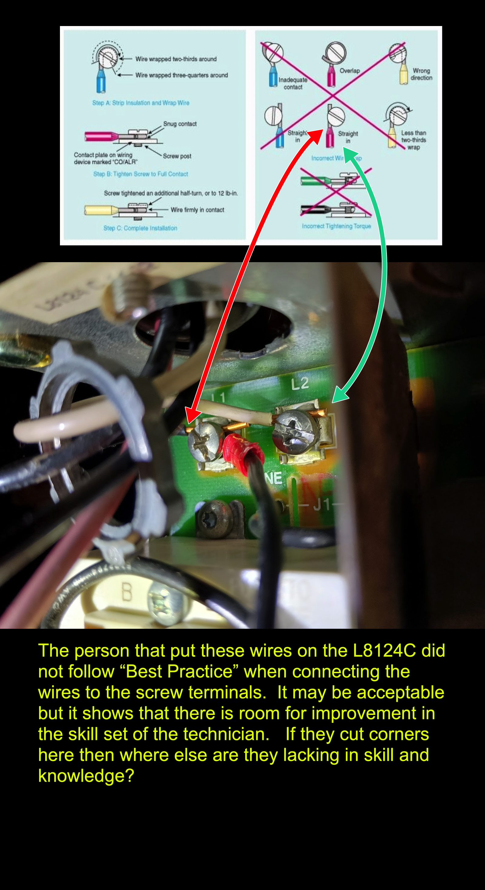

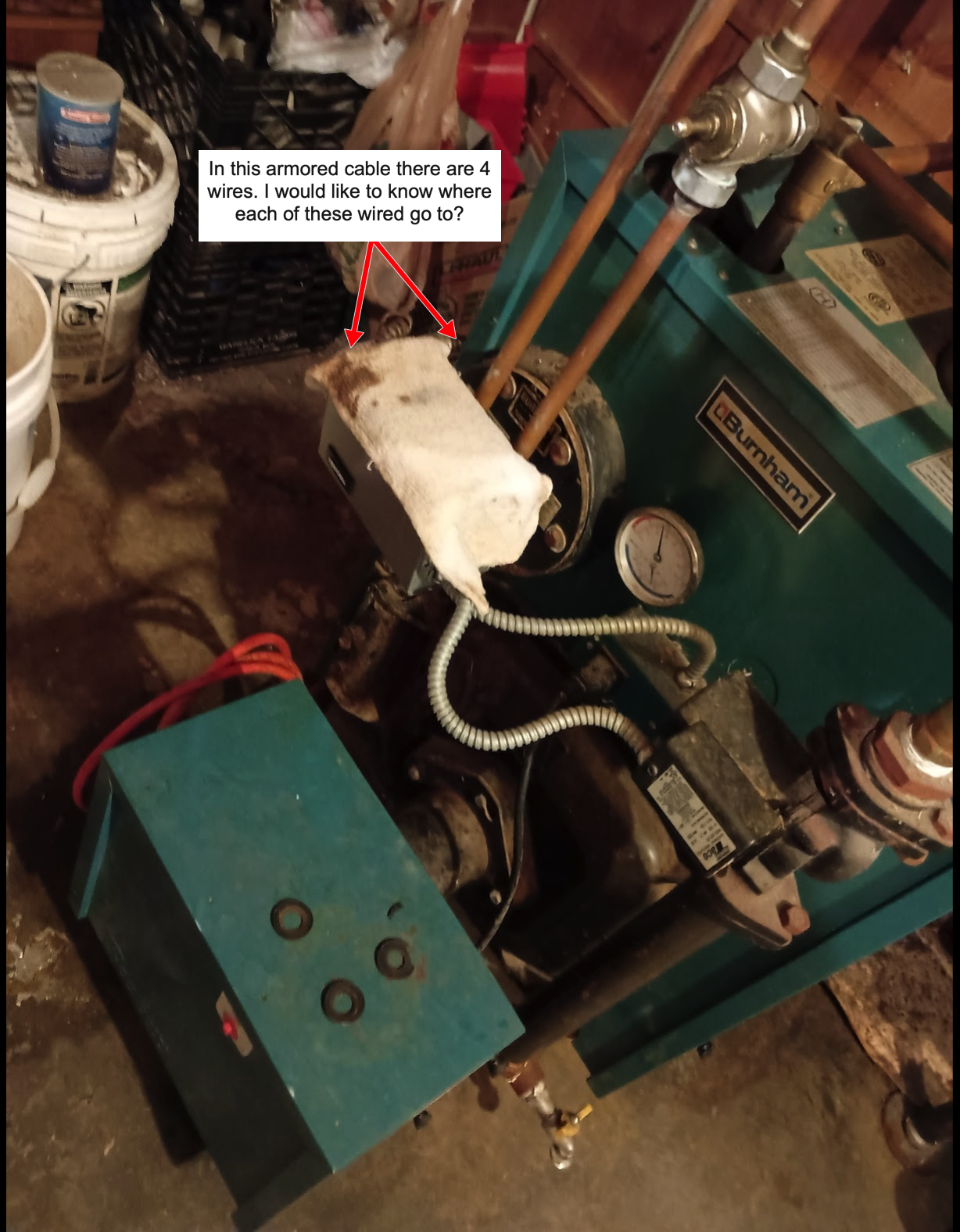

    @WilliamJ , I would like to point out something about the technician that connected the wires to the control. If that was you then I am not criticizing your abilities and only wish to help you correct a bad habit. If it was the professional technician, I am pointing out that this particular tech is taking shortcuts and may also be lacking in their knowledge of how that control should be connected to the Primary control of the oil burner.

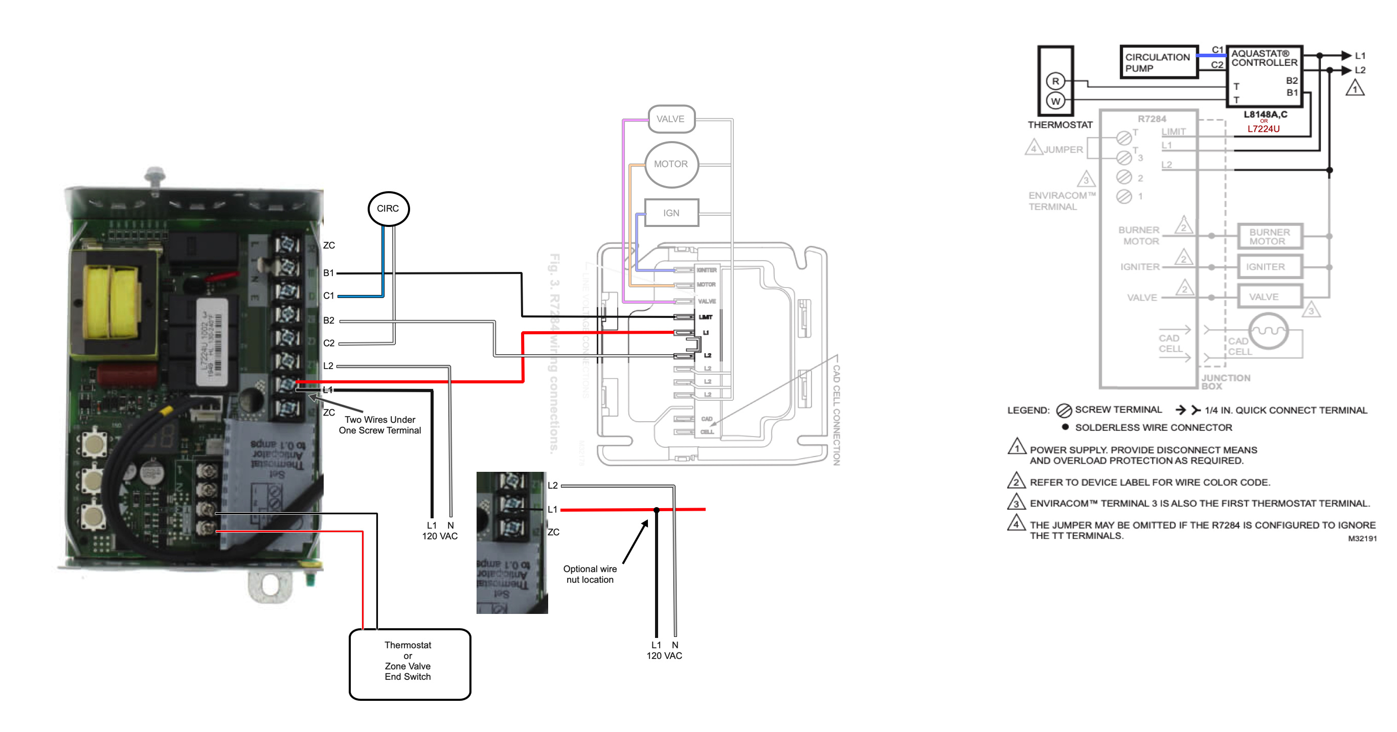

    To get your new, replacement control to operate properly, here is the wiring diagram that you should follow:
    The wires that are in the shaded sections from the Primary Control should be already wired properly. There are three wires from the oil burner primary that go to the L7224U (or L8124C). They are connected to L1, B1, and L2. To properly connect then you may use a wire nut to connect the L1 to the 2 wires that must be connected to L1, or with the L7224U there are square washers that will accept a strait in wire so you can put one wire on the left of the screw and one wire on the right of the screw. That is an acceptable wiring practice when the wire is between the square washer and the terminal surface.

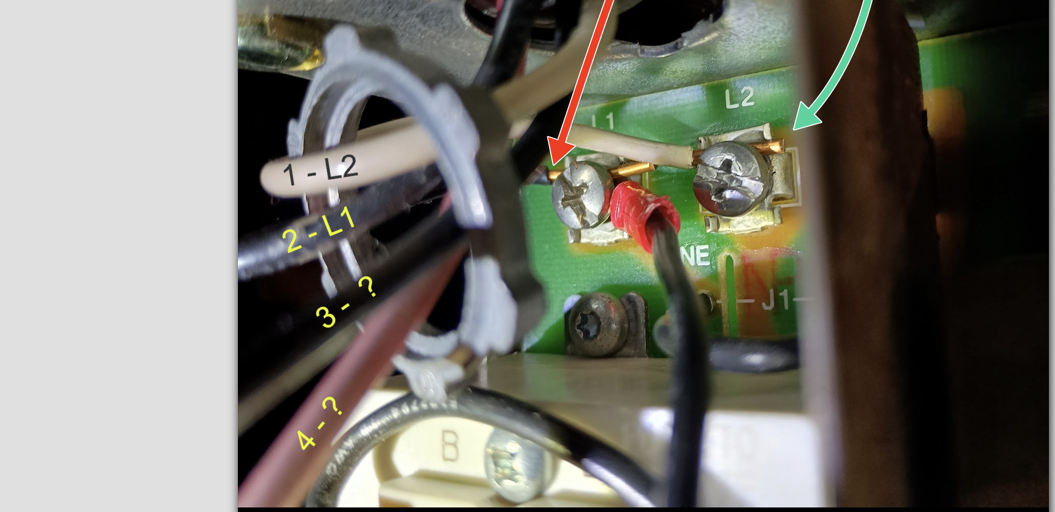

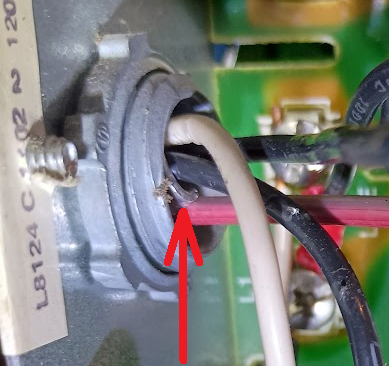

    After looking closely at the photos that you posted I have a question about the 4 wires taht are in the inside the armored cable on the left side of the control.
    I can tell where some of the wires go to and come from. There are 2 wires that puzzle me. I was hoping you can tell me where those other twi wires (labeled 3 and 4) come from and go to. It appears that they just pass thru the L8124C from one connector to another connector without any connection inside the L8124C.
    Are you able to open up the covers at each end of those wires an photograph their connections?
  • WilliamJ
    WilliamJ Posts: 29
    @EdTheHeaterMan
    "I was hoping you can tell me where those other two wires (labeled 3 and 4) come from and go to. It appears that they just pass thru the L8124C from one connector to another connector without any connection inside the L8124C."
    3 is wire nutted to a short red wire with a slide on tab and connects at B1. 4 goes to a wire nut where it is joined with another red wire coming in with the burner romex cable. Neither red wire stops to connect with any terminal inside the box. 4 passes through the L8124C without making a connection. I presume 4 comes from the power venter relay.
    The 3 and 4 wires are both nutted. There are only two nuts in the box.

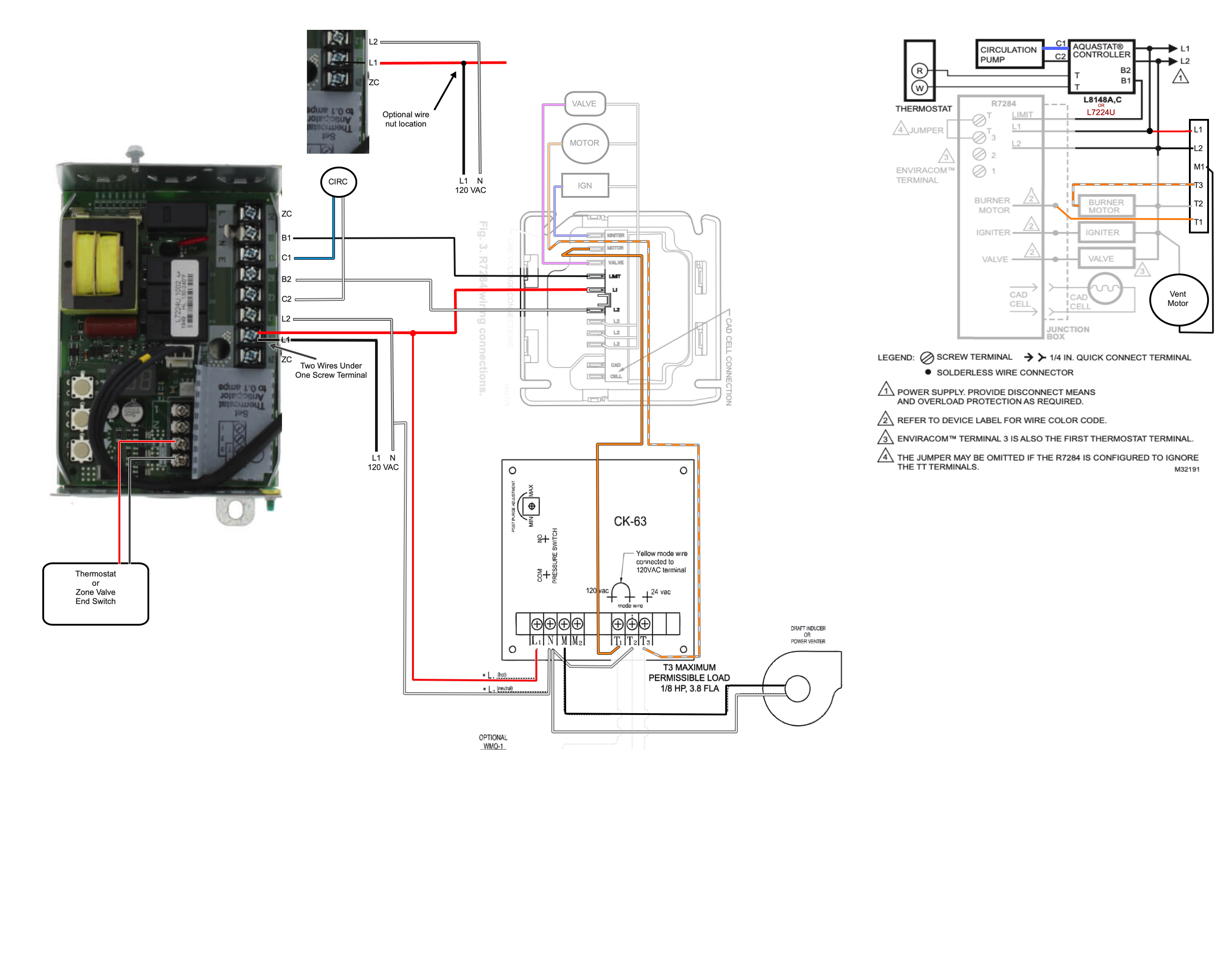

    When you say Power venter relay, art you talking ablut a motorized vent that exhausts out the side of the building? Most of those Burnham boilers are vented into a chimney that requires no additional means of exhaust. The natural draft of a chinmey will create the needed exhaust (suction) without a fan assist.
    This particular additional accessory will make your system wiring diagram a little more complicated and can be confusing to a rookie technician that is unaware, and does not know to look for that accessory. That may be the reason the tech rewired the red wire and said it was unnecessary, when it actually is needed.
    If you have one of those power vent accessories can you tell me the brand name (There are two different brands that are popular) and the model number of the relay box that operates the power vent fan.
    Without knowing the brand of the vent motor or the control kit, I took the libetrty of using the Field Controls CK-63 control kit for oil burner operation. If you have a different control, you can let me know and I will substitute the proper control kit for you.
    This is important that the control kit is installed properly so that the burner motor does not operate unless the venter motor is also operating. If the burner motor can operate without the venter motor operating, then you can get soot to form inside the boiler, vent pipe, and the vent motor assembly. That will be a real mess to clean up so you don't want that to happen.
    After you provide me with the correct control kit and venter motor assembly, you should print the diagram I provide you and place it near the burner for future reference. this will let other future technicians that you have a power vent that must be properly wired and not to bypass any of the safety devices built into the system.

    The issue is with an L8124C, but is that really what it is? I'm seeing the L7224. Why are we still doing this? You don't even need a meter for this one and it's not solved yet. It doesn't look good on my resume. Maybe we should start from the beginning.

    I'm kind of puzzled why a GOOD picture of the wiring of the ACTUAL Aquastat presently installed with the actual issue can can't be achieved. Avoiding where the problem is, is not going to repair anything.
  • WilliamJ
    WilliamJ Posts: 29
    edited May 2025
    @EdTheHeaterMan, @109A_5 Here are some pictures of the new aquastat after I restored the wiring to what it was before the tech snipped the black L1 tap coming from the burner and nutted the stub to the red wires that were passing through from the power vent to the burner. As of right now C1 is disconnected and T-T are connected.
    These 4 pics are from April 18th. https://photos.app.goo.gl/LvWEbsfT9y3YkpVYA
    Later I did some testing with ChatGPTs directions. For one of the tests I connected C1 and I disconnected one of the TT wires then jumped T T with an insulated needle nose pliers. The relay engaged immediately. I also did a couple of other tests. One for Voltage at B1and B2 both when TT is open and again for when it is closed (jumped); I got 120V when TT was jumped. Same results at C1 and C2. Those results were normal, if I'm following correctly. Yet the circulators are running to heat the house with TT open (one wire disconnected) which is not normal and not even explicable.
    The 1K2 relay is new to me and since I can't see it as a physical object in the box, I have a hard time dealing with it in reality. Can it be stuck closed and that's why the circulators are running as if there's a call for heat from T-T? Should I tap it with a screw driver? It is the part of the relay nearest the circuit board, Ed said.
    Ed, here's another quote from my long day testing the aquastat with ChatGPT. If I understand you correctly, you said, the circulators cannot run with T-T open (no call for heat from the thermostat). If I am understanding you correctly, here again, the AI bot is contradicting you:
    "Great question — and yes, manipulating the LO limit dial can absolutely affect the behavior of the circulator, since the L8124C1003 uses the LO setting to control circulator operation independent of the thermostat.
    Here's how it works:
    • When the boiler temp is above the LO setting, and T-T is open, the aquastat may still power the circulator to dump excess heat (called "low limit circulator logic").
    • So if you're only using the boiler for domestic hot water (DHW), you typically do not want the circulator running at all when there's no call for heat from the T-T."
  • WilliamJ
    WilliamJ Posts: 29
    edited May 2025
    This is how I left it on Thursday, May 1st. T-T connected, C1 disconnected. https://photos.app.goo.gl/F45AFXDai7mWrhw19
    I folded a small piece of red electrical tape over the end of the Circulator wire that would otherwise be connected at C1 and I folded a piece of yellow tape over the end of the neutral wire that came in with the t-stat.
    Here is a picture of the T-stat which has been turned "off" since April 14th, so I was later told by the resident: https://photos.app.goo.gl/oWy4n7tAsb9BhuUa6
