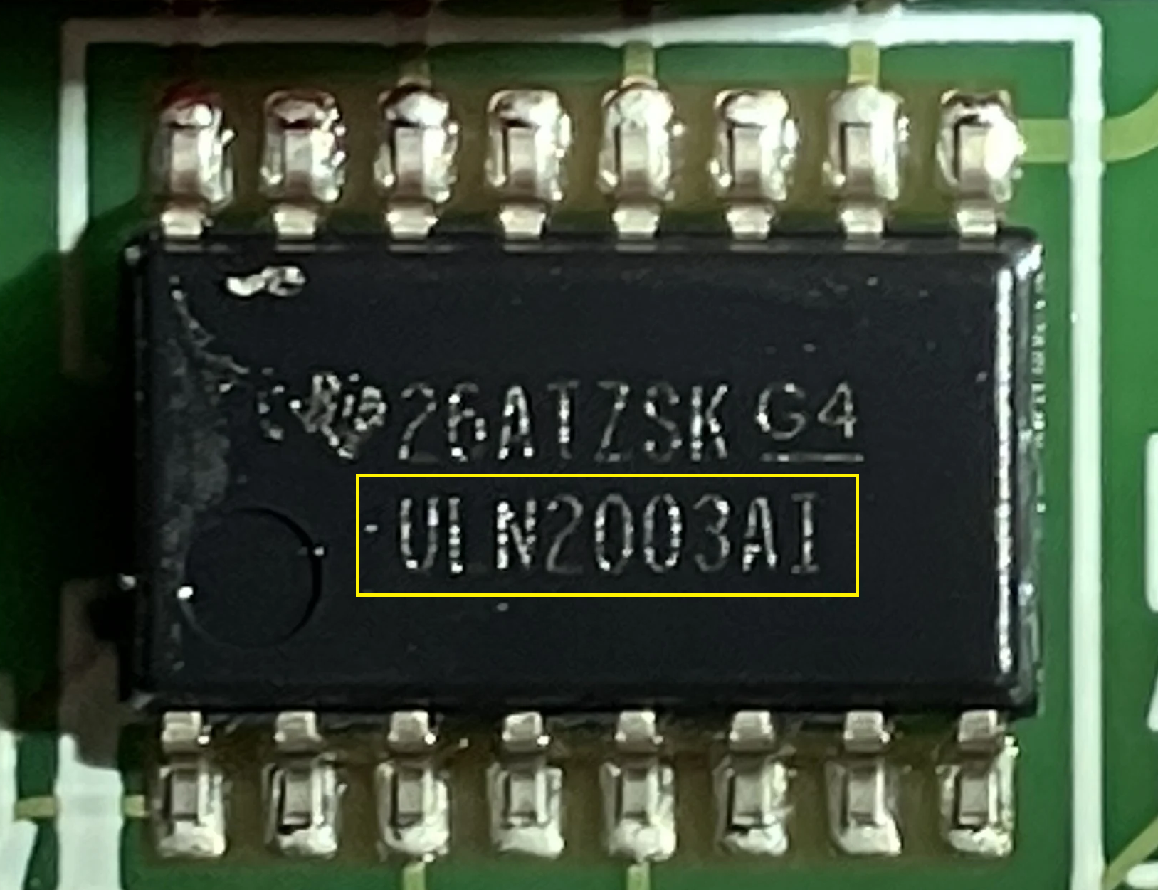

The new board has a blown chip near the LEV connector as shown in the picture. I measured all of the components this time instead of just the compressor and fan motor and the LEV measured open (440MOhm on 2 legs and 24MOhm on the other two). I used a magnet tool to make sure the LEV was not frozen up and it can bottom out and back out fine. I set it to one turn open, which I think is around 40 pulses based on the coil configuration.

    If you knew the Chip number and someone that can do surface mount rework, the chip is probably inexpensive and about a 10 minute or less job to change.
    An example I.C. that is under $5 in single quantities.

    I was unable to read the chip data on either board for IC854.
    Looking closer at the traces, about half of the traces do go to CN724, so that chip is part of the LEV control for sure.

    I was able to get the new LEV coil and board installed and after double checking everything, it fired right up.
    Thank you all for your help. I went ahead and took pictures of the chips in that area of the board in case it is helpful for anyone's future reference. Also, if anybody in the thread wants the old boards to work with for some reason (I assume the inverter section parts are still good), I'd be glad to ship them to you for the cost of postage.

    Looks like this chip is a ULN2003, a 50V 7-ch darlington transistor array, nothing very special there.
    An Op-Amp
    Not sure about the 100 legged Chip. If it is bad and it has embedded code, probably not worth the effort.
    Glad to hear you are up and running !!!
