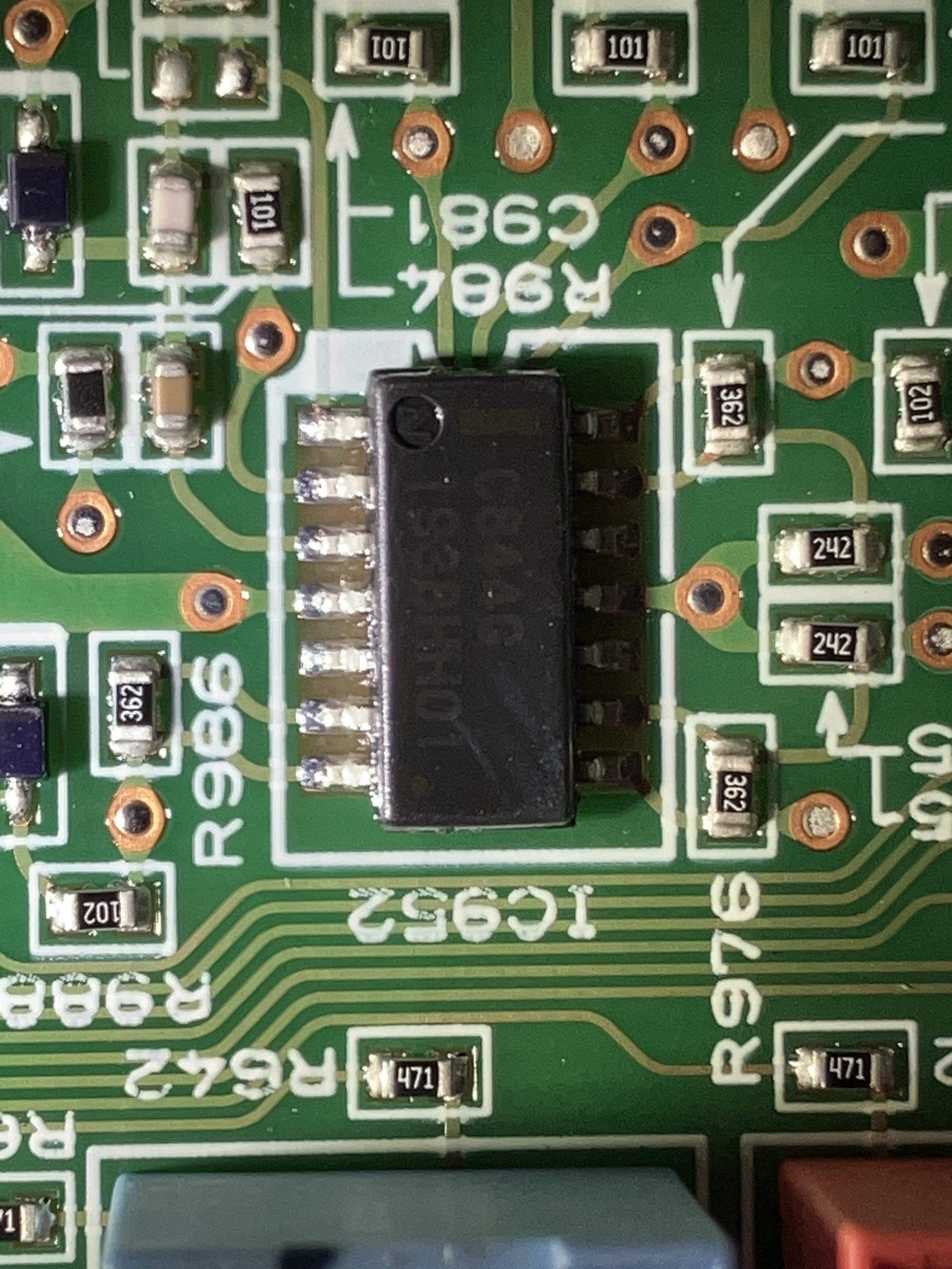

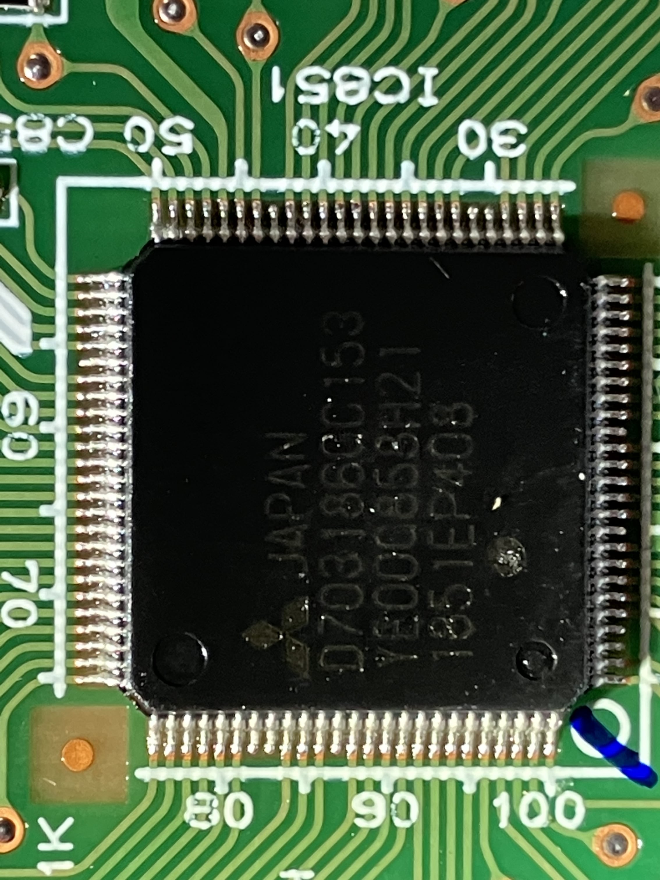

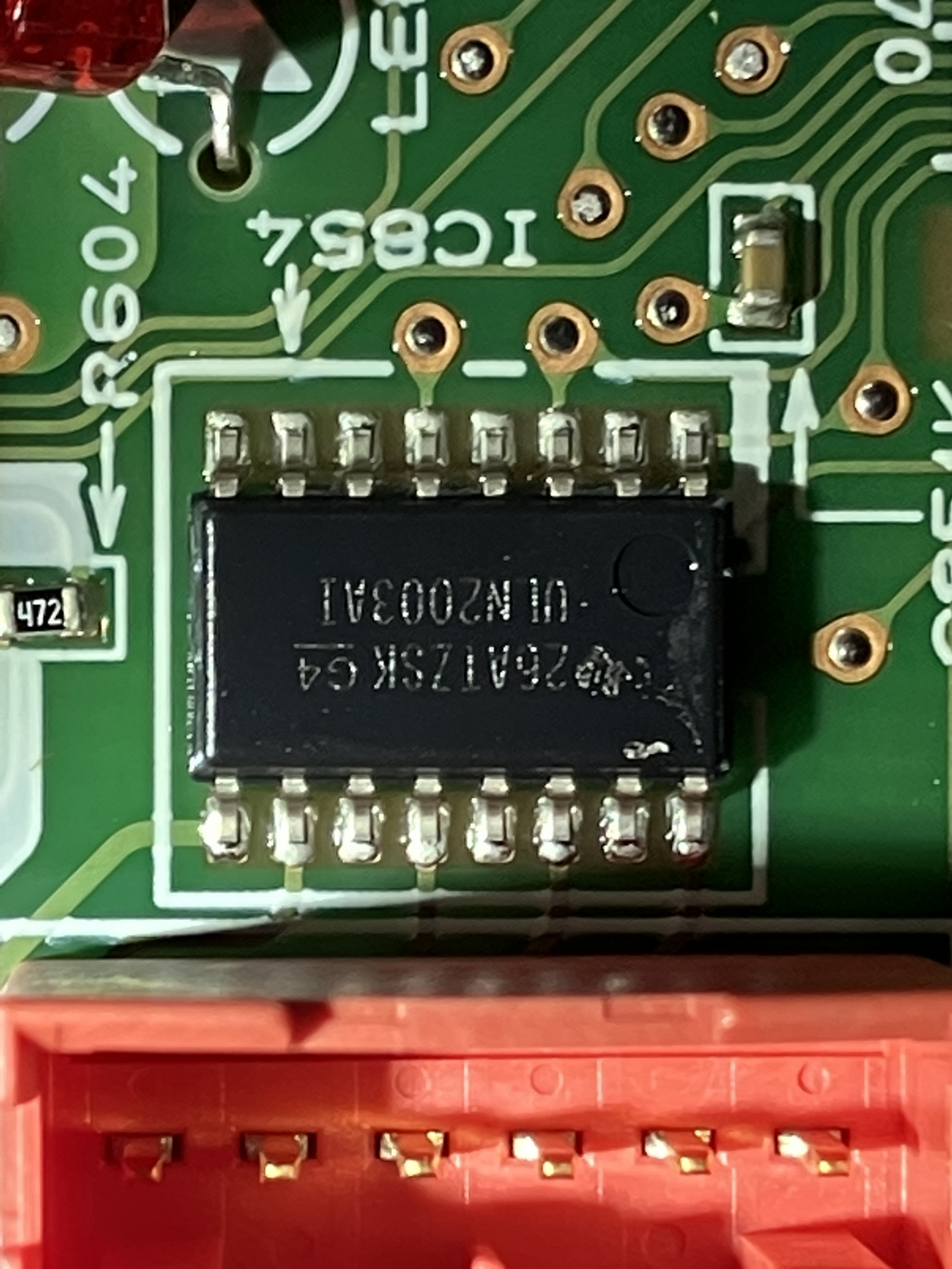

    I was able to get the new LEV coil and board installed and after double checking everything, it fired right up.
    Thank you all for your help. I went ahead and took pictures of the chips in that area of the board in case it is helpful for anyone's future reference. Also, if anybody in the thread wants the old boards to work with for some reason (I assume the inverter section parts are still good), I'd be glad to ship them to you for the cost of postage.
    Thanks again for the help!
    Sandy.
    109A_5 Posts: 4,759
    Looks like this chip is a ULN2003, a 50V 7-ch darlington transistor array, nothing very special there.
    An Op-Amp
    Not sure about the 100 legged Chip. If it is bad and it has embedded code, probably not worth the effort.
    Glad to hear you are up and running !!!
