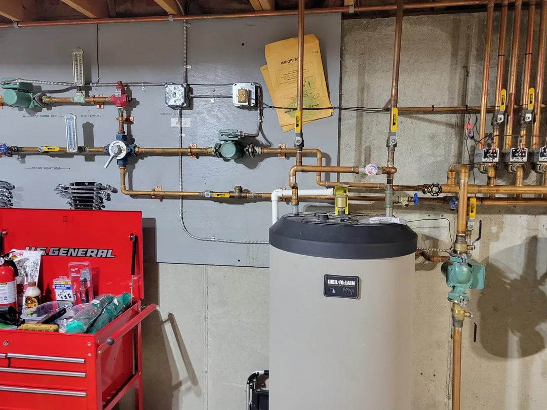

    Is there a water fill valve into the system somewhere? A pic more to the right might help see all the boiler plumbing.
    Basically it takes a ball valve to stop flow from going around the loop, a drain valve next to it.
    Here is an example with a and bucket.
    The closed valve at the boiler forces the water one direction, through the system, back to the purge valve.
    Purging into a bucket of water shows when all the small bubbles stop coming out.

    Ah yes, I do have a water fill valve. See pic. Thank you for the info now should the bleeding be done with the boiler off (cold) and the circulatory off?

    hot_rod Member Posts: 28,010
    if you lift the lever on top of that fill valve, it goes into fast fill position.
    But keep an eye on pressure, it will not stop at 12 psi in fast fill.
    Also sometimes they don’t shut off properly after you use an old fill valve
    Keep an eye on pressure after your final fill. If it creeps up, replace the fill valve.

    mattmia2 Member Posts: 17,757
    What does that mixing valve go to? is there also a radiant loop? That could be more difficult to purge if you got enough air in to it.

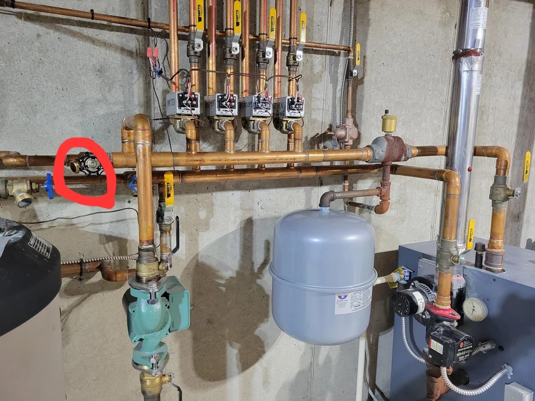

  • LRCCBJ
    LRCCBJ Member Posts: 1,043
    Based upon the photos provided, you can't bleed from the valve that you circled. That's on the supply and all the water you get will come directly from the fill valve. None of it will go into the zones.
    Need to see a photo on the side of the boiler where the return comes down. MAYBE you have the right setup at that location. You need a faucet drain followed by a ball valve before entering the boiler (and after all the returns come down).
    With this setup, you can individually purge each zone and be assured of removing the air.
    you need ot use the boiler drain in the retiur rather than the supplyand close one of the isolation valves at the boiler.
    If you shut off the yellow ball valve above the boiler pump, and purge from the blue handle valve below the black handle I think it works. Hard to tell without some better pics
    There's a boiler drain on the return now circled in green. The drain circled in red is on the same pipe as the prv.
  • LRCCBJ
    edited April 2025
    Good eyes!!
    He does have a ball valve on the return right next to the boiler.
    Here are some better pics. I wasn't too susessful at bleeding it today as I got sort of confused with this radiant portion on the left. I wasn't sure if I should keep those valve open or not? But I was draining it via the blue valve right below the one I circled earlier. Pushing the water through the radiant loop didn't seem to be working too well so I tried it with the circulators on and that seems to push some more micro bubbles out. Unfortunately I still hear quite bubbles in the system but at least the heat works well. I will post up a few pics of what exactly I did in a bit. Thanks
    A microbubble air separator would do a better job of removing the remaining air than that air scoop.
    Is the black plastic cap loose on the automatic air vent so that it can vent air out?
