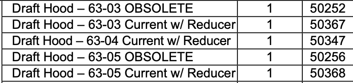

    Hey @mattmich I was looking at some Peerless part lists and did you ever see that they apparently didn't used to use a vent reducer which may explain why mine doesn't seem to have one, but in current (well current as of some months ago before they discontinued the line) models, they have the reducer that apparently you misplaced:
    Didn't they tell you that they had no knowledge of a reducer in their draft hood? It may be that by then they had already let go the engineers or other people who actually know about their now-defunct 63 line
