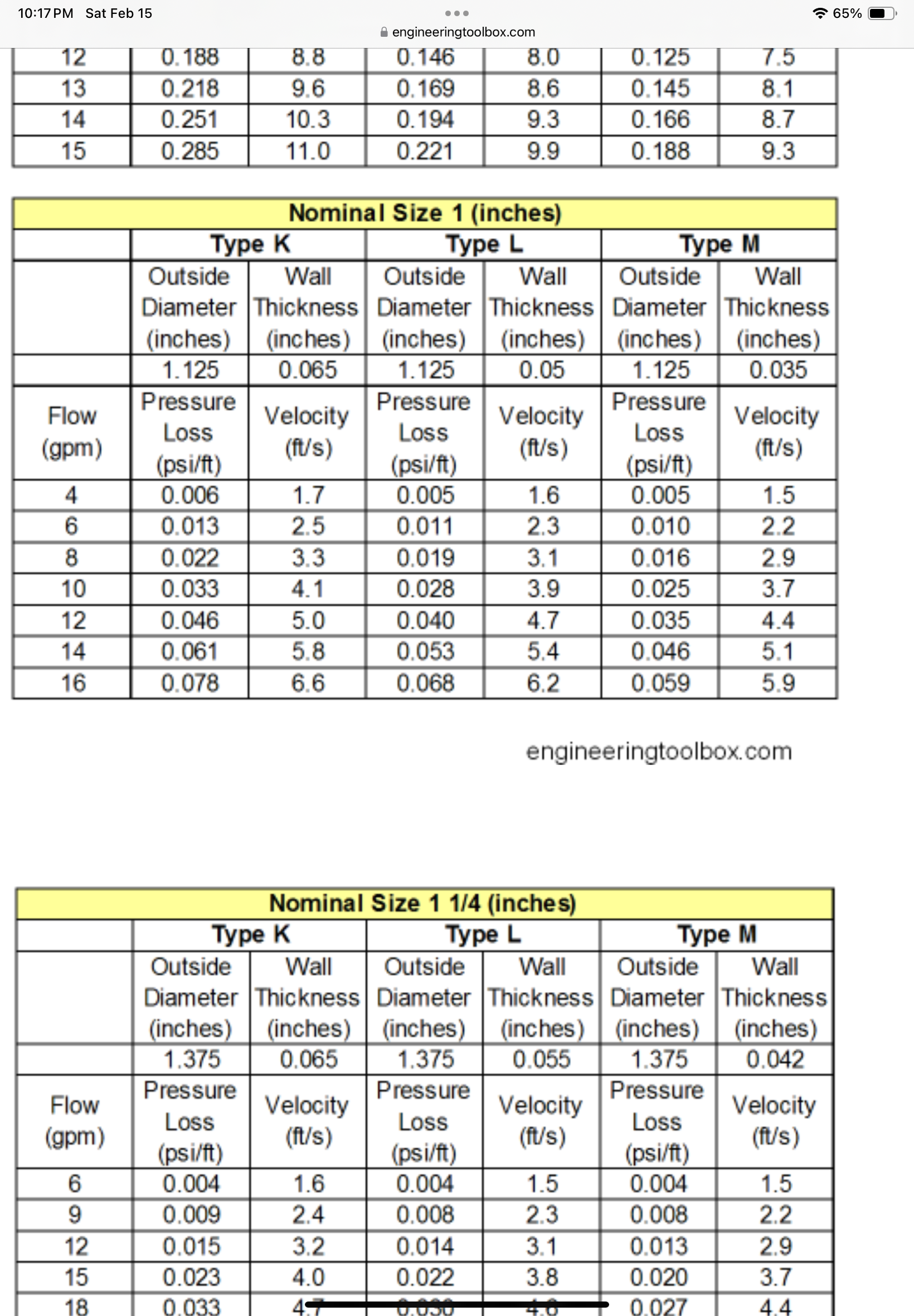

    If the coil in the tank is 1", the benefit of piping 1.25" to and from the tank is minimal. The flow rate through the system is going to be governed by the 1" in the indirect. So what if the 1.25" could possibly flow more. You're not going to get more than the restriction posed by the 1".
    Also, understand that the recovery per hour decreases only slightly with the larger pipe size and greater flow rate.
    As an example, if you flow 10g/minute with 1" piping and the coil temperature drops 20 degrees in the round trip, you have an average water temperature of 170°F in the coil (180°F in and 160°F out).
    Now, use 1.25" piping to and from the indirect and manage to get a flow rate of 12g/minute (recall that the flow rate is largely limited by the 1" coil). The coil output does not change. The coil temperature drops 16.6 degrees in the round trip. Average water temperature of 171.7°F. (180°F in and 163.4 out).
    So, clearly, the benefit of the 1.25 piping is negligible with a 1" coil.

    Take the 1" as an example. Flow at 12 GPM. The pressure drop in 60 feet of 1" (round trip to and from the coil and including the coil) is only 5.5 feet (using Type L). So, it is extremely likely that the system will flow more than the calculated 12 GPM. Even a Taco 007 is going to flow about 15 GPM through that 1" despite your desire to keep the flow rate at about 12 GPM.

    hot_rod Member Posts: 27,416
    you can certainly flow 14 gpm through 1” copper.
    1” copper type M at 14 gpm would be 5.1 fps velocity, a bit high but workable.
    Pressure drop of .046 psi / ft of piping. Your coil and piping length, maybe 30’?
    Going to 1-1/4” lowers the velocity and pressure drop.

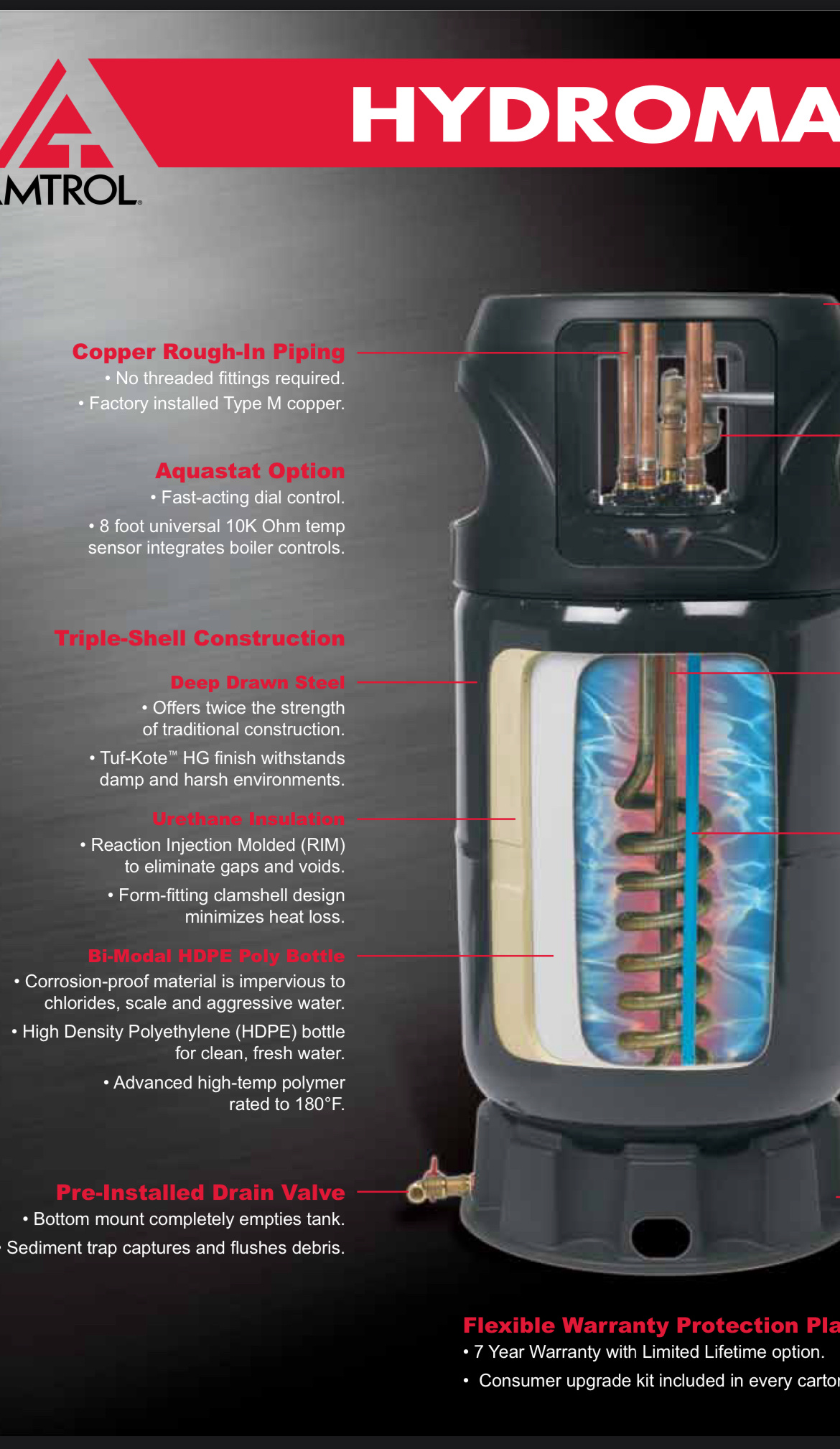

    I have seen composite buffer tanks, who makes a composite indirect?
    looks like a steel tank with a HDPE liner. Similar to a thermal expansion tank and the Pro series Extrol
    Looks a little like the Amtrol BoilerMate?
    Will it last longer than a baked on enamel coating is a steel tank? . Time will tell.
    mattmia2 Member Posts: 16,692
    looks like the steel is the outer jacket and the tank is plastic covered in foam insulation unless i'm reading something wrong. maybe the jacket ultimately ends up supporting it
    It looks a lot like the BoilerMate construction
    The steel tank is the structural component.
    One issue with the steel BoilerMate is condensation formed between the steel tank and the foam insulation. It would rust out that belly seam and you would hear a loud pop as the separated😝
    Looks like the BoilerMate is now stainless.

    yellowdog Member Posts: 293
    @hot_rod I've been around for a long time and just came across my first blown out Boilermate the other day.
    hot_rod
    So does that dump like 30 gallons of water wherever it is or does it just make a noise?
  • yellowdog
    This particular one dumped a lot more than 30 gallons before it was discovered.
