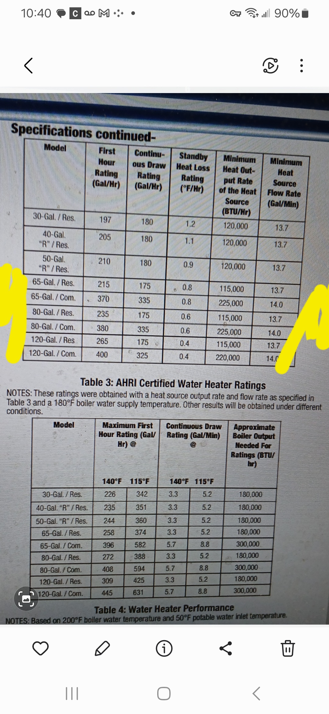

    Joseph_4 Posts: 324

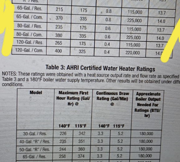

    here is chart from manufacturer. im looking to install the residential model 80 which in reality is 70 gallons hot water. supply and return tappings are 1"
    joe
    hot_rod Posts: 28,699
    What size is the boiler?
    You mentioned recovery rate of indirect is 3X that of a gas fired tank. But this can only be true if the boilers burner size is 3X that of the tank water heater. Until we know the boilers actual DOE output, it is a question that cannot be answered accurately.
    In that graph the minimum boiler size is 115K output. If you have 100- 115K boiler then 10 gpm would be adequate to get the recovery.
    You cannot put into the tank what the boiler cannot provide.

    I appreciate the comments. @LRCCBJ .. The manufacturers charts says with a boiler 115k output at 13.7 flow will deliver those numbers. only way i can get 13.7 on my end is using 1 1/4 . They had to know that their 1" coil with my 1 1/4 piping would deliver the posted recovery otherwise it would be untrue. part of the reason i posted it because Im doing this 17 years and I always try to up my game.. It states no where in instructions to use 1 1/4 pipe. If i want to compare units for my customers i need to know what my costs are. It would seem they have to benefit from 1 1/4.

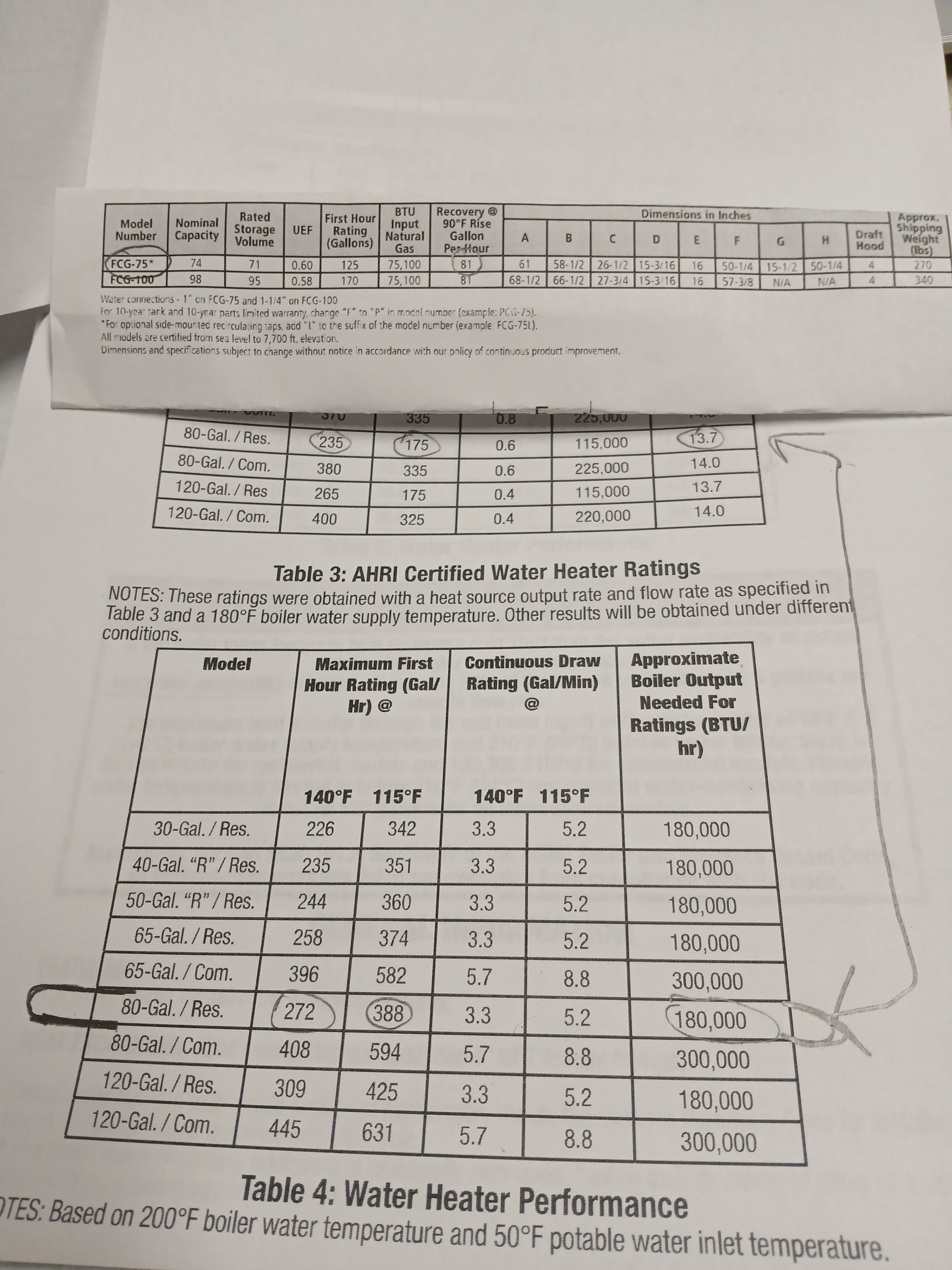

    @Hot Rod. here is the chart from a reputable stand alone water heater and the one im using
    the stand alone is 125 first hour 81 recovery per hour
    my indirect with a 115k output boiler is saying 235 first hour and 175 continuous but for my other customer with 200k output then AHRI chart says 272 first hour im assuming continuous is around 210 per hour.
    Im focusing right now on this indirect but with 200k output there are units like Smart 80 from Triangle tube that will deliver even more.
    thanks
    Joe

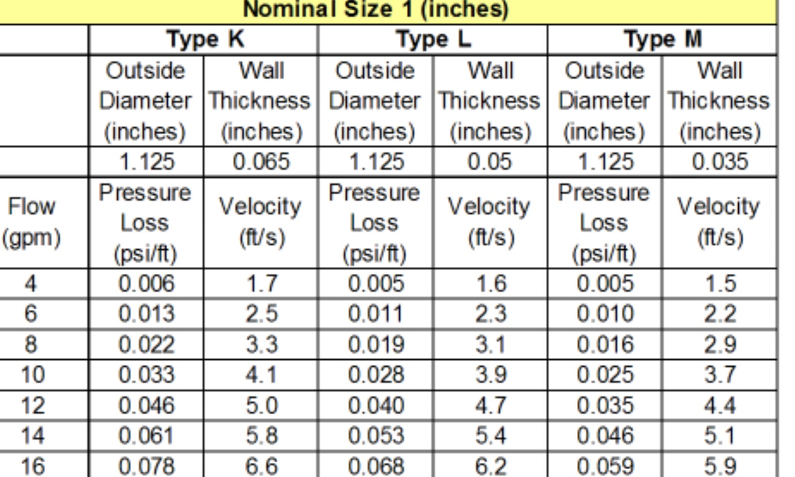

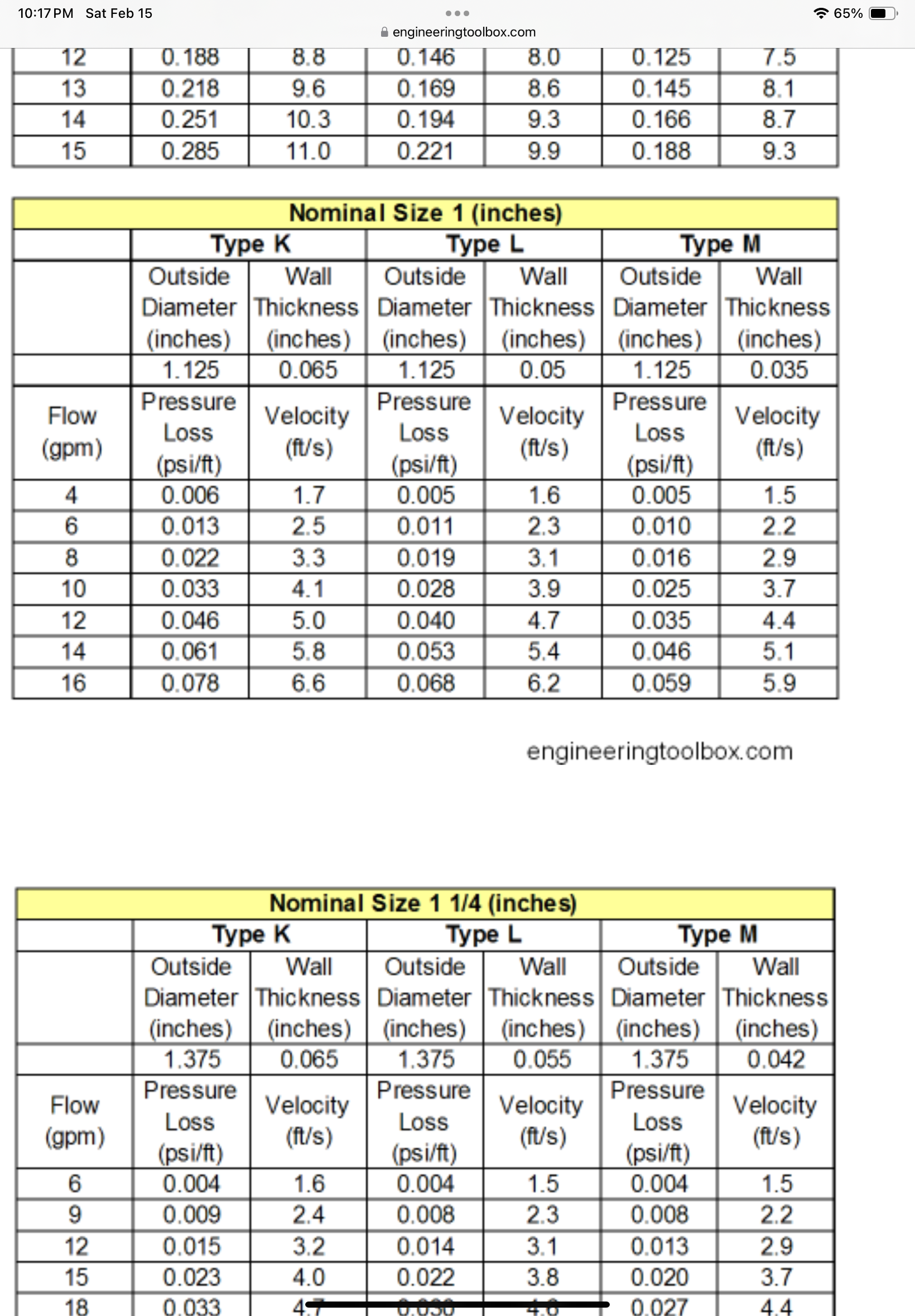

    you can certainly flow 14 gpm through 1” copper.
    1” copper type M at 14 gpm would be 5.1 fps velocity, a bit high but workable.
    Pressure drop of .046 psi / ft of piping. Your coil and piping length, maybe 30’?
    Going to 1-1/4” lowers the velocity and pressure drop.
    Let's look at this more carefully.
    The manufacturer claims that you need 13.7 flow. Does he provide the headloss in the coil at that flow rate? Can we "assume" he has 1" piping in the coil?
    You are focused on the piping between the boiler and the indirect when the piping of the coil itself is EQUALLY IMPORTANT. There might be 25 feet inside that tank. If the manufacturer utilized 1", then the headloss of the 25 feet in the tank, at a flow rate of 14 GPM is only 2.6 feet. If you connect another 25 feet of 1" to and from the boiler and you flow at 14 GPM, the headloss is another 2.6 feet. Any pump you purchase can manage 5.2 feet. So, in fact, you'd flow more than 14 GPM.
    My conclusion is that the manufacturer has no idea how much piping you need to connect to the indirect so he suggests you pipe it with 1.25 to cover himself. The reality, in most situations, is that the 1.25 is complete overkill, buys nothing for the customer, and costs the installer significantly more.
    A manufacturer is classic for posting information that would apply only to the very fringe of operation. 98% of the purchasers are not anywhere near that fringe. So, the information is not applicable TO YOU.
    Also, I want to reiterate what Hot Rod mentioned.
    Let's say you only flow 11 GPM instead of the 13.7 claimed to be required by the manufacturer. The only thing that happens is that the DT in the coil climbs slightly. Instead of a DT of say 20°F, your DT will be 24°F because you are flowing a bit slower. WHO CARES. The recovery time will be ever so slightly longer. There is no customer in the world that would ever realize this.

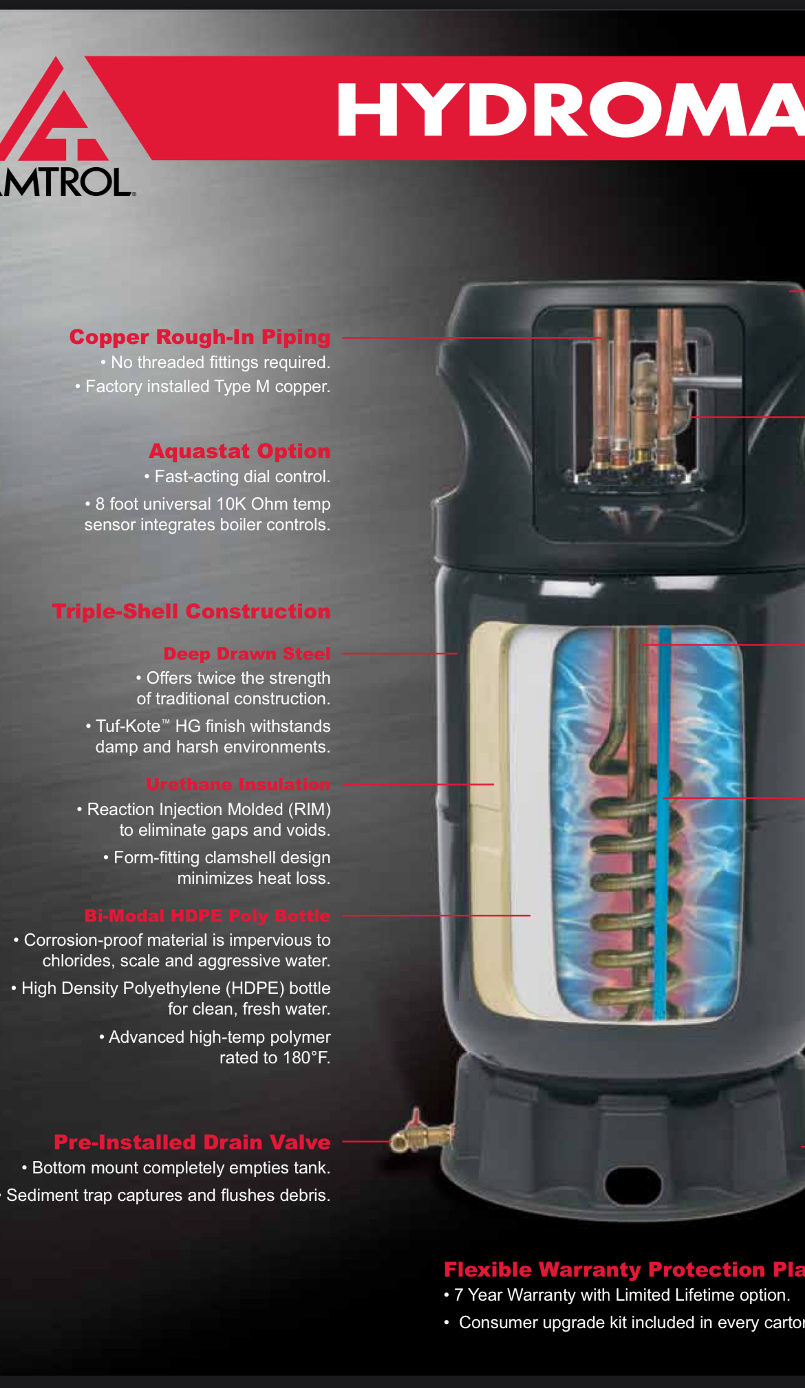

    I have seen composite buffer tanks, who makes a composite indirect?
    looks like a steel tank with a HDPE liner. Similar to a thermal expansion tank and the Pro series Extrol

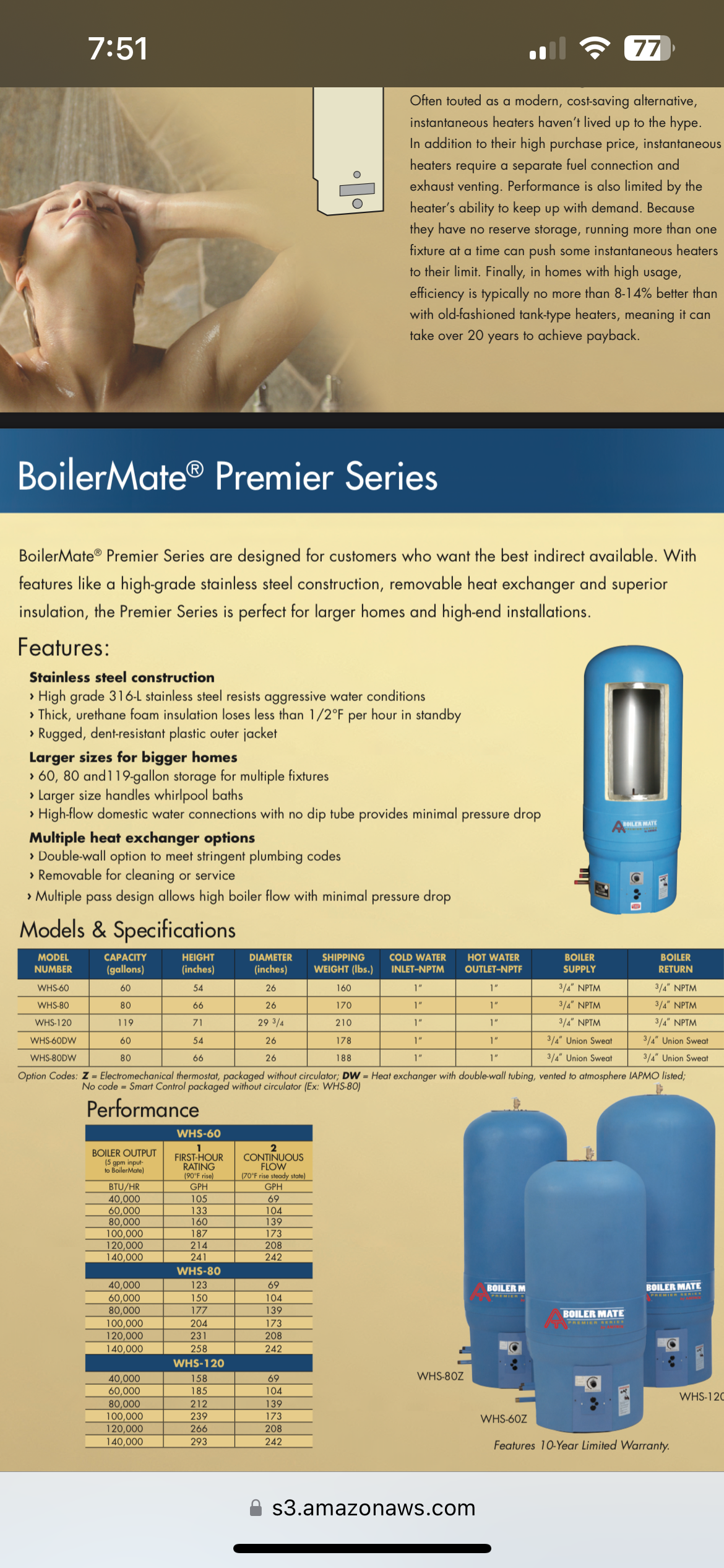

    Looks a little like the Amtrol BoilerMate?
    Will it last longer than a baked on enamel coating is a steel tank? . Time will tell.
    looks like the steel is the outer jacket and the tank is plastic covered in foam insulation unless i'm reading something wrong. maybe the jacket ultimately ends up supporting it
    It looks a lot like the BoilerMate construction
    The steel tank is the structural component.
    One issue with the steel BoilerMate is condensation formed between the steel tank and the foam insulation. It would rust out that belly seam and you would hear a loud pop as the separated😝
    Looks like the BoilerMate is now stainless.
