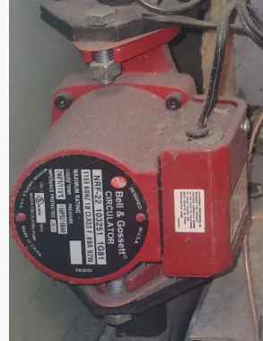

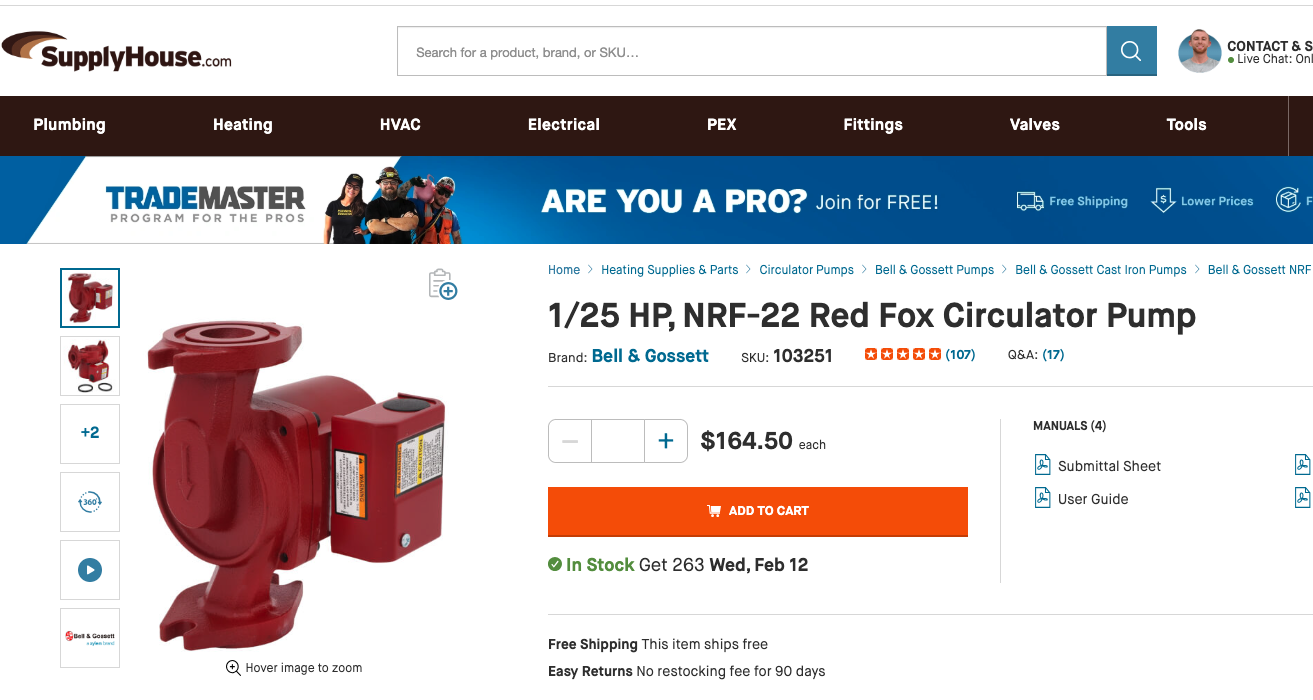

    hot_rod Posts: 28,345
    Looks like it had some pretty ugly water in it before you purged? If so it could mhave destroyed that circulator again.
    Turning off all the red and yellow valves and the fill water should isolate the boiler to pull the pump.
    Check that it is getting 120V when a zone valve is open, first.
    I'd remove the 4 allen bolts and pull the motor out of the pump body to check it. If the boiler gets hot quickly and no zones circulate, the pump is where I would look. Instead of disturbing the bolts and gaskets.
    If it is bad, buy another and just swap the motors out.

    mattmia2 Posts: 18,101
    edited February 2025
    turn it down to 180. it is working most likely but it is set above the boiling point of water at atmospheric pressure at the moment.
    see if there is 120vac to that black zip cord to the circulator on a heat call. it is very possible that it came loose inside the junction box of the circulator, there is a little box on the side of the circulator with a cover held on with some screws. look inside if there is 120v at the terminals in the aquastat relay
    turn the power off before taking the covers off. obviously you have to turn the power on to test for 120v at the circulator connection.
    you can fill it manually with the fast fill lever until we figure out the circulator, unless it is just air bound. we can figure out the pressure reducing valve setting later.
