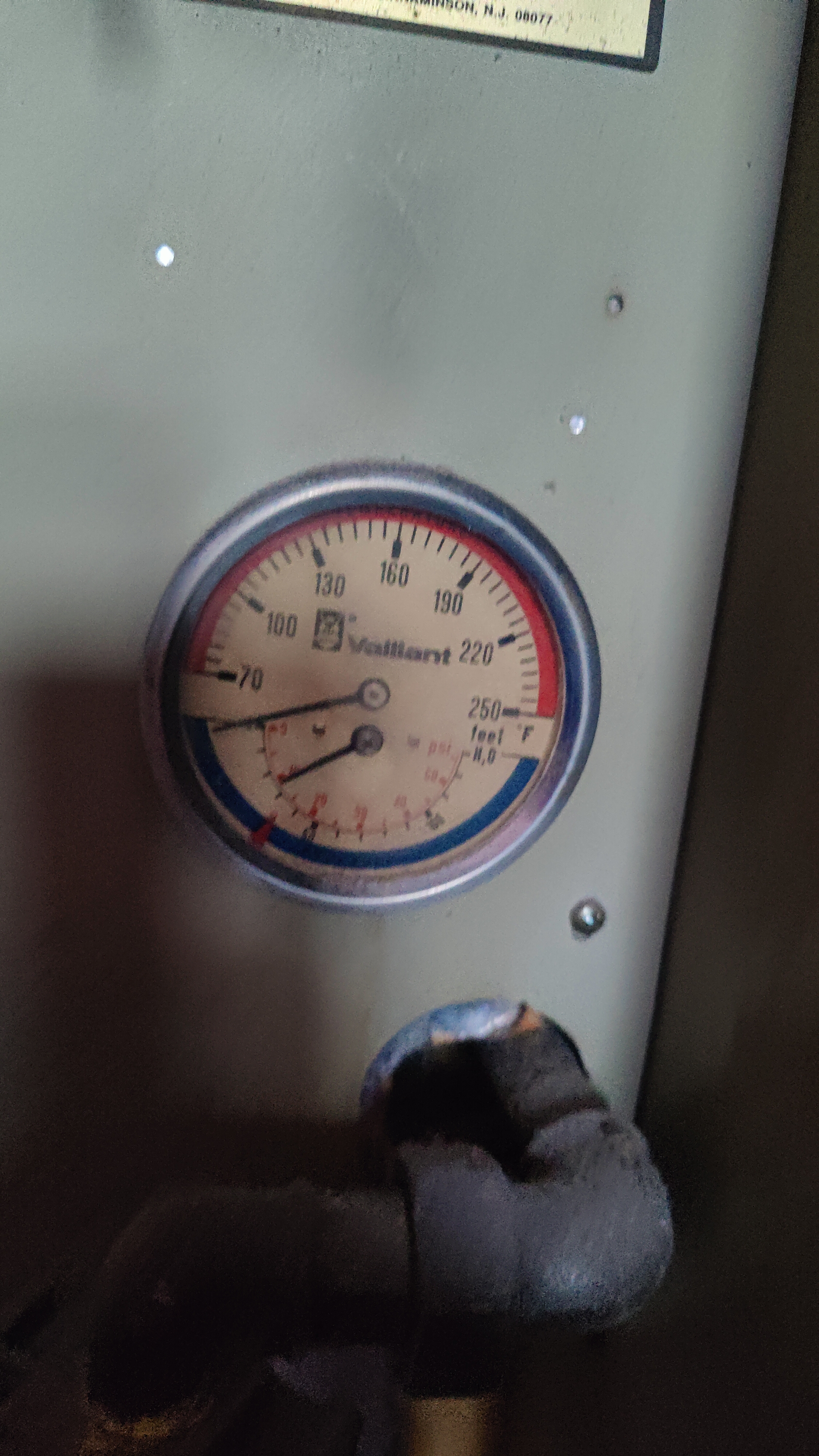

    I'm still confused by the expansion tank pressure info I was given. I definitely feel like something I did was wrong when trying to follow those directions. The way I interpreted The info that I was given is I was supposed to turn off the main water supply line that feeds into the automatic fill valve. After doing that I use the pressure release valve to drain enough water from the boiler to get the pressure down to about 6 PSI. From there I check the pressure of the expansion tank and either increase by adding air or decreased by taking air out of the expansion tank to get it to around 12 PSI. Now when I repressurize the system by opening up the main water line and manually open up the fill valve lever get the boiler back up to 12 PSI both the boiler and the expansion tank should read 12 PSI. I'm not understanding how that's possible if I'm adding pressure back to the boiler wouldn't the entire system have that pressure built up as well? So therefore if I'm going from 6 to 12 obviously I'm adding 6 PSI to the system, so wouldn't that add 6 PSI more to the expansion tank as well? I feel like maybe I'm not closing something off correctly when I'm doing this. As I previously mentioned, I realized my thermometer pressure gauge is not functioning correctly, I have to go over and tap on it to get the pressure to move.
    Something else that I'm not fully comprehending either is when I go to look up how to adjust the expansion tank pressure everybody is saying that you have to match the pressure of the expansion tank to the pressure of your water in the house. In order to do that you got to get one of those pressure gauges that you screw on to an outdoor faucet turn it on and see where your pressure's at. But let's say my pressure is at 50 or 60, my expansion tank information says that it's supposed to be 12 PSI and it can go to a maximum of 60 so I'm not entirely or what to do with that information that I looked up saying that the expansion tank has to be pressurized to the same pressure as your house water pressure.
    I hope you all can see how I'm confused by all this because I feel like everything I'm saying right now is probably confusing you lol.
    I really want to try to get The boiler fired back up so I can test the voltage in the aqua staff but I'm afraid to turn it on before I get the pressure right, Don't want to further damage something or have the to release valve blow back open and then I got more water all over the floor coming through my ceiling because I'm not sure exactly how much is going to blow and I'm sure it's not going to be a little bucket worth like I currently have under the pipe.
    Something else that I thought of is when I'm adding the pressure back to the boiler and it's increasing the pressure in the expansion tank, why can I not just decrease a little bit of pressure to get it to match the boiler pressure?

    you're confusing 2 different tanks, heating, and domestic,
    heating system wants to be set at 12 psi air, then take your heating system water pressure back up to the 12 psi fill, it shouldn't take much water unless you have air in the system also,
    you asked how adding 6 water doesn't add to your 12 air, well 12 air is stronger than 6 water, so it stands its ground, when your cold fill 12 water heats up it expands, and THEN it will push on the 12 air, and sinse the air is compressable, the air psi increases(and water will some too),
    set you air to 12, add water to 12, and let it fly,
    that tank in your picture is a domestic hot tank, so it's air pressure needs to match or slightly exceed your well or street pressure coming into the house, then when the domestic water heats up and needs a place to expand to, that tank takes that expansion,
    I think the pictured tank is on your heating system, and that's ok, set the air to 12, and add heating water pressure back up to 12, let it fly,

    I think the tank you see in the picture above is actually connected to his heating system right below the air scoop. I assume whoever installed his boiler went with this compact tank because of the limited space behind the boiler to the floor and didn't think to put in an extension to move the tank out a little more remote from that spot.
    The_Comedian
  • PeteA
    PeteA Posts: 328
    @The_Comedian
    Like @neilc did say, there are 2 different types of expansion tanks you can find in a house, one could be on a plumbing and the other on a heating system. But they are pressurized and slightly different in different ways.
    The one you find on your hot water system is made for potable water and will clearly say so on the tank. This one is usually located somewhere near your hot water heater and is pressurized to match your city incoming water pressure (could be 60 to 100psi) all depends on what's coming in past your water meter.
    The one you find on the boiler system is made for heating systems, closed loop etc it will say NOT for pot-able water typically right on the box. This one is pressurized to 12-15psi.
    either one of these tanks when you have them pre-pressurized right once the water comes on should equalize 12-15lbs in the heating system should still read 12-15lbs in the tank, same with the domestic hot water expansion tank, when the city water fills up and equalizes it should be close to the 60-100lb range that you pre-charged the tank with. Its when the systems are heating up that's when the magic happens and the expanding water heats and compresses the air in the tank the air pocket gives the water some space to move in to and once it starts to cool the air bladder pushes that water back out and equalizes the system again. That cushion of air is what keeps the water from expanding so much that it does blow out the pressure relief valve every heating cycle and cause the system to have to refill the lost water every time it cools.
    So in your case like @neilc said you just let your system cool down. just drain out enough water in your system so the gauge on your boiler reads just above 0 pounds. Check your red tank and if its below 12 pounds pump it up to 12 pounds. Once its at 12 pounds check the gauge on your boiler it should have climbed up from 0 psi. If its at at 12 or below 12 no big deal just turn your auto feeder back on and it should fill a little until it stops at 12-15 psi and you're good to go on the boiler side. Now you just need to go around and purge any air that you think you may have in your heating system. But that's a whole other thread.

  • I have followed these directions and I'm still winding up with a higher pressure in my expansion tank. I just did everything again, turned the main water line going into the automatic valve filler off, lower the pressure by opening up the pressure release valve enough to drop it to just a little bit above zero. From there I checked the expansion tank pressure I was at about 2 1/2 PSI, I added air to get it back up to 12 PSI. After doing that I opened up the main water valve and manually added water back into the boiler until I reached 12 psi. Went back to measure the expansion tank and it was at 17 1/2 PSI.

    Comedian says, "From there I checked the expansion tank pressure I was at about 2 1/2 PSI, I added air to get it back up to 12 PSI."
    what's going on here? when you found the air at 2.5psi , , , hadn't you aired up to 12 previously? that tank may be bad and leaking air, it should not have dropped to 2.5, unless you had been checking air after the fact and let it all out, DON"T DO THAT,
    set the air to 12, bring the water back up to 12, DON"T CHECK AIR again, unless you start blowing off the relief valve, and suspect , , , but is that tank down to 2.5 cuz it's leaking, or did you let it all out checking?

    you have to check that the system pressure is at 0 psig, not 12 psig after you add air to the tank. if the tank is waterlogged which it probably is, adding aur will push water out of the tank and build pressure in the system. how critical this is depends on how much volume is in the system. if it is close to what that tank can handle then you need to do the precharge correctly.

    As of yesterday, I did what a member on here told me to do, just let it fly. The system was started back up. Everything is functioning it called for heat opened up the right zone valves I have the upstairs zone working and the downstairs zone. Just an FYI I have the main zone which is my first floor, I do not have a basement, That is the floor that this entire issue started with. And then the upstairs is obviously zone 2. I kept an eye on everything as it was heating up and since yesterday late afternoon I have not had an issue like I was having. It's heating up the pipes perfectly fine turning on and off when it should. I have checked the temperature repeatedly to ensure that it's not getting too hot. I did reset the aquistat as I stated before the previous homeowner had it set to 230° I knocked down to 180°. My pressure with the system up and running is right at about 20 to 22 PSI. And the temperature is averaging about 160° when the boiler is up and pushing heat to either zone or both. With that being said as I was typing this up it does look like my boiler right now is at about 173° and the pressure is reading slightly under 20 probably about 19 psi. Also just gave that temperature pressure gauge a little tap and it jumped closer to 180 degrees. I'm fully aware of that that temperature pressure gauge is also going to have to be replaced I'm just hoping to make it through the next month or two and then I'll try to address a lot of these issues that you guys have made me aware of and I've also become aware of myself through this process.
    One thing I did notice that I'm also going to have to do when the system is cooled down whenever I do this work to it. It seems like my automatic fill valve either needs to be recalibrated or It has gone bad. I am assuming giving the name, automatic fill valve, and the fact that on the label it says It's set to 12 PSI that when that boiler goes below 12 psi it should automatically be adding that what are back into the system until it detects 12 PSI. Whenever I would turn that main valve back on after having the system pressure down to zero I had to manually add the water back by flipping that lever up. Am I defense I had no clue how that component worked entirely until I did a little bit more research after realizing that yesterday and the system was already fired back up. I did not know that that cap on the top unscrews You can loosen the locking nut and then adjust the pressure accordingly using a flathead screwdriver.
