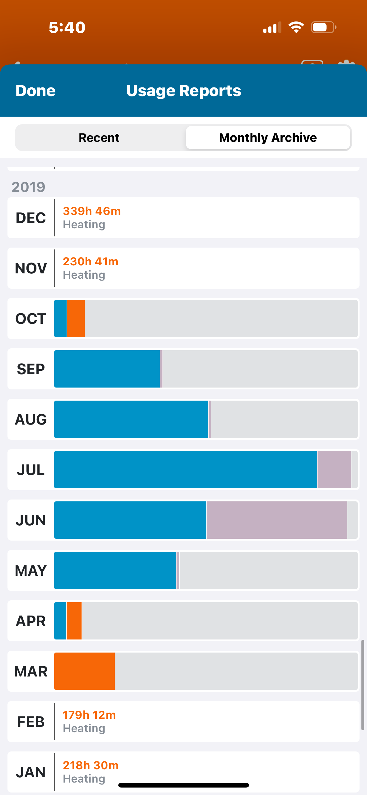

  • charliechicago
    charliechicago Member Posts: 188

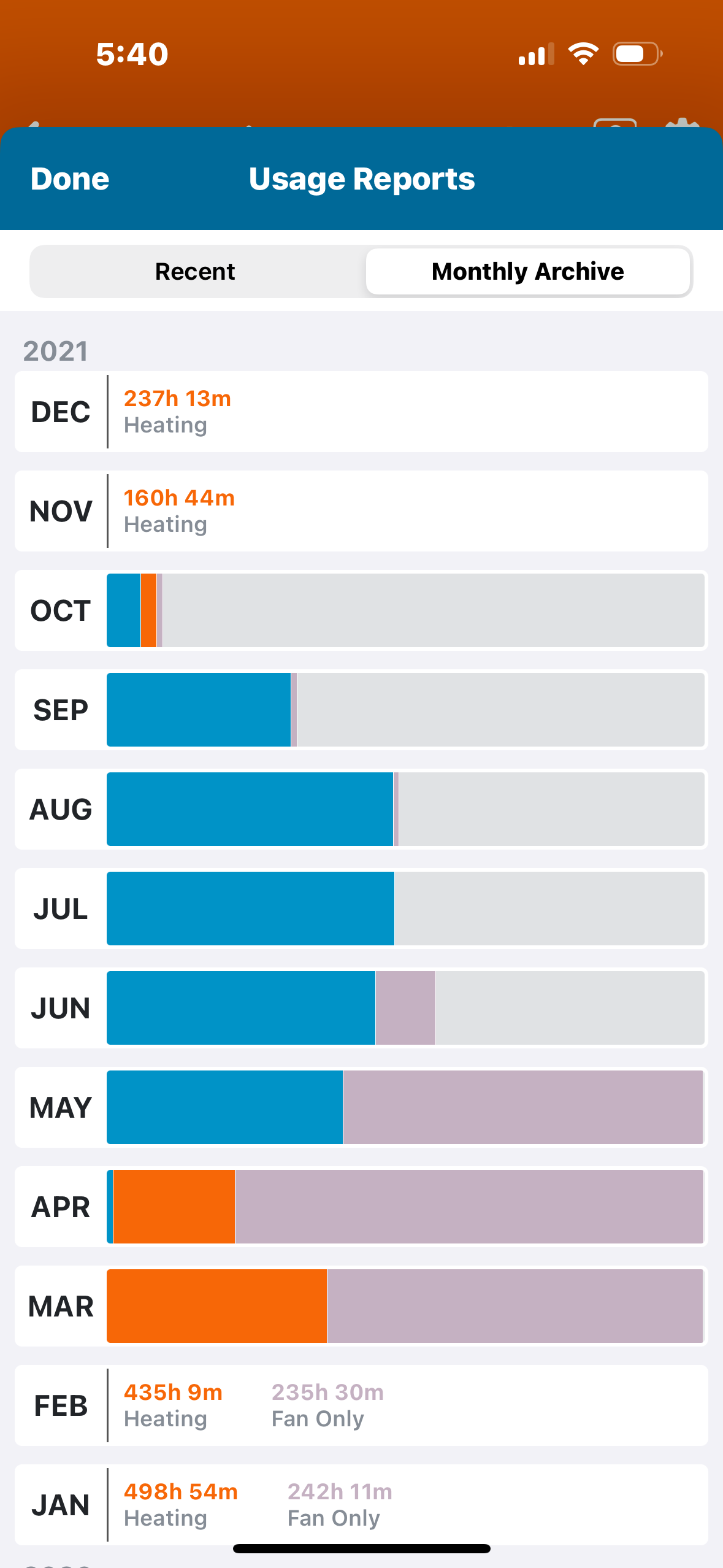

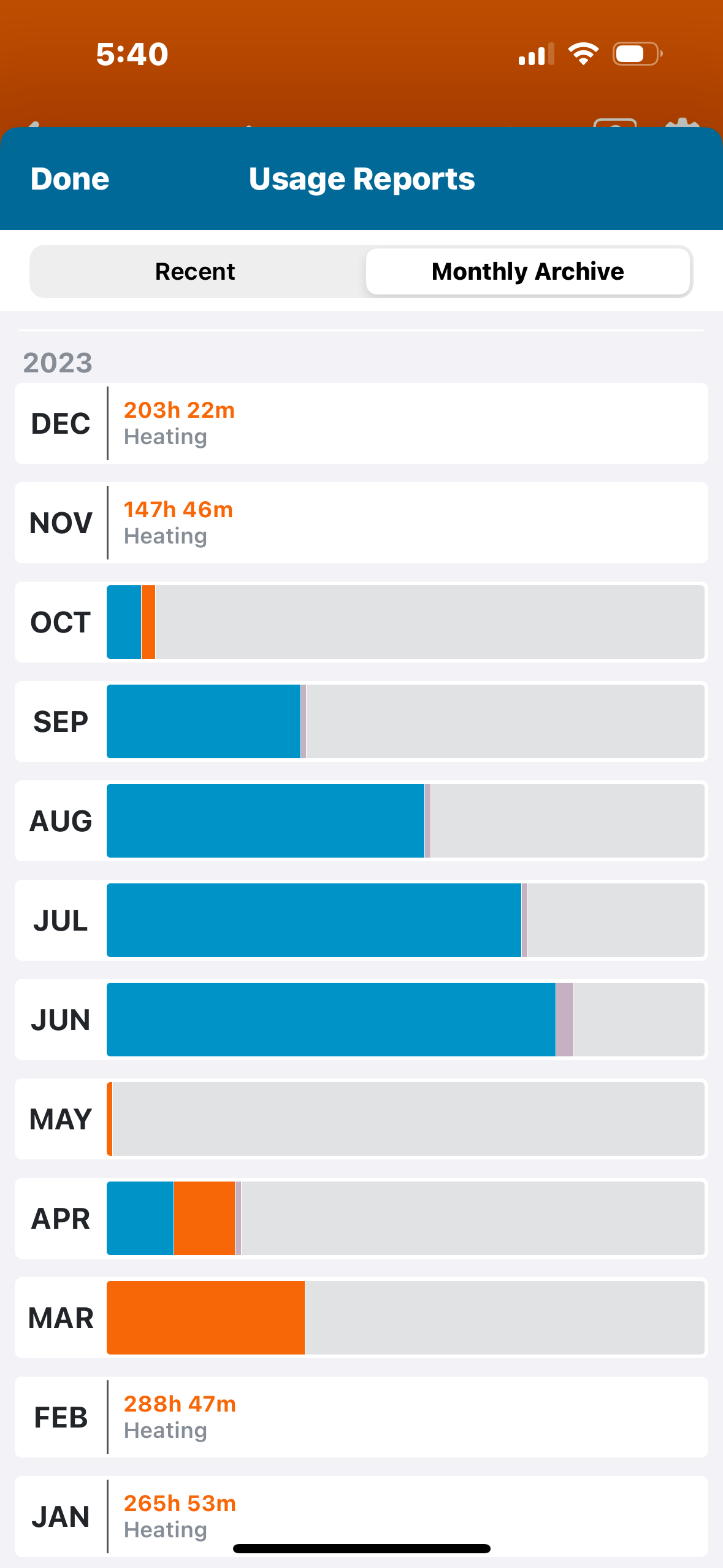

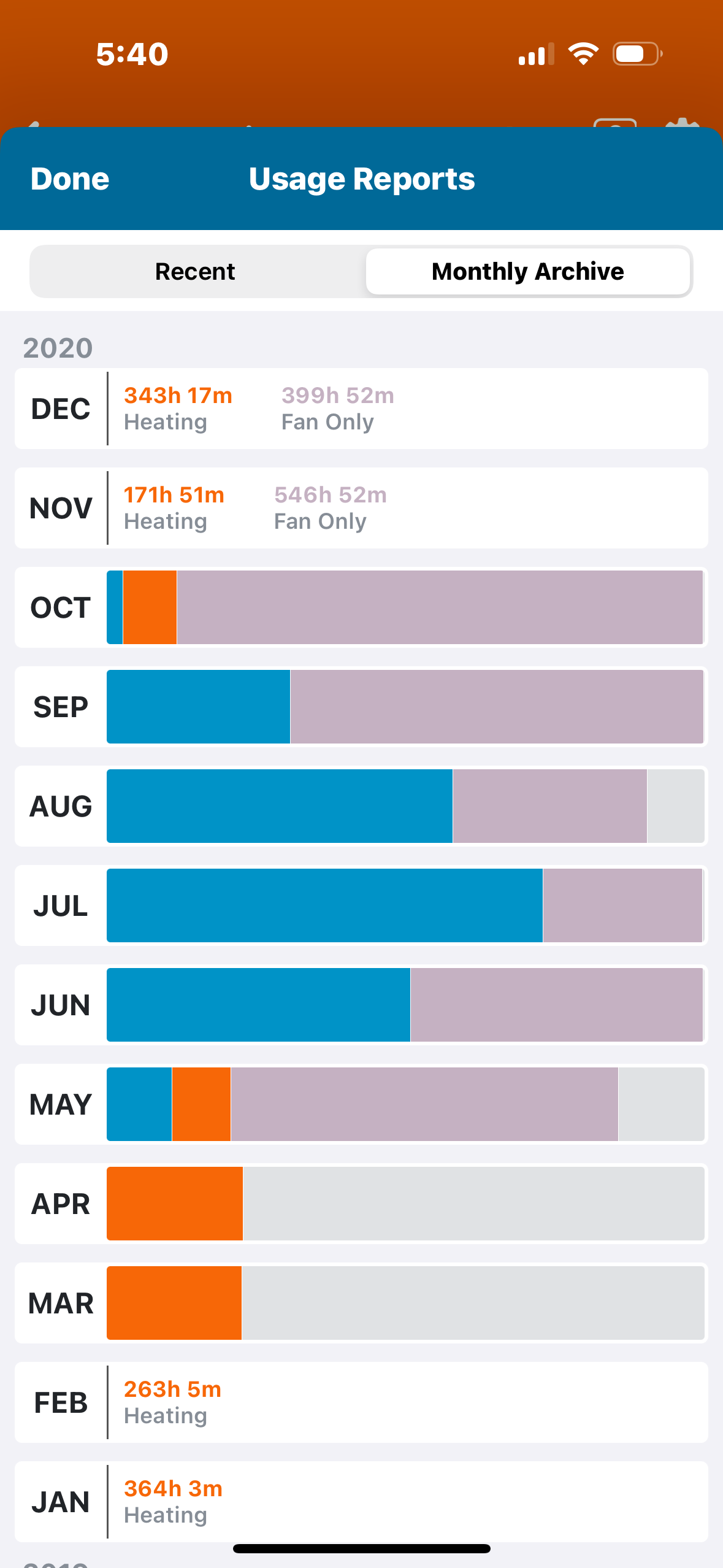

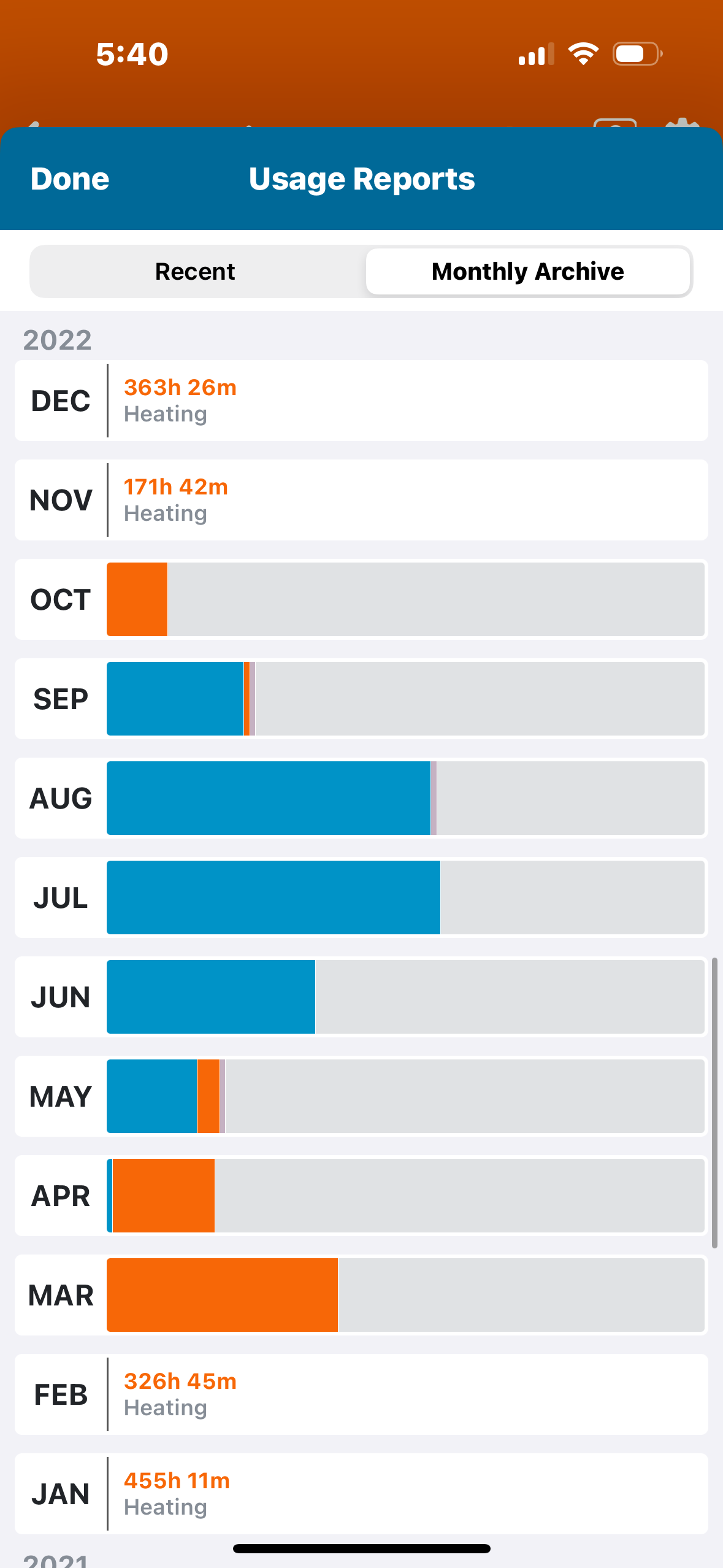

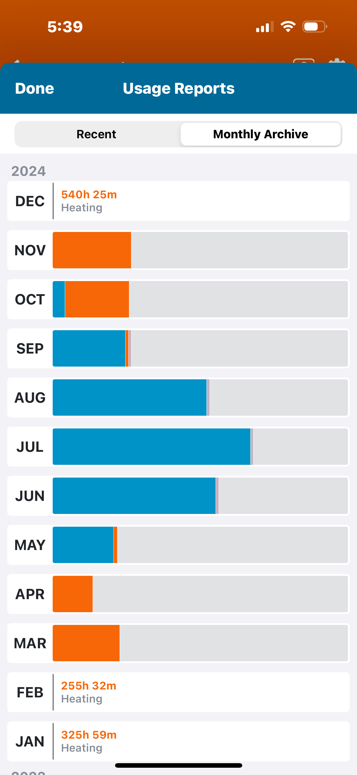

    Bottom picture is most recent. As you can see the usage is way high.

  • PeteA
    PeteA Member Posts: 328
    edited January 2025
    the numbers in late 2021 into 2022 were pretty high over a couple of months on the charts, so is it possible this is just a longer colder spell?
