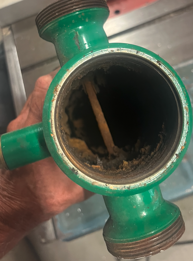

    hot_rod Member Posts: 27,561
    edited October 2024
    After 18 months on a non barrier, high temperature rubber staple up, this is what the sep looked like. It had an Axiom fill tank, so it was not getting fresh water added. This job has gone through multiple boilers, expansion tanks, circulator, and contractors.
    Finally it got a plat HX separation with non ferrous components on the tubing side.
