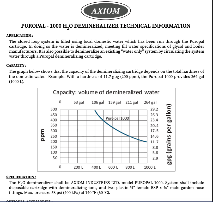

  • jeff4444
    jeff4444 Member Posts: 37
    edited March 15
    I see there are now a number of Air to water HPs available including Mitsubishi.
    I have a radiant floor heat system (staple up) and low temp baseboards that operate well with a max HWS temp of about 130. This is now within the range of some of these HPs.
    My remaining issue is water quality. Some iron in the water and ph 6. Also the radiant tubing is effective but has no O2 barrier. With water like this, a plate Heat Exchanger in the HP is going to clog up quickly. I may be able to fill the closed loop with pristine water and even keep topping it up with same. If I can do that, is the lack of an O2 barrier going to still cause problems for the plate to plate Heat Exchangers?
    If so, are there some HPs that use a coaxial or other more forgiving Heat Exchanger?
    Any recommendations of how to proceed? BTW probably need 32 - 40K heat at design temp.
    hot_rod Member Posts: 27,419
    With non barrier tube it is a good idea to use a hydronic conditioner, check and boost it as needed. Fernox has the fluid plus the test kit.
    The Fernox handles the O2 that enters with an oxygen scavenger component. But it gets depleted over time.
    The Mitsubishi ECODAN is a system that is not yet in the US, supposed to be a good high temperature version, it is a split system.
    Ideally all hydronic systems would get cleaned first, with a hydronic detergent.
    Then good water, good water as in low hardness below 7 gpg, low TDS, low chlorides neutral ph. DI, RO or distilled water would be best. Which you can buy or make on site with an Axiom DI cartridge filter.
    Then and only then add the conditioner F1 or others.
    The conditioners prefer good water. Or else you use up the inhibitors the first day fixing bad water.
    The test kit tells you what condition your conditioners are in.
    If you can get the system to operate on a design day with 120or so AWT. And run ODR, you will be in good COP most of the heating season. Most areas are at design less than 10% of the year

  • jeff4444
    thanks Bob, that is is very helpful.
    So we would clean the whole system with detergent, get out as much crap as possible.
    Then run better water through it to flush it out as much as possible.
    Then remove all that water and put in clean, purchased water, then treat that water with F1 or similar. TEST.
    Ideally, then we would have some way of adding the small amounts of required make up water from a small tank of clean water as well. Then keep testing annually or on some schedule.

    BTW could I have a significant amount of water stored in a large expansion tank that could be my reserve to add more clean water as needed? This could expensive feeder tank.
    If so, how much water might be stored here —more than one or 2 gallons?
    After a few days to a week of operation at the highest operating temperature, with a good microbubble air purger, the system should not need more fill water.
    A small #30 expansion tank can hold about 4 additional gallons for a back up, if you don't want to invest in a fill tank. Pressurize the tank to 30 psi, add a fill valve set to the desired fill pressure.

  • jeff4444
    One last question – if I’m going to fill my hydronic system with clean water, should I be using spring water that comes in 5 gallon jugs or something else? Any ideas would be appreciated.
  • bjohnhy
    bjohnhy Member Posts: 203
    @hot_rod outlined it well above. I would go with distilled water for your final filling of the system. Although the spring water could be good water relative to some city supply, go with distilled if your going through that effort.

    yes, I guess I didn’t know what DI or RO water were! For instance, has RO water been run through reverse osmosis?
    Problem is my starting water is much worse than regular city tapwater. So bottled spring or filtered water would be a big improvement.
    My water has iron and other minerals like manganese and a pH of about 6.
    If it were distilled water, that would be a lot of distilled water as I have a 50 gallon tank in the system as well as the piping and radiant tube.
    Probably the easiest way is to filter the water on site. This cartridge does about 264 gallons. Depending on how bad the water is.
    This is a DM demineralizer cartridge, it has a one use resin inside. RO uses a small membrane to filter out water. Distilled water is boiled, the condensate collected on a stainless plate.
    You end upo with about the same purity regardless of the method. RO and Distillitation is a slower process.
    That should be plenty to fill most systems.
    Screenshot 2026-03-21 at 5.03.06 PM.png Screenshot 2026-03-21 at 5.03.33 PM.png
