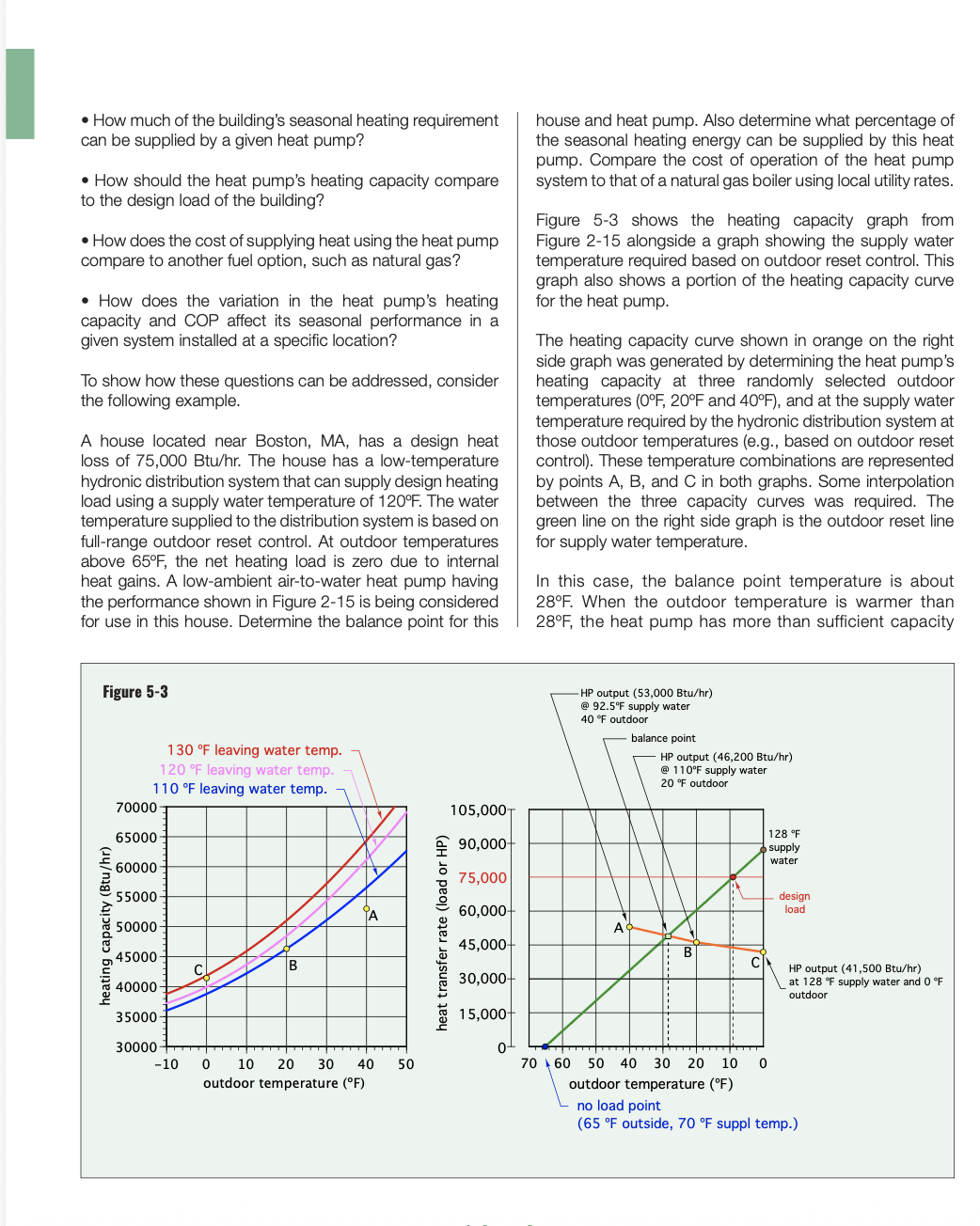

    hot_rod Posts: 28,529
    Ideally all hydronic systems would get cleaned first, with a hydronic detergent.
    Then good water, good water as in low hardness below 7 gpg, low TDS, low chlorides neutral ph. DI, RO or distilled water would be best. Which you can buy or make on site with an Axiom DI cartridge filter.
    Then and only then add the conditioner F1 or others.
    The conditioners prefer good water. Or else you use up the inhibitors the first day fixing bad water.
    The test kit tells you what condition your conditioners are in.

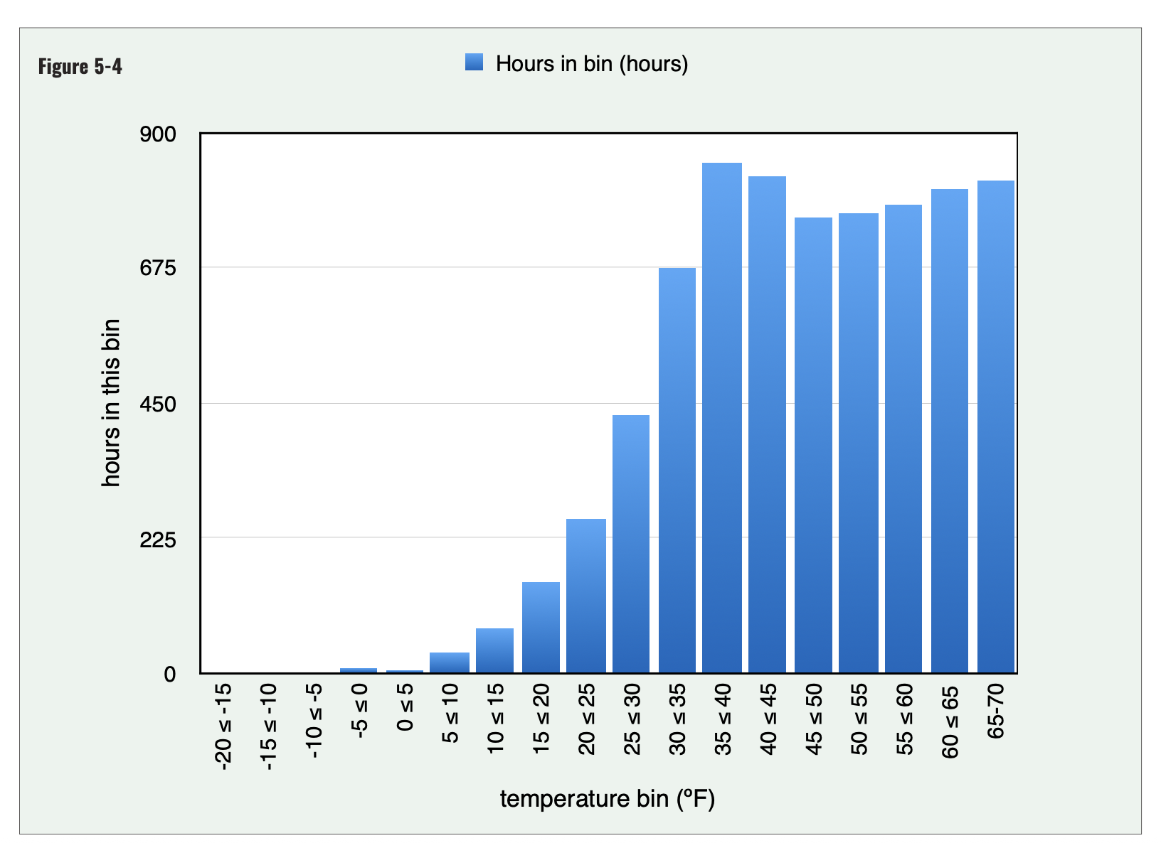

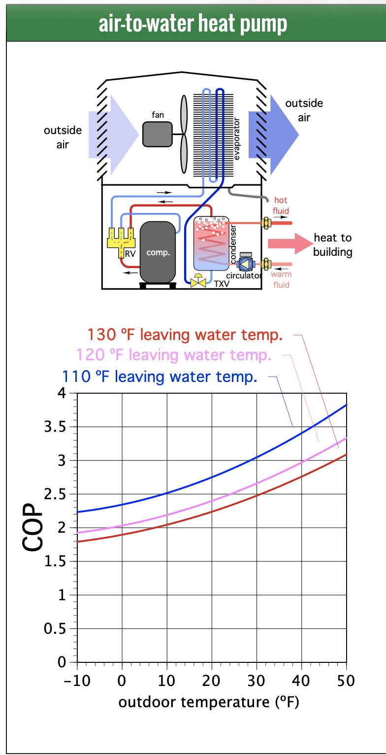

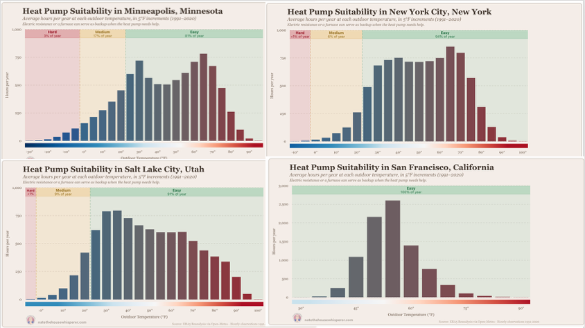

    If you can get the system to operate on a design day with 120or so AWT. And run ODR, you will be in good COP most of the heating season. Most areas are at design less than 10% of the year
    You can download temperature BIN files for your area to get a idea how the COP would look throughout the season.
    A couple examples, and a page showing how to calculate "balance point"
    Screenshot 2026-02-11 at 9.09.59 AM.png Screenshot 2026-03-15 at 3.32.25 PM.png Screenshot 2026-03-15 at 3.34.34 PM.png Screenshot 2026-03-15 at 3.37.17 PM.png Screenshot 2026-03-15 at 3.39.28 PM.png

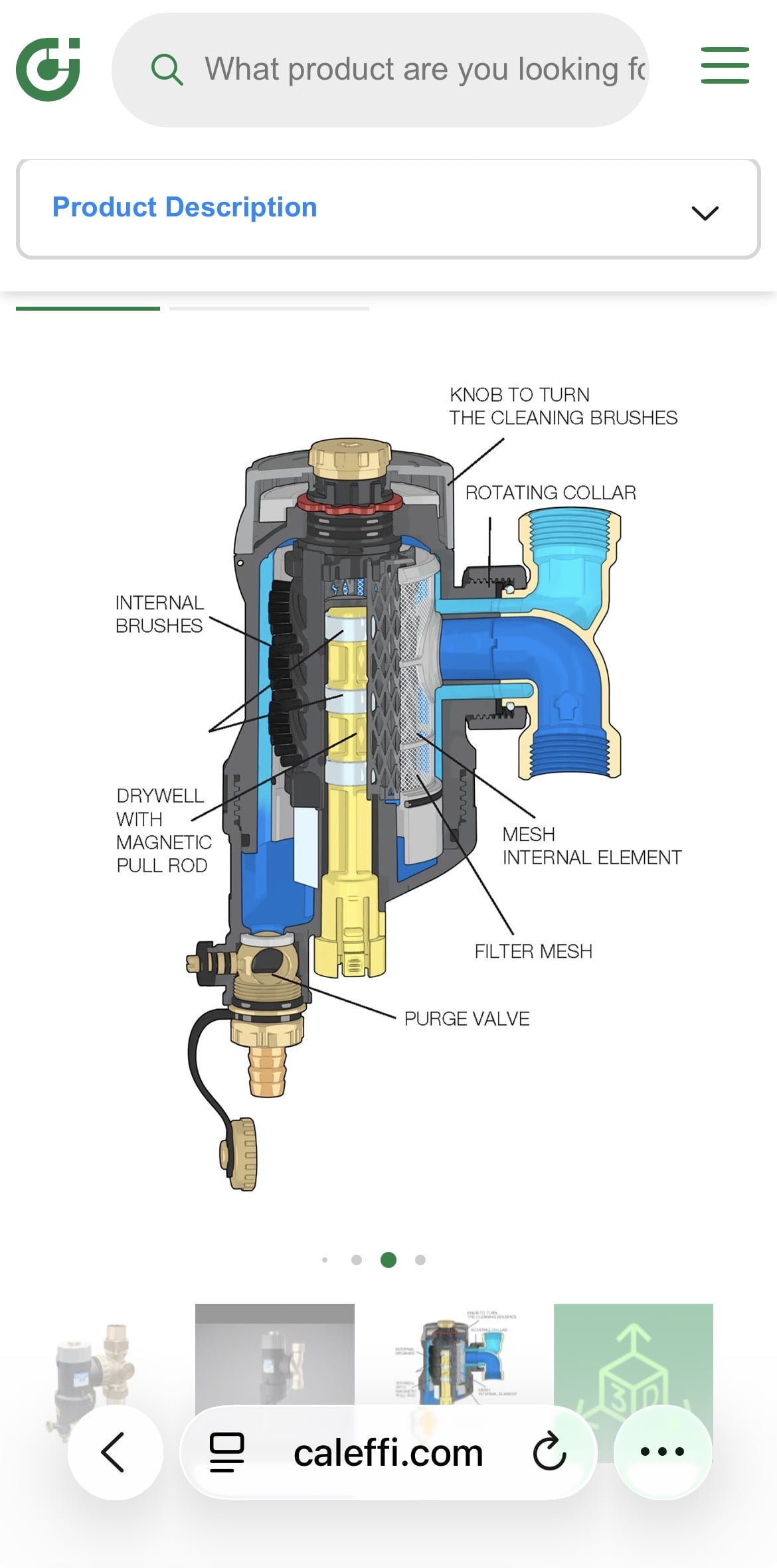

  • bjohnhy
    bjohnhy Posts: 216
    Make sure you have a good magnetic dirt separator.
    If you wanted to be extra careful you can run a filter just before your heat exchanger as well. This one doesn't add to much resistance to flow, double check what micron size particles you are willing to allow. But once the water gets cleaned up and treated, ongoing sediment catch will be minimal.
    1-1/4-140-HT-F - Rusco 1-1/4-140-HT-F - 1-1/4" Hot Water Spin-Down Filter System (140 Mesh)
  • jeff4444
    jeff4444 Posts: 40
    thanks bJohnhy
    I looked over the filters in my case I assume I’ll be looking for possible products of corrosion caused by the no O2 barrier tubing. Plus any old junk that wasn’t loosened at the initial cleaning.Do you think the 140 mesh would be the best size to use?
    Thanks again, this is a great add to the above system.
    The Caleffi XF was designed specifically for the HP conversion market. With two filters, magnet and rotating scrubber

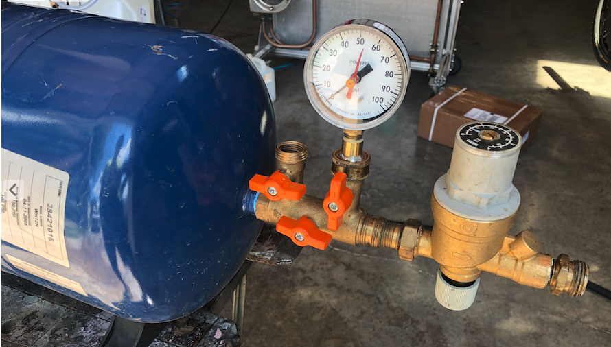

    BTW could I have a significant amount of water stored in a large expansion tank that could be my reserve to add more clean water as needed? This could expensive feeder tank.
    If so, how much water might be stored here —more than one or 2 gallons?

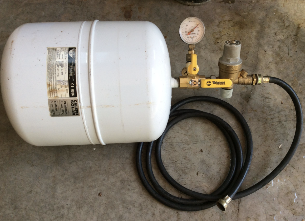

    After a few days to a week of operation at the highest operating temperature, with a good microbubble air purger, the system should not need more fill water.
    A small #30 expansion tank can hold about 4 additional gallons for a back up, if you don't want to invest in a fill tank. Pressurize the tank to 30 psi, add a fill valve set to the desired fill pressure.
    This solar version was a portable tank to top off solar thermal systems.
    A low water or in the case of HPs a low pressure cutout switch is a good idea.
    Screenshot 2025-04-25 at 8.13.32 AM.png Screenshot 2025-12-17 at 9.20.14 AM.png
  • jeff4444
    jeff4444 Posts: 40
    yes, that’s the idea. The system still has the existing pressure reduction valve for the original make up water connection piped to the house system.
    I guess I would just need to take it off of the house water and feed a new expansion tank into the existing pressure reducing valve at 12–15 psi.
    Sounds like this part could be a fairly inexpensive change, great!
