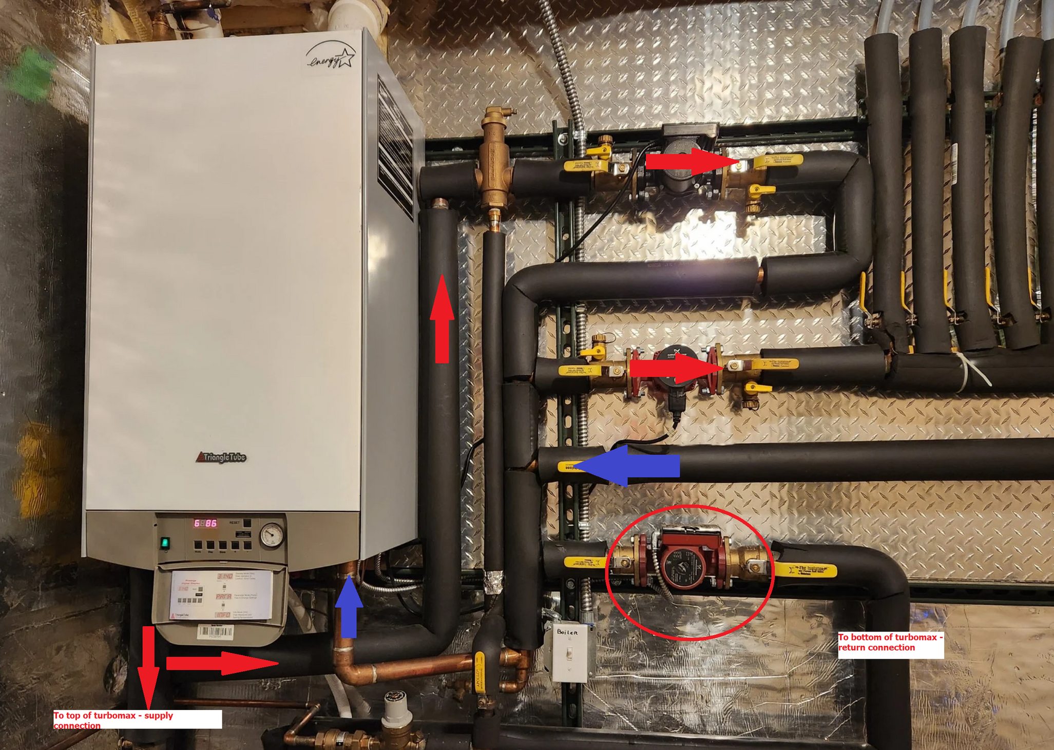

    Palisandr Member Posts: 30
    Yeah, that's the enigma which is eating me out as a homeowner. Almost looks like a bottleneck somewhere in the system has appeared about two months ago and is getting worse. HOt water is supplied, but not replenished at the necessary rate. Photos of the system are attached.
    mattmia2 Member Posts: 18,052
    Maybe the expansion tank and the prv have failed and the dhw demand is causing the system to cool and lose pressure.(after the pressure reliefe valve blew off when the wsytem was at temp).

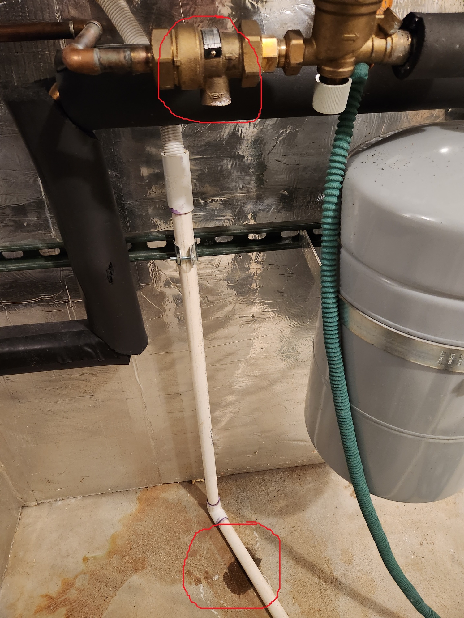

    There is a little drip from the backflow preventer vent (see attached pic). I did close the valve on the PRV completely (it was open before). I will also put latex gloves (will tighten them with scotch around the pipe) on both of the pressure relief valves and see if they accumulate any water. Not sure how to test the expansion tank (any ideas?). If the pressure still drops and pressure relief valves are dry?
    Could there be small holes in the Turbomax which allow communication between boiler hot water supply and the DHW circuit? Again, the system developed this peculiar condition about two months ago after 13 years of usage without problems

    This is why having that additional pressure gauge on the Caleffi fill valve is useful! It's always nice to have a little redundancy to double check if something is working correctly. (edit: noticed there isn't even a tapped port there! I guess they didn't come with one back in the day?)

    What you have is an automatic fill valve set at what looks like 16-17psi. This valve does not care what your boiler is doing. It can be off. It will feed water into your closed loop if it drops below the set point.
    So when you say it only builds up pressure again when heating the water, something is already wrong here. Unfortunately, the only gauge you have that I can see is on the boiler itself.
    What I believe Alan was asking you to do was to shut off that fill valve after it oddly drops pressure from using your domestic hot water. Not manually draining the system. What we want to see is if the pressure returns without the use of the Caleffi fill valve after losing it to running the domestic hot water.

    You have a ball valve (red handle valve on the wall) before the Caleffi fill valve/backflow combo. You can re-run your test using the ball valve to shut off boiler filling instead of the valve on the Caleffi to rule it out.
    I also had questions about the piping, but didn't really think it was pertinent. Could you let me know which way the arrow is facing on the circled pump?

    yes, it connects to the bottom of the indirect. just curious as to which way it was pumping, as the factory position would have it pumping towards the indirect, then the top supply would act as the return.. but it's connected to the boiler supply. either way seems like it all could have been piped differently.. especially incorporating the turbomax as a buffer tank/hydraulic separator.
