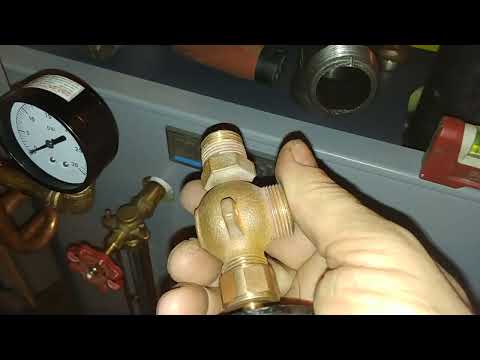

In the Near-Boiler Piping in Steam Heating Systems video Dan Holohan recommends having a king valve and return valve so you can isolate the boiler from the system Then turn it on and build up pressure and open the mud valve to clean out the system. Is this something I should do for my residential boiler? Or is this something you typically just do with commercial boilers? I have Peerless Model 63-04.

I am not convinced that is the only way, and those large valves can be expensive. The wet return needs to be kept clear too.
@ethicalpaul, may have an opinion.
Steam boiler piping: is the manufacturer spec good enough?
https://youtu.be/4IymyZB4wlI
Also this Youtuber has a lot of videos with clean out valves and water feed locations.
Just one, see 4:00 and on if you do no want to watch the whole thing.
Weil-McLain SGO-3 Steam Boiler Install - Still No Friggin' Burner Door OR Trim Kit.
https://youtu.be/2TdUtYhptqc
