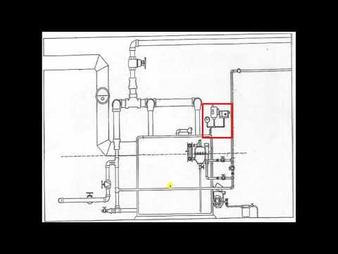

    @EBEBRATT-Ed @Jamie Hall @EdTheHeaterMan Here are the photos guys and the cap I was referring to on the back that I assume is used for skimming. Thanks for the tip as well on where to find the skimming method in the book!
    EdTheHeaterMan Member Posts: 11,562
    edited February 2022
    It is possible that the Hartford Loop is incorrect. Difficult to tell from the pictures however it is easy to determine with a tape measure. Assuming the floor is level (or within a 1/2" of level) measure from the center line of the short horizontal nipple to the floor,(about 26" see diagram) then measure the distance of the water line indicated on the boiler (@ about 28" from floor see diagram) The Close Horizontal pipe nipple should be about 2" lower than the water line.
    Another item on this diagram indicates that both supply openings should be used, but if the system is operating adequately, then I'm not sure there is a problem that needs to be fixed.
    If however, you find the short connecting pipe nipple is too low, and you are going to get that corrected, then you might as well do the rest of the piping correctly. look at this video for best piping practices https://www.youtube.com/watch?v=L11ywcjSOFA
    You may not get a lower operating cost, but the boiler will last longer. That is a savings worth thinking about
    PS. There is one problem with the manufacturer figure 7 diagram, no swing joints on the riser to header connection. That is explained in the video.
    If you do not have the original install/operation manual here is a link to one that is close to your system https://uticaboilers.com/sites/default/files/240012155_SFEV_IOM-Rev D.pdf

    When you say there is no swing joints in the diagram, is that the same as saying there are no threaded 90 degree elbows?
    A swing joint allows for lateral movement as a result of expansion of metal in this diagram there are no swing joints so there is additional stress on the cast iron
    In this illustration there 4 elbows to arrive at a destination where clearly only 2 elbows are necessary.
    The additional 2 elbows are considered a swing joint. minor expansion and contraction will e absorbed by the movement of the threads of the steel pipe in the cast iron elbows.
    I did take your advice and measure the hartford loop, and your suspicion is correct. Instead of 2" below the water line it is 6.5". I understand that this means the water in the return side can leak/drain to 6.5" below the water line but in reality how does this affect the system?
    The Hartford loop keeps the boiler from running dry resulting from excess steam pressure buildup in the boiler and forcing the water backwards out the bottom of the boiler into the return pipe If there was 3 PSI of steam in the boiler that could push water up the return pipe into the first floor radiators 8 PSI can push it to the second floor radiators. By having the header connected to the return via the equalizer pipe, the same pressure that is forcing the water out the bottom of the boiler is also the same pressure that will push the water back in the bottom of the equalizer into the bottom of the boiler. Once you understand that... now connect the return pipe to the equalizer at a point about 2" below the water line... now the water must spill over the "Loop" to be pushed up the return pipe into the radiators. Water does not just go up by itself. it is heavier than steam, and the pressure that is pushing the water up is equalized at the point where the "Loop" is connected.
    Another reason is, if the return pipe ever springs a leak, the boiler will only leak out water until it reaches the "Loop" then the water won't go up over the Loop and into the leaking return.
    Now understand, the LWCO and the Pressure Control have both failed to turn off the burners when this happens. But in steam systems that happens more often than you might think.

    So where in these storylines is the place where "Hartford loop saves boiler or family"? I just don't get it. The whole thing seems to be a case of mass illusion. I assume the boiler in your story above had a Hartford loop too.
    I remember learning about the underwriters loop in the 1960s. I may be wrong but the memory I have is that boilers installed before the LOOP was introduced had check valves. the check valves failed and the boiler steam pressure could have enough force to push the water line down like this illustration.
    If this is true, then could a boiler fail because the water level dropped and the weight of the water in the return was insufficient to keep the water in the boiler above the minimum lever required for safe operation.
    By adding an equalizer and returning the water 2" below the water line, this boiler pressure thing would be eliminated by piping design. The Equalizer and the close nipple 2" below the water line is the Hartford Loop.
    Even if @ethicalpaul disagrees with the return hight, the equalizer part of the Hartford loop is important in the design. So if there is anything to Paul's validity that the Hartford Loop is useless... it is only 1/2 useless. The equalizer makes sense to me. What are your thoughts on the equalizer Paul?

    @ethicalpaul, Hand fired steam boilers of the 1800s and early 1900s had large steam chests. There was very little problem with carry over water that needs a path back to the return. This is what I was told in the 1960s. Those concepts were and are still reinforced by the teachings of the great one ( @DanHolohan). Reference the first 30 seconds of this video https://www.youtube.com/watch?v=L11ywcjSOFA&t=3s
    Those boilers were not equipped with equalizers in the near boiler piping. I remember learning about Dimension A in the boiler return piping. Many boilers were installed in a pit in the basement so the proper dimension A could be maintained in order to have enough static head pressure in the return to counteract the Boiler's Steam chest pressure. See previous diagram where 3 PSI requires a 7 ft. dimension A. When the Dead Men, back in the late 1800s, determined that 1.5 PSI was all the pressure needed, the dimension A could be reduced to 24" or 36" or something more easily designed. When the Insurance People required the equalizer and the close nipple pipe at 2" below the water line to get insurance, boiler failures were reduced exponentially.
    The near boiler piping that put the return condensate water back into the boiler at the 2" below the normal water line at the added equalizer vertical pipe is what I always considered the Hartford Loop.
    Paul, where do you believe the Hartford loop is actually located?
    PS I took a heating class at a technical school in Philadelphia that had 30 old boilers in the basement that could actually heat the building. There were low pressure oil burners like Williams Oil O Matic, Timkin and Dynatherm, along with many High Pressure (100PSI) Gun burners like Quiet May and ARCO piggy-back.
    The old man that taught me was really old when I was in my 20s. So i can say that i learned from a real Dead Man from back in the day. George Spence was in his 70s when i learned about dimension A on a steam boiler and how to clean a check valve on the return, because there were still uninsured boilers without equalizers. I even remember working on a coal fired boiler in one home in Old City Philadelphia.

    I think of the hartford loop as the oval circled portion from your drawing. I can picture a hartford loop without an equalizer and vice versa. Is that right?
    ”boiler failures were reduced exponentially” I’d still like to understand how.
