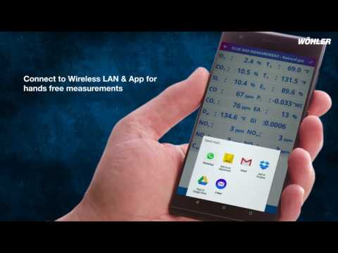

    @hot_rod - what did you come up regarding the combustion analyzer?  I saw a nice used Testo 320 recently.  I believe the 320 has user replaceable CO sensor which would be good since I would only be using occasionally.
    hot_rod Member Posts: 28,288
    I'm leaning towards the Wohler 450. Touch screen, ap, everything on a single screen, no scrollong around for the different readings Found them for 1287 at test instruments
    https://www.youtube.com/watch?v=3BdpmXCxRZU
