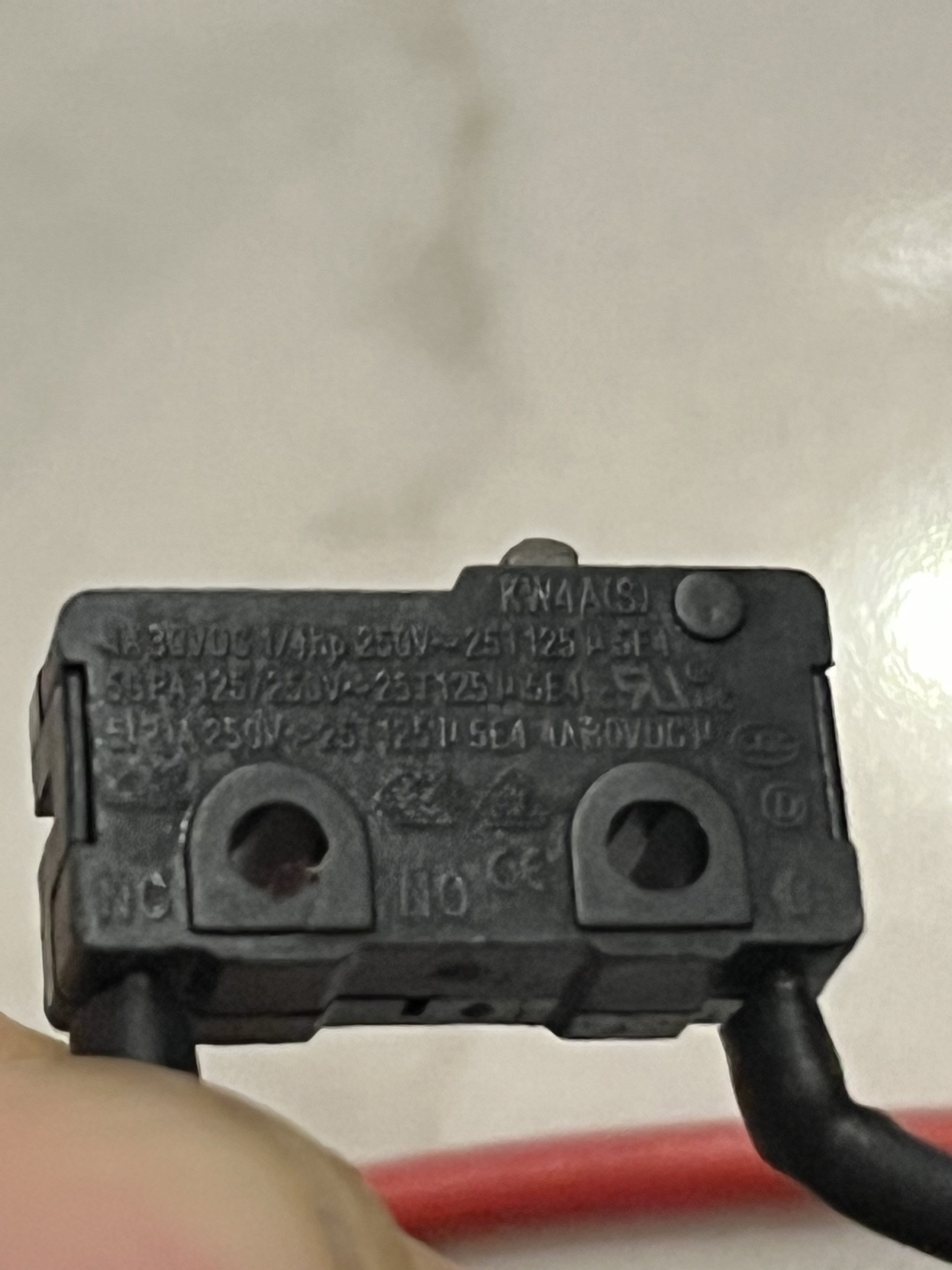

    I was having the same issue and couldn’t believe the 3way was faulty so I dug deep on this and found micro switches under the cover, one had failed, carbon on the contacts, was able to clean up and get it going. Couple bucks on Amazon if you’re so inclined. PN KW4A(S). They’re plastic welded onto a couple pins and I got lucky they popped right out.
    Found two part numbers for the 3way ft1220 and ft2071, maybe the new one is improved.
    Anyway mines all rusty inside but that wouldn’t cause the micro switch to fail… I’ll try the conditioner as suggested.
    hope that helps
  • Rodman1
    Rodman1 Member Posts: 2
    Wanted to add that I had no error codes. Symptom was hot dhw but no zone heating. This was caused by the blue wire switch failure and can be tested with a continuity test between the blue wire (follow wire up to a blue, red, black connector on the main board) and the double black wires on the actuator motor. They are normally closed switches so blue circuit should have continuity in dhw mode and red circuit should have continuity in ch mode.
