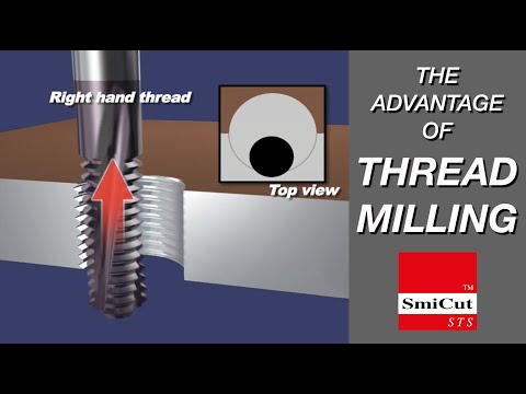

    On my machine the part moves in X and Y and the tool spins and moves in Z (vertical).
    I'm going to try and take a video of it in the next few days.
    I've done a lot of normal threads but this will be my first time milling npt threads

    The tool spins like a drill bit and moves up and down and the part  moves around horizontally.
  • ChrisJ
    ChrisJ Member Posts: 16,738
    This video shows how it works.
    https://youtu.be/rDnavOlGcdc

    That's awesome. Do you use it to make male threads too?
  • ChrisJ
    Yessir.
    hot_rod Member Posts: 25,141
    great animation!
