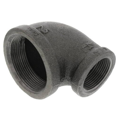

    As for the 2" to 1 1/4" transition in the crawl space, IIWM I would saw the 1 1/4" pipe off first and remove it at your union at the new block wall.
    Grind the 2" end of the tee down almost to the pipe threads, then pop it open with a chisel. Then you end up with just the end of the pipe.
    Get a 2 X 1/4 90 ell, have it pointing down and add another 90 (or point it at a 45 and add 45) to repipe the dry return back to the boiler. I would raise the dry return at the boiler and keep just enough slope to drain.
    You could add a tee in a more accessible place near the new wall for your air venting. This would vent the entire steam main....don't worry about the location of the venting.....as long as it is after the last run out and 16" away from a 90. Many air vents are located right above the boiler. You could/should eliminate the check valve also IMO.

    if it were my system, at this point, i would take the $80 risk and just install the vent where that plug is now and see what happens. sure you might have to replace the vent again or repipe a bit sometime in the future, but it will certainly work for the time being. it might also work just fine for a long while.
    and i don't know why that eccentric reducer is so expensive, but maybe instead you can use a reducing elbow at the end of the main ?
    https://www.supplyhouse.com/Bluefin-BLE200-125-2-x-1-1-4-Black-90-Reducing-Elbow

    As mentioned about 10 posts up, might be less work in the crawl space. IMO
