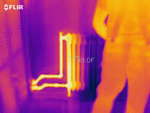

Most of the time, when I set these infrared videos up, something happens and the "take" is blown: The camera dies. The customer holds their thumb in front of the camera. The pressure dies before the air is fully removed. The barking dogs/children move into the scene, etc etc etc. You only get one chance to capture the moment, or its gone.
You be the judge, of course, but I think I got a good one this time....

    @tomhaeussler : I know what you mean! This FLIR has been an eyeopening experience.
    I'd had never suspected that flowing water would react that way in a partly filled radiator. Usually, when the pressure drops and air seeps into the radiator on the top floor, AND the supply is at the top, the flow stops and the radiator is cold. Period. Well, now I know its not quite that simple.
    I'm sure eventually if pressure kept dropping, the flow would stop and the radiator would go cold.
    I wonder why the Dead Men did that top supply thing anyway on top-most floors?
    At least if you lose pressure over the season, and you have both hook-ups at the bottom, you won't totally lose flow unless you had a major problem.
