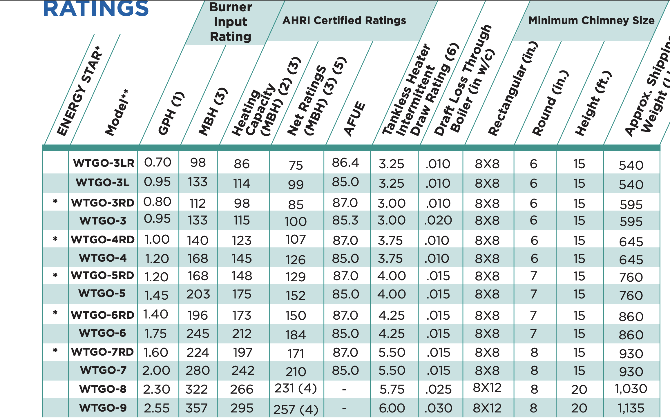

    It shows a 1.00 GPH input as an option to downfire. That's not the nozzle size, but firing rate. A .85 nozzle is used with adjusted pump pressure to achieve 1.00 GPH.
    I never really understood the 3 and 4 section WGO. They are basically the same boiler, dimension wise. The 3 section has a wide middle section that's substituted for two sections to make 4. The 3 actually holds 1.5 gallons more water than the 4 section.
  • STEVEusaPA
    STEVEusaPA Posts: 6,505
    edited September 2019
    Yes but your chart doesn't show it being downfired. It has a smaller nozzle and increased pump pressure maintaining the same firing rate (and needed for flame stability).
    Which is still a better set up and recommended over the 1.20 and 100psi setting.
    Just note the change in the pump pressure, air shutter and turbulator. If you don't change all 3 (check, verify with gauges, smoke gun and analyzer) you'll have problems.

    The firing rate on the 3 is .95 GPH. Only .05 less than the downfire 4 section. Yes, out the the question.

    Close as I can guess, max firing rate on the 3 section is .95 GPH while the minimum firing rate on the 4 section is 1.00 GPH. What's .05 between friends? Especially when the actual firing rate can be +/- 10% at 100 psi from what the stamp says on the nozzle.
    There's obviously more surface area on the fire side of the 4 section (even though it holds less water than the 3 section. Which is a little weird to me), so the pointy heads were probably worried about condensing flue gases at a lower rate.
    FWIW, up until last month I had my WGTO-3 with a Riello F5, .60 nozzle at 150 psi for .75 GPH input for 24 years. The boiler ('96) was there when I bought in '02. It had an AFG originally. Rarely needed to be brushed. Stack temperature always around 420° gross. Now the whole thing is at the scrap yard.

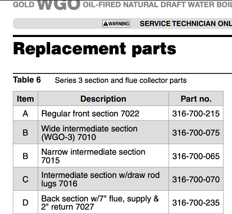

    As far as the WTGO 3 and the WTGO 4 is concerned, there is a larger (or thicker) center section on that 3 boiler so it is about the same size combustion chamber as far as the firing rate is concerned, but there is less cast iron in those dimensions so there is more room for water. Looking at the parts list for the WGO-3. there is a different part number for that intermediate section, compared to the standard section on all the other larger sizes
    When you look at all the configurations of the WTGO-3 Series 3 Gold boiler, you can fire it as high as 0.95 GPH and as low as 0.70 GPH. That is actually a little more than 20% less than the maximum—more like 26%.
    If you happen to get one with a rating plate of WTGO-3LR with a firing rate of 0.70 GPH, you could actually fire it at 0.95 GPH, since Weil-McLain uses that same block of cast iron. However, since the rating plate says 0.70 GPH, you could leave yourself open to a liability issue.
    What is stamped on the rating plate supersedes what you can actually do safely.
