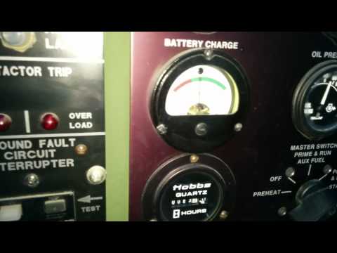

    Here’s my fav video comparing brushed vs brushless gens on an oscilloscope. Obviously it’s comparing apples to oranges as portability is concerned but I’d love to get a surplus generator for home backup. Most of them are extremely underrated, he’s powering centeral air on a ‘5kw’ generator in the video.
    https://youtu.be/QNo1mUCpQnI
