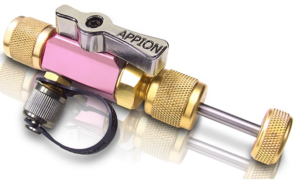

I plan on installing my mini split tomorrow and the weather will be in the 30's. I will be using a core removal tool, micron gauge, and vacuum rated hose. Is it ok to evacuate in cold weather or should I wait for it to warm up? I assume the little moisture would still boil off even if its cold around freezing out?
The condenser is precharged and the evaporator is filled with nitrogen. Line set is about 12 feet so I would just be evacuating the lineset and evaporator.

    With just one 12' lineset for vacuum, don't be surprised/disappointed if you see big swings on the micron gauge when working with the core remover tool (when storing the core/reinserting it and working the tool's valve). Any air ingress in such a small container will show up big on the micron gauge.
    Rob I don’t follow, can you reword a little? I haven’t seen swings unless there’s a leak

    GW said:
    Same principle as removing a cup of water from a pint container vs removing a cup of water from a bathtub. In one case a cup is half it's volume and you'll easily notice it- in the other case it's a fraction of a percent and you probably couldn't even measure it.
    Last spring when evacuating my full system with three indoor units and 135' of lineset.. when working with the core remover tool (in/out/replace, etc..) the micron gauge held steady when operating the core tool. When I worked on my other system and just evacuated one indoor unit with a 20' lineset by itself (when I was down at 200 microns or so) just working with the core remover would result in the micron gauge showing a decent loss (10-15microns) of vacuum.
    In both cases I used the same core remover/micron gauge/pump/etc... just different system volumes between a three indoor units/135' lineset setup and just one 7KBTU indoor unit and a 20' lineset setup.
    Funny thing is, I thought evacuating the single head job was going to be a quick in/out/done thing. But due to the small system volume it was more difficult... you had to be super careful with all valves and tools to prevent any leaks at 200 microns and below.

    Ok I guess I still don’t follow. You know that when you turn off the core tool you get an automatic spike (drop in vac) due to oily matter building in the tool itself ? But never the less, yes it will spike then drop quickly to about where it was “running”

    Core removal tools have ball valves. There is a hollow cavity between the outside of the ball and the sidewalls of the tool. When you turn the valve, this hollow cavity gets exposed to the system until the valve is fully closed.
    You have to depressurize the core removal tool during every evacuation. I usually wait till I'm around 500 or lower microns and the crack the valves until my micron readings drop back as they were.

    ^ thanks Harvey, that probably explains the "blip" I'm seeing on the micron gauge when operating the core tool. Also, once you're done with evac and ready to replace the core... you get a small pocket of air in the core chamber too when switching from vac hose to core stem tool.
  • GW
    GW Member Posts: 5,144
    Rob you gotta open the charge on the condenser to break the vacuum, Then put your Schaeder core back in
    I like the copper line for the vac
    Thanks for that!
    In my configuration, would that positive pressure inrush damage my micron gauge?
  • GW
    I think the vacuum gauge is designed to handle at least 100 psi probably more. But worse yet you really don’t want Oil’s getting in there. The next time we do it Ductless I’ll take a picture of our set up.

    Here are some snapshots I gathered from around the web regarding placement of the core remover tool. Both setups would subject the micron gauges to pressure and refrigerant if the service valve was cracked with the core tool in place.
  • GW
    I found a pic, so you can’t see it super well but we do have a ball valve on the vac gauge. And you can see our triple set up. In case anyone wants to hear—-When we “gas it” (our expression for the “triple evac”), we shut off the top valve on the manifold tree and also the valve on the vac and we gas it to 10 psi or so. Then we slowly open the top valve on the tree (yes it sputters some) until we get below zero psi (that’s takes a second or two) then we open the valve again for the vac gauge.

    After final purge/evac... Close the ball valve to the micron gauge then crack the service valve, install core under positive pressure, then remove the core tool from the service port.
    That works for me and no chance of damaging or contaminating the $$ micron gauge.
    PS.. like your homemade “gas it” setup... looks like it's better suited for purge/evac than using a manifold set.
    LOL... on my first purge/evac to 500 microns I didn't realize I'd lose the vac as soon as I turned the pump off. Fixed that real quick.. :o
