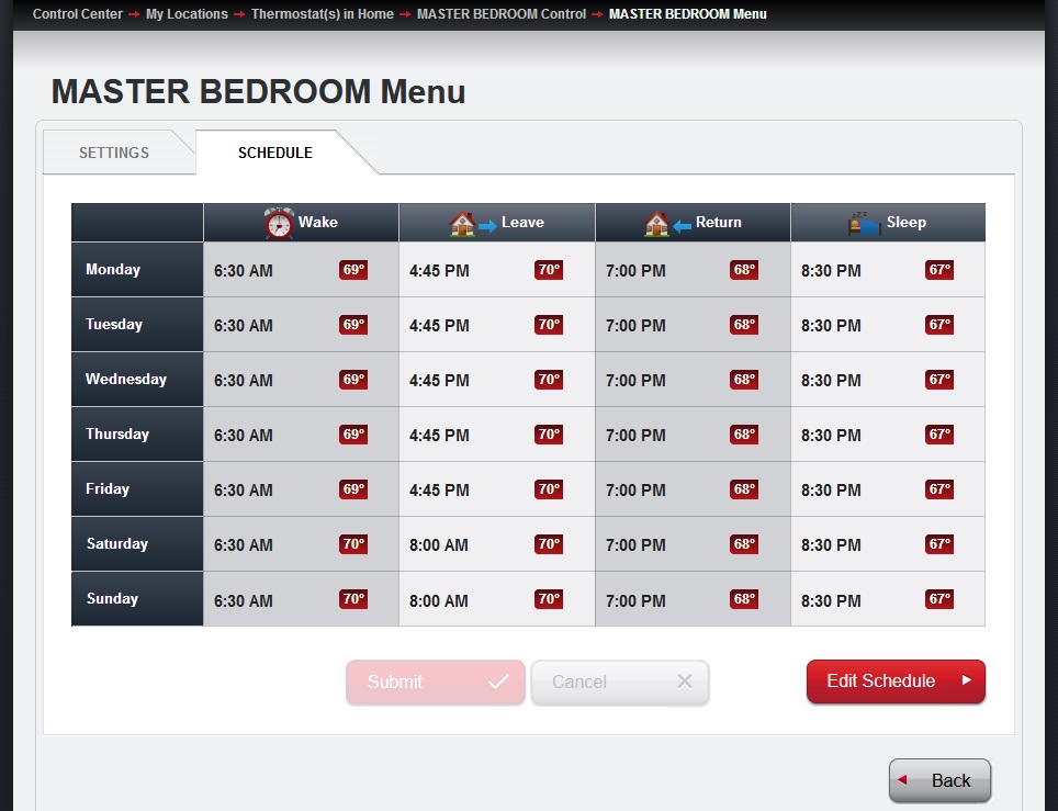

    Installed my VP 8320WF on Sat, enrolled it with online service... no problems there (I had gone through a similar enrollment routine with other wi-fi t-stats). Entering my setback schedule online vs. via the front of the t-stat was super easy.
    Left most settings at default other than entering my system type and setting the CPH to 2 in the installer menu for mod-con with baseboard.
    After using the t-stat for two days I'm very impressed by how smoothly it seems to control the heat vs the Robert Shaw t-stat it replaced. I'm thinking that it partially due to the 2 CPH setting that keeps the boiler for running for longer periods and starts the heat calls earlier also because of the 2 CPH setting.
    The "Adaptive Intelligent Recovery" actually worked quite well even though it's only been online two full days so far.
    I have it set to bring the upstairs from 67F overnight to 69F at 6:30am. This morning when I got up at 6:50 it was exactly 69F upstairs. Don't know exactly what time it started the recovery, but I woke up for a bathroom trip at about 5am and the radiators were just barely warm so I'm guessing it had just started the recovery call minutes earlier. I had the old t-stat set to start the recovery at 4:45am. The VP did it for me automatically, and did it perfectly too. I'm actually pretty impressed how well the "Adaptive Intelligent Recovery" worked.

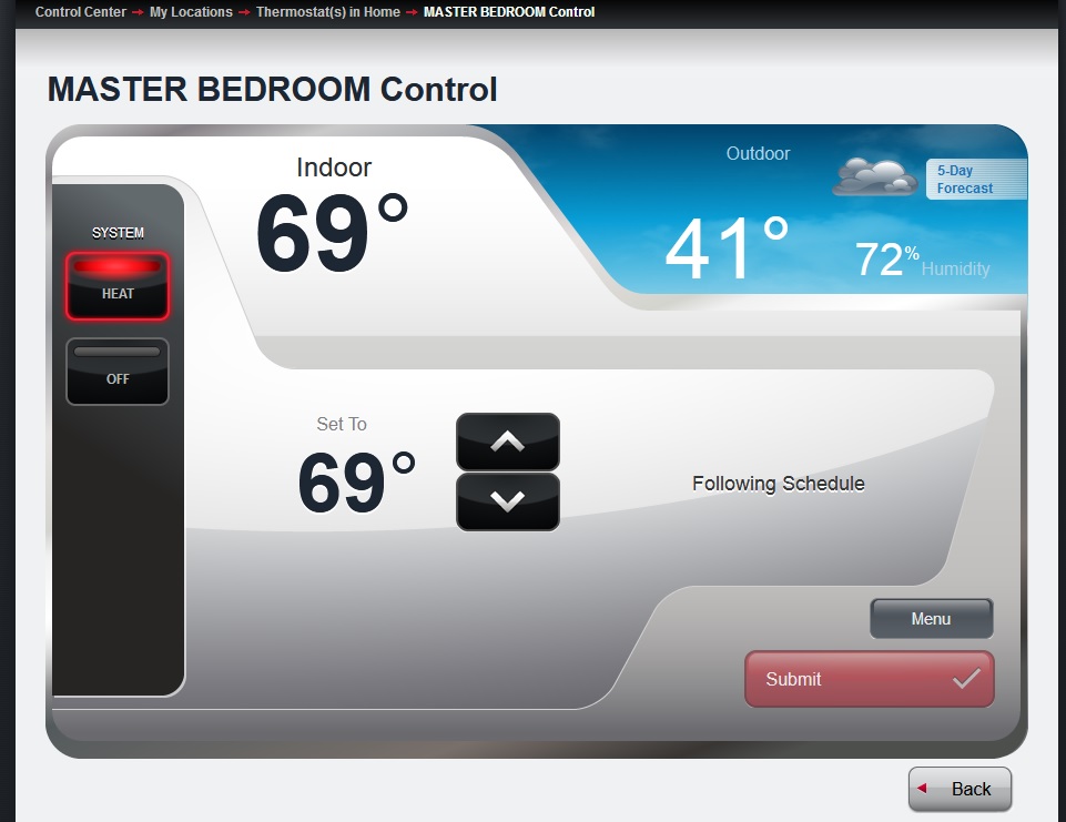

    ^ I've noticed the VP8000 "lie" a little when it comes to the room temp display.
    Last Sat afternoon it was displaying 69F in our bedroom for the last couple of hours, but the heat hadn't come on in a while so it felt a little cold. I manually dialed the setpoint up to 70F just to cycle the boiler and add a little comfort heat. Well, without the heat ever coming on... 3min later the display suddenly indicated 70F. I touched the radiators... they were still ice cold, the heat had never come on and the thermometer in the adjacent room that has a 10th's display hadn't budged at all from 69.7F.
    I attributed the 69F to 70F jump to rounding and the programmer's desire to show you that the t-stat was awesome and had met setpoint regardless if it was 69F or 70F.
