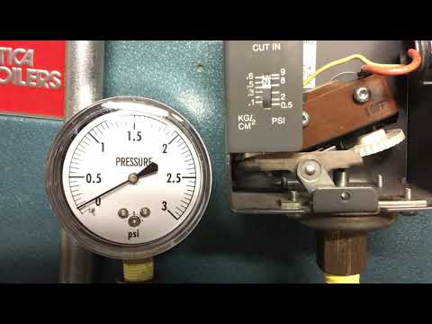

OK I couldn't get my Pressuretrol low enough to cut in at .5 or cut out at 1.5. It would cut in at 1.2 and cut out at about 2.25. The indicator would bottom out in the cutout it rides in preventing any more easing of the spring tension. The solution? Remove the spring and indicator and the tension of the microswitch provided just about the right tension for a very nice cut in and cut out.
Check out the world's most boring video to see it in action (I spared you the beginning of the first firing cycle with this link -- right click to open these links in a new tab or window to have it respect the playback head position: https://youtu.be/sp688Jdc2zM?t=766 ). It takes my thermostat from 70f to 72f. See the video description for links to the interesting parts.
Questions: Is this short-cycling? Or just normal behavior recovering from a 2° setback? Why is 1.5 psi the magic cutout number? Why not 1.75 or 1.25? Can I "under-fire" ("down-fire"?) my boiler to make it cycle less? Why did the pressure drop during the initial firing cycle??? (see 15:48 at https://youtu.be/sp688Jdc2zM?t=948 )

    I would strongly not advise messing around with a pressure control to that degree....pulling out a spring, it's a safety control. Anything happens your homeowners insurance would run away and so would Honeywell.
    Get a vapor stat or add a second control as a backup. The risk is on you and you alone.
    The reason steam builds up and then drops is when you come out of setback the system piping is cold. Steam goes out into the system and for a moment condenses back to water due to the cold pipes faster than the boiler can supply steam. Vacuum from the condensed steam is pulling the steam out of the boiler. This stops as the system warms up

    @ethicalpaul , I doubt that the Pressuretol will consistently work with the spring off. Here is the correct procedure to calibrate it, if you need it:
    Inside the Pressuretrol, right below the micro switch, there is a pivot arm. At the end of that arm you will see a screw pin that is activated by the diaphragm at the bottom of the Pressuretrol. If you look very carefully at that screw pin, you will see it actually has a tiny (I mean tiny) hex head on it. It takes a .050 hex wrench and you can turn it clockwise (Towards the bottom of the Pressuretrol to decrease the Cut-out pressure or counter clockwise to increase the cut-out pressure (which none of us want to do but who knows, your Pressuretrol may be really screwed up!). Turn the power to the unit off first. You may find the first attempt to turn that screw a little bit stubborn (relatively speaking) because it has some Locktite on it but it does turn. Don't turn too much, a fraction of a turn goes a long way towards getting it adjusted where you want it (maybe 1/32 inch turn to start with). You may need to play with it to get it exactly where you want cut out to be.

    I agree with you to an extent. On the other hand, all the spring is doing is making the pressure higher than it should be, so the control trips easier now and is safer than before. But I’ll try the adjustment.
    Thanks, that makes sense, I had never read about that pressure dip anywhere before.

    @ethicalpaul, You can read all about testing and calibrating Pressuretrols on this thread: https://forum.heatinghelp.com/discussion/159223/testing-honeywell-pressuretrols-with-custom-rig/p1
    As for using a Pressuretrol without the spring, I've done it for years on a couple boilers. They work consistently fine. When the pressure is turned down all the way, the springs weren't doing anything anyway. (All the resistance to the boiler pressure was coming from the spring in the microswitch.)
    Understandably, you are unlikely to find any pros who will approve of this since you are modifying a safety device. But I can't see any risk.
    Now, on each of my boilers, I use a microcontroller with a pressure sensor to keep the pressure below 1/2 psi, with the springless Pressuretrol as a backup, and another, unmodified Pressuretrol as a backup to that. (The latter provides the required complete shutdown for the gas millivolt system.)
    ethicalpaul Member Posts: 8,866
    Thanks—I will try to spin the tiny allen screw. It does look currently set to the low range so we’ll see. Everything you said makes sense to me. A completely loose spring == no spring

    Does lowering the cut out pressure by turning the 0.50 " hex screw CW affect the cut in pressure ? When I made this adjustment from 2 psi to 1.5 psi, I had to increase the cut in pressure to get the burner to fire.
  • Chris_L
    Chris_L Member Posts: 354
    If you turn the screw too much, the Pressuretrol won't cut back in to turn on the boiler. If that happens, you can turn the screw back the other way a bit until it cuts in reliably (without having to increase the cut-in).
