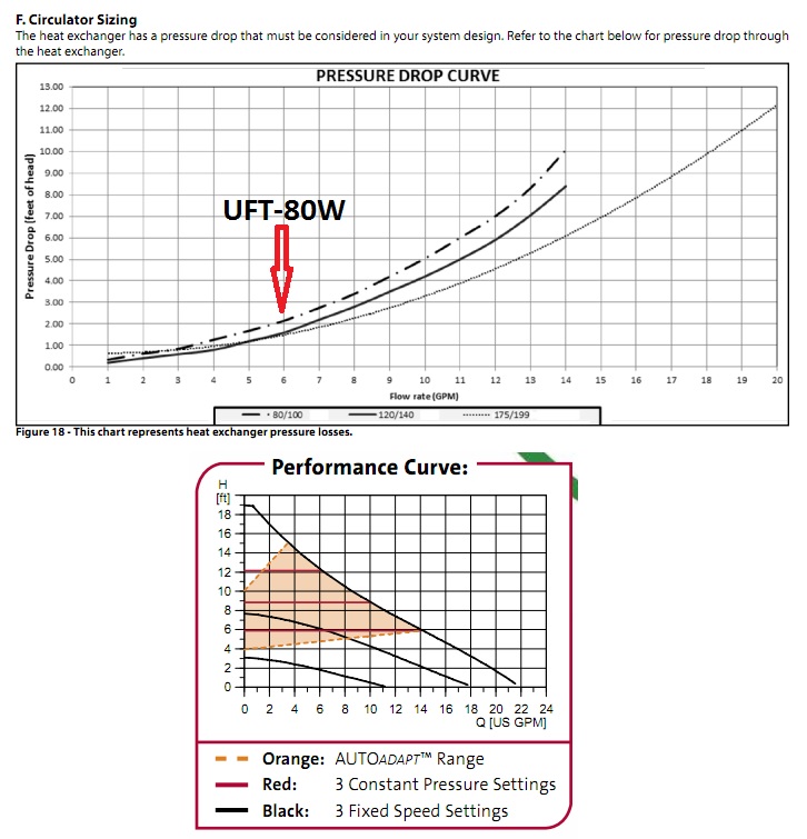

    No real downside to using a buffer tank, and the UFT has provisions for the primary pump right from the factory.
    The Alpha seems like a good choice for the primary pump. One of the fixed speeds will work. Looking at the Alpha's curve chart- fixed speed 1 will give you 6gpm at 2ft head which is almost a perfect match for the UFT 80's HX curve chart.

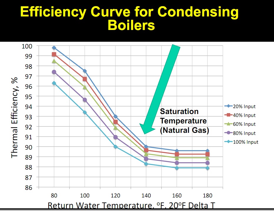

    Condensing will depend on the return water temp... keep an eye on it. 130F is the beginning of the condensing range.
  • Ironman
    Ironman Member Posts: 7,851
    No boiler will condense when the water temp is 140*+.
    This is where the ODR curve needs to be properly set in order to let the boiler condense as much as possible, yet not let the water temp in the tank fall below what's needed for domestic. Probably not below 115*.

    Gordy Member Posts: 9,546
    Agree with @hotrod_7 there will be a period of time in condensing mod when charging the turbo max until closing in on setpoint.
    Once you are up and running you could experiment with capping out upper modulation if possible, and charge the indirect low, and slow.
    At 60% modulation your at 89% efficiency. Still not bad. If your dhw demands are not high. Running 60% your at 48k still more than a conventional water heaters output, and much higher efficiency.
