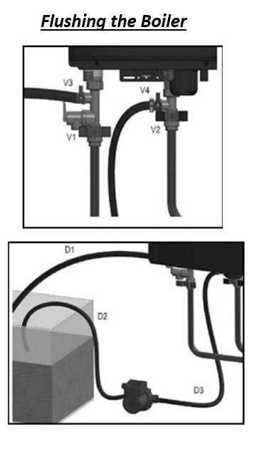

    Sorry to add this, but keep in mind that HTP recommends flushing the HX every 2yrs or so with a descaling agent. It's easy at this point to add valves that will let you do that vs. adding to an installed system.
    https://www.supplyhouse.com/Webstone-40614-1-Pro-Pal-Full-Port-Forged-Brass-Ball-Valve-w-Hi-Flow-Hose-Drain-Reversible-Handle
  • NY_Rob
    NY_Rob Member Posts: 1,370
    ^ Just noticed in one of your photos that you're not using the bottom left supply connection, so you only need just one valve there since you have a ported valve on your circulator flange on the return.
    Just connect the descale pump outlet to the new bottom left supply side valve and drain into a bucket from the hose drain port on the pump flange.
