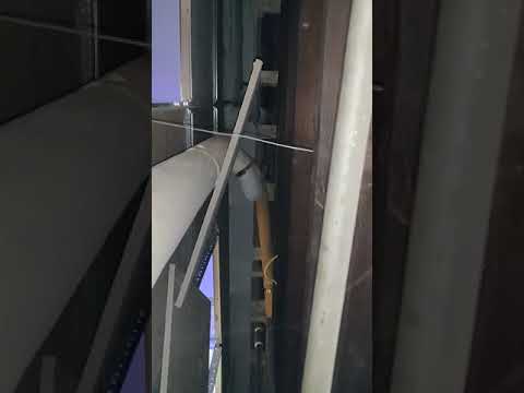

    I took a quick video, I didn't manage to record the beginning part of the heat cycle (it gets louder than this) but at this point the radiator isn't warm yet.
    https://www.youtube.com/watch?v=bRAagkjaZDw
    It keeps making these noises for about 5-10 minutes. Is this normal?

    Aside from that boiler being piped wrong and the fact that it has side tappings, which makes it very sensitive to being properly piped, there are a few things you can check to quiet the radiators down:
    - Turning the Pressuretrol setting down was a good thing to do but if the pigtail (looped pipe ) the Pressuretrol is mounted on hasn't been taken off and cleaned in a few years, it is probably clogged and not allowing the Pressuretrol to measure and control any system pressure. Clean that pigtail out.
    - Turn the Pressuretrol down to .5 or no more than 1PSI and take the cover off of the Pressuretrol and make sure the white wheel, inside is set to "1" as well.
    - Make sure your single pipe radiators have a slight pitch back towards the supply pipe. It sounds like there may be some water(condensate) sitting at the vent end of the radiator. That will make noise. Use a few shims or quarters un der the radiator legs on that end of the radiator so that you get a 1/4" tilt back to the supply pipe.
    - We need to know the length of the horizontal (Main) pipe that the radiators are piped off of. That will determine the size of the Main vents you need and you do need Main vents on the end of each Main, after the last radiator run-out.

    One thing to be clear about, a noisy vent is not necessarily a vent problem per se. No main venting, too high pressure and oversized boiler can make those rad vents go crazy and no matter which vent you use it won't make much difference. In your case the main venting is definitely a place to start.
    The gurgling sound, to me, sounds like water which could mean wet steam or improper pitch somewhere in the system. Basically water is being held somewhere it doesn't belong or water is being put somewhere it doesn't belong.
    Where are you located?

    Here's a video of what I can get too.
    https://www.youtube.com/watch?v=AdHLwMq15Fo
