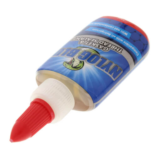

  • NY_Rob
    NY_Rob Member Posts: 1,370
    This is what I picked up for the threads....
    SuperTech
  • ratio
    ratio Member Posts: 3,626
    That's what I use too. Actually, I just picked up the new flavor the last time I got a bottle, before I used the refrigerant-oil specific ones. Technically, IDK how well this one works; but the other ones worked just fine so I expect no issues with this one either.
  • NY_Rob
    In addition to the threads, some ppl suggest lightly coating the face of the flare with Nylog?
  • SuperTech
    SuperTech Member Posts: 2,160
    Yes, I strongly recommend this. And no leak lock please. Use the Nylog. It sounds like you are doing everything correctly
