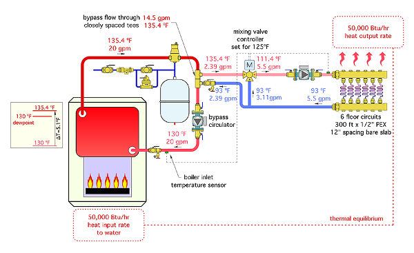

Here's a good concept drawing for you.
IMHO that job you referenced could benefit from a mixing valve for two reasons:
-Increase comfort by extending run/circulation times (lower temps equal longer run times and more even space conditions).
-Protect the boiler against harmful flue gas condensation (the 3 way valve has a boiler inlet sensor, outdoor temp sensor, and heating supply water sensor). It will throttle heating until the boiler return water is at a safe temperature, and then it will target a SWT that is reset off outdoor conditions.
You could keep the budget under control by using closely spaced Tee's instead of hydraulic separator. But some of the separators offer air/dirt/mag separation as well in one component.1 -
