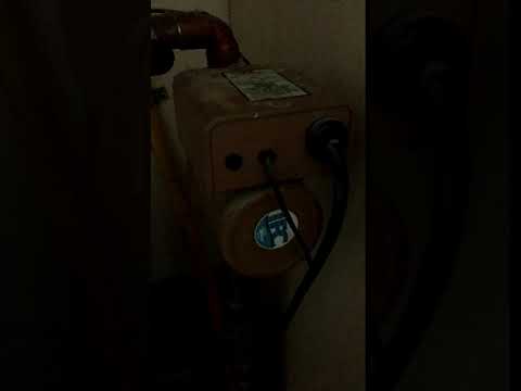

I have a 007 that was a little rattley sounding, so I swapped out the cartridge, but there's been no change! Anything to be done, can it be the check valve in there? Not the end of the world, but it's in the tenant's living room.

    Homer, It's rental so I don't know when it started, I noticed it showing it to new tenant prospects. Definitely no swing valves, both checks are spring type. I guess I could try a stethoscope, but it seems pretty clear it's coming from the pump.
    I took this video for the sound, pumps definitely working, place is warm.
    https://youtu.be/wV3_w5V7PW4

    Wow. Interesting sound, a rattling for sure. This is my thought--the IFC is out of the volute housing and is rattling against the ell on the output of the pump.
    "Hot Rod" had an experience where that happened to him. The IFC came apart and lodged in the boiler HX an created intermittent problem, so it does happen.
    You can put the tip of a mechanic's stethoscope on the ell and you would certainly know for sure or move the tip to where the sound is the loudest. That should help in finding the problem.
