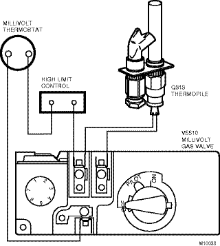

    The wire need to be interrupted by the contacts in the LWCO. Here is a simplified schematic of a millivolt gas valve. What's called the "millivolt thermostat" represents your aquastat, "high limit control" your new LWCO. The terminal on the gas valve with two wires on it is merely a splice point.
    I'm still not positive you have a millivolt gas valve. With a millivolt valve, the power to operate the valve comes from the millivolt generator, as long as the pilot light stays lit the valve has control power. If you're sending power to the gas valve, either 120 volt or 24 volt, it can't be a millivolt valve.
    A few pics or a model number or something would help immensely. I'd be able to figure out what part of what I'm thinking isn't matching up with what you're seeing.

    Great, thank you.
    It is a millivolt gas valve. The aquastat has a set of dry contacts (B1/B2) that control the gas valve. You need to be in series with that contact. Remove one of the wires from B1 or B2 (doesn't matter which) & extend it to B or C (doesn't matter which) in the LWCO. From the other contact in the LWCO extend a wire to the terminal you removed the wire from. Either contact will shut down the burner.

    Yeah I know right.. I recently moved into this house. That 80k btu dinosaur only heats 64ft baseboard in my mother in laws apt on 2nd floor. I am tying in a radiant floor to that boiler. Since i'm re-piping and the boiler will be off I thought about adding LWC to it since the radiant is over a garage and if it freezes and bursts the boiler will shut down. I never worked on a millivolt system before. Since i'm a piper and not much of an electrifier..i'm lacking in the controls department. I'm going to get a new boiler in a couple of months anyway but this is what I got to work with for now. After a certain point in this discussion I lost interest in actually installing it but gained a lot more interest in trying to understand the wiring. Thanks Ratio and HvacNut for your help. It's funny how i just looked at the link Ratio posted and it makes sense what he was saying yet after seeing my pic I think it made sense what I was saying. I guess a picture is worth a thousand words
